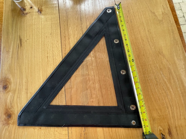

Does anyone have a pattern for the Gypsy Curtains for a 1926-27 Roadster?
I found some good pictures on this forum but not a pattern with dimensions.

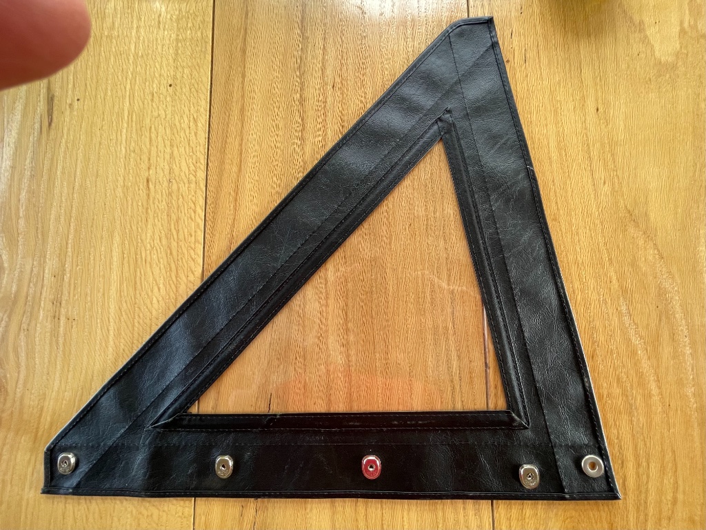

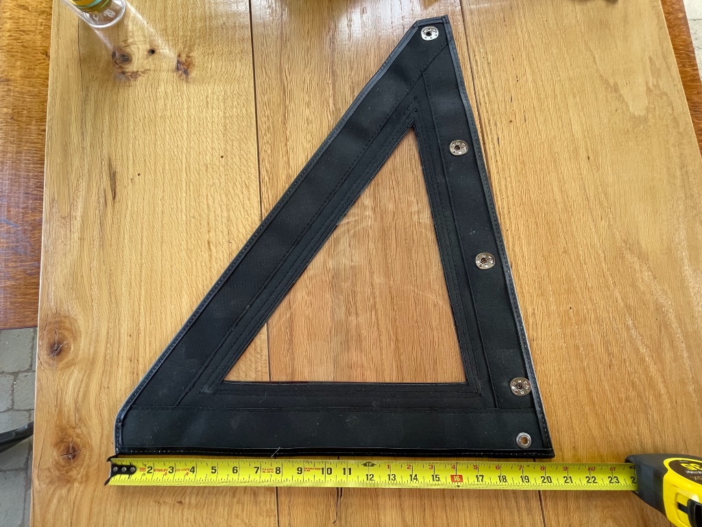

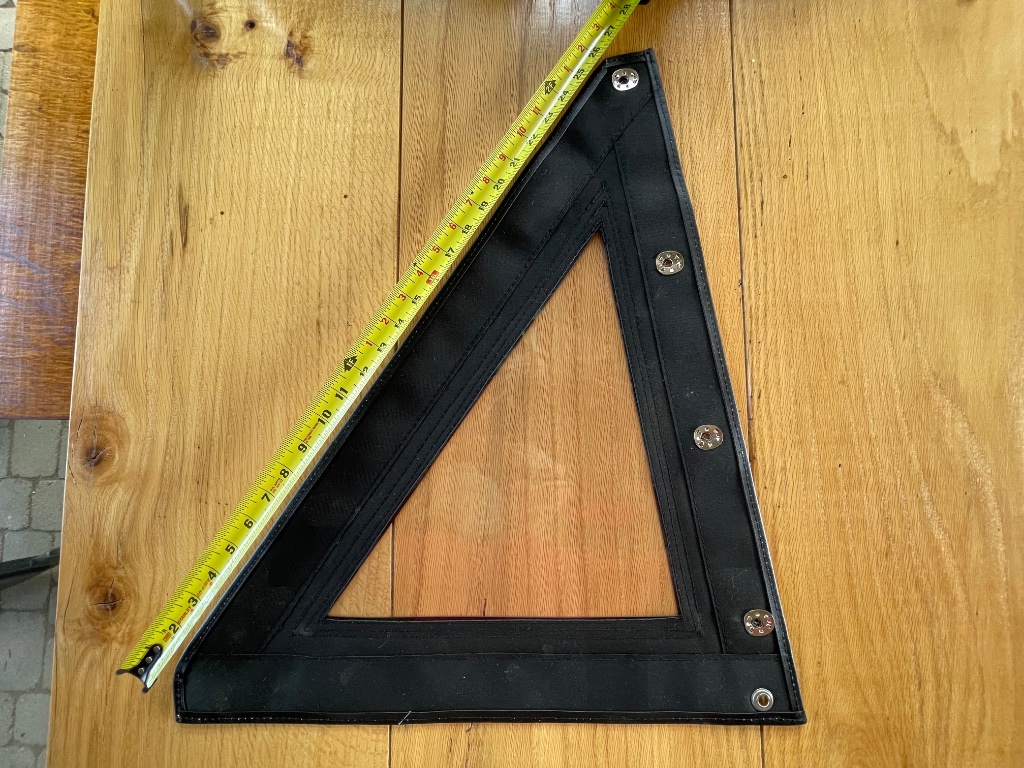

Post by dmdeaton » Sat May 22, 2021 5:21 pm
dmdeaton
Posts: 732
First Name: Danny
Last Name: Deaton

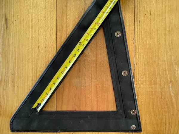

Re: Gypsy Curtain Patterns for a 26-27 Roadster
Post by dmdeaton » Sat May 22, 2021 5:23 pm
dmdeaton
Posts: 732
First Name: Danny
Last Name: Deaton

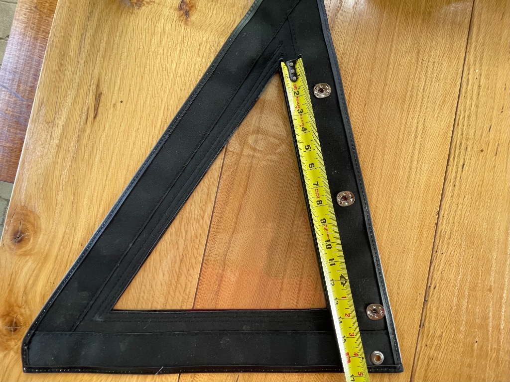

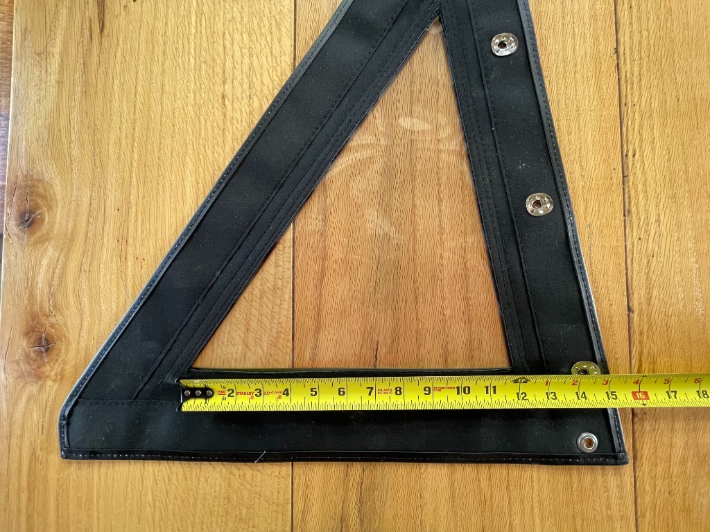

Post by dmdeaton » Sat May 22, 2021 5:25 pm
Let me know if you need anything else. I don’t know much as I just got them and haven’t even held them up to the car yet.
Post by DontKnowMuch » Mon May 31, 2021 11:48 am
Thanks for posting these pictures. I did not see these until this morning. Can you measure one of the angles?? I am very rusty on my geometry.
Dennis

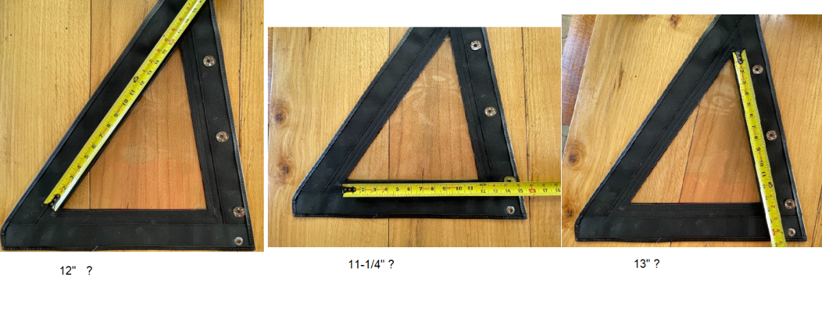

Post by TRDxB2 » Mon May 31, 2021 12:15 pm
Dennis

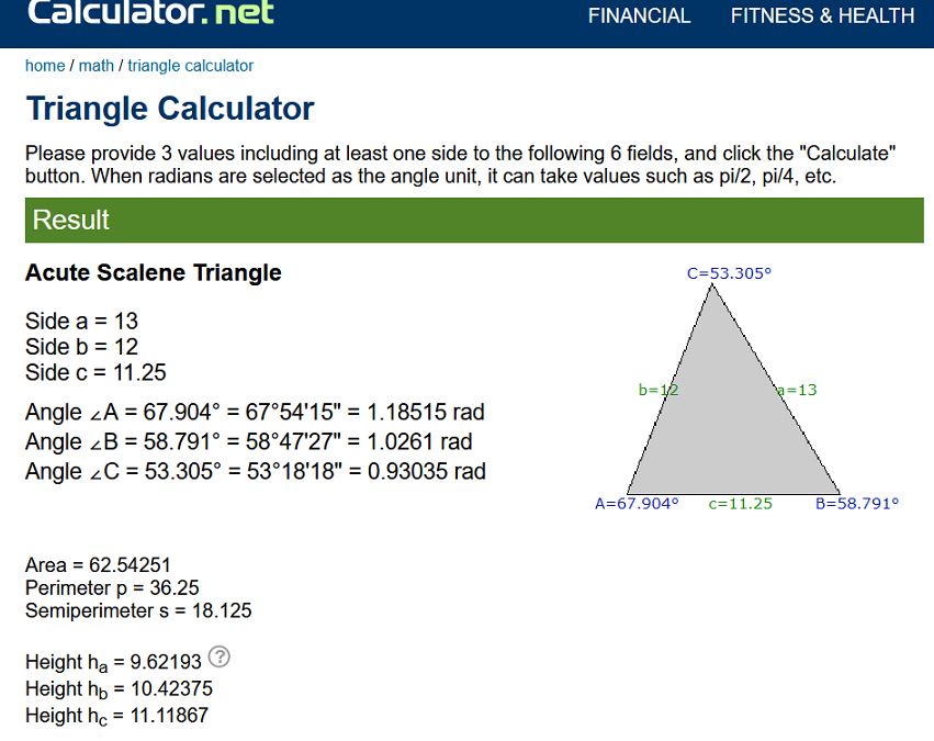

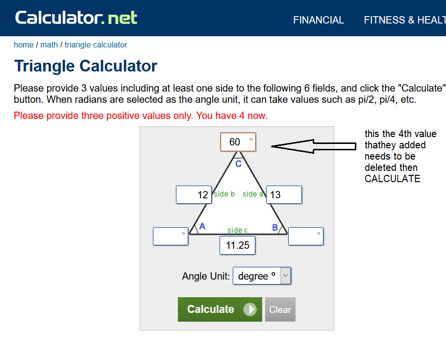

If you get the exact measurements of the inner triangle you can use this link to calculate the angles. Since the width of the each frame piece forms parallel lines the outer triangle would have the same angles. All the pictures with the tape measure need to be more accurate. https://www.calculator.net/triangle-cal ... &x=68&y=23
Here is an example:
