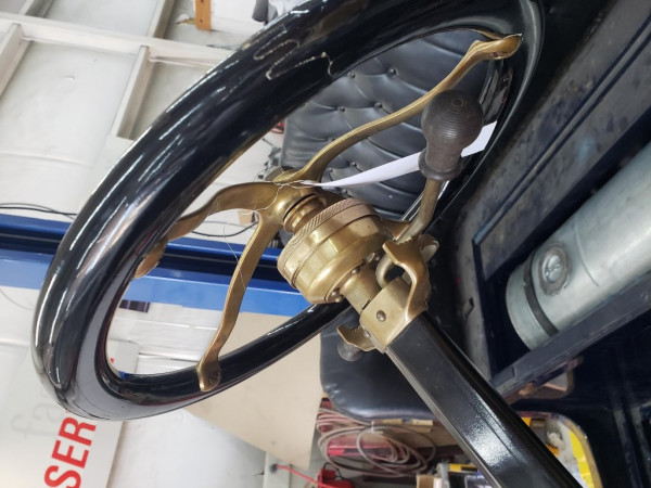

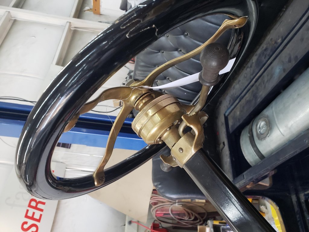

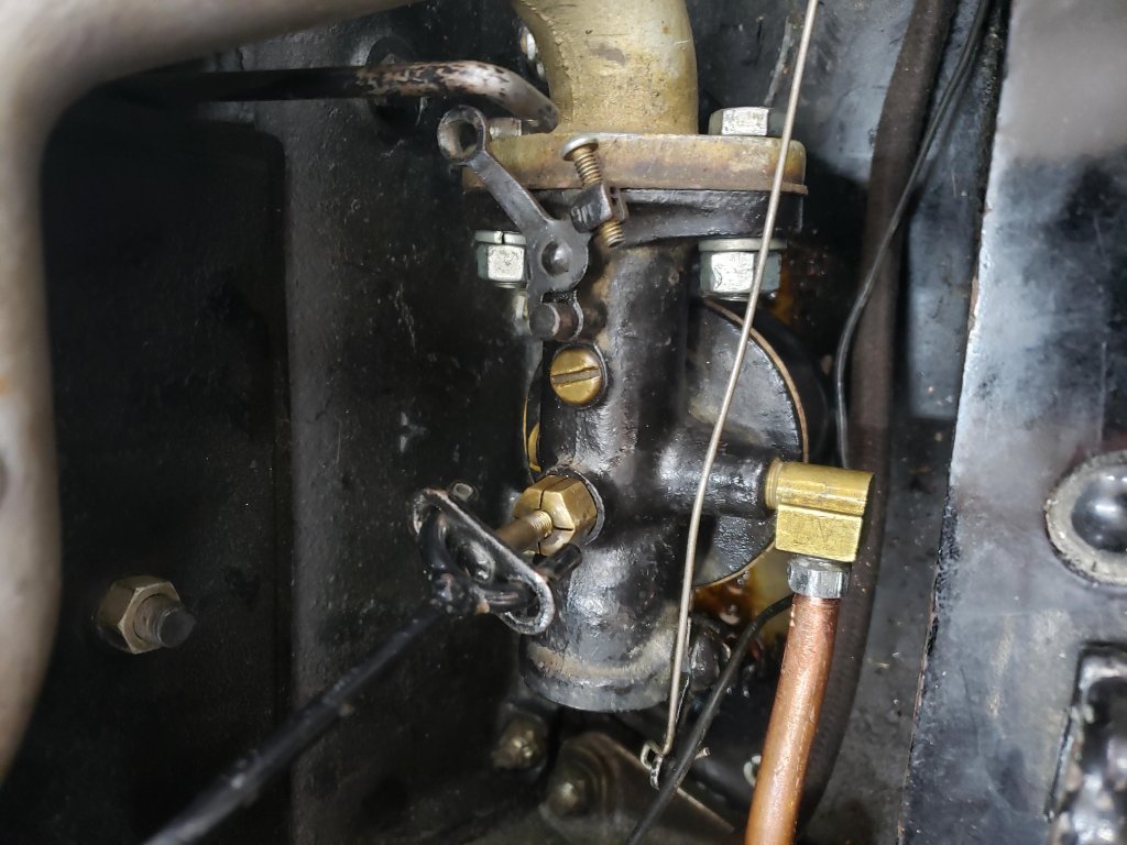

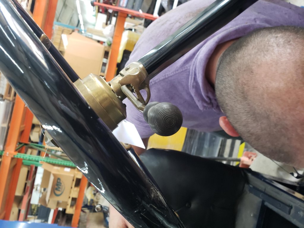

Engine has not been started in a couple of years.
New 12V battery, new fuel tank and sediment bulb, full flowing fuel.
Mixture knob counterclockwise about 7/8 of a turn.
We removed the hot air pipe to make it easier to spray starting fluid.
Carburetor is a Kingston, L-4 I think.
It did start once, and ran for about 4 - 5 seconds, roughly.
Pictures show the settings for the carburetor and the timer.
It did backfire through the carburetor a couple of times, but that got fixed by connecting the spark lever to the steering column!
We're open to suggestions...!
Any help is appreciated.
Thx.

Carbe is L4. Try opening the spray needle more. I don't see a gasket between the carb and intake. Have you checked compression? Full fuel flow, have you opened the drain on the carb and let it flow for more then a few seconds? Are you pre priming the motor with the choke? If so, does it sound like you are pulling fuel in, you should be able to hear it.

Look like the throttle is wide open. Better hope it doesn't fire up like that so hook up the linkage and try again.

You need fuel/air, compression, and spark. It's unlikely that spark would be lost or timing changed just because of sitting. Compression could be lost if a valve or two are stuck open. Fuel is the most likely culprit. Possible problems there include bits of debris in the carb, condensed water in the gas, and a sticking or stuck float valve. Also try starting with adjustment 1¼ turn open. A good starting adjustment varies among carbs.

I agree with Bruce. Why is the carb unhooked ?Bruce Compton wrote: ↑Sun May 16, 2021 10:30 amLook like the throttle is wide open. Better hope it doesn't fire up like that so hook up the linkage and try again.
I would start here, it’s not gonna start with the throttle wide open.
You show the lever but not the actual timer.
Hook the throttle up, open it about 4-5 notches at the column. Open the mixture about 1-1/2 turns from closed. Make sure the timer is set according with the service manual and try it.
If still no joy, check compression, spark, plugs, coils....
