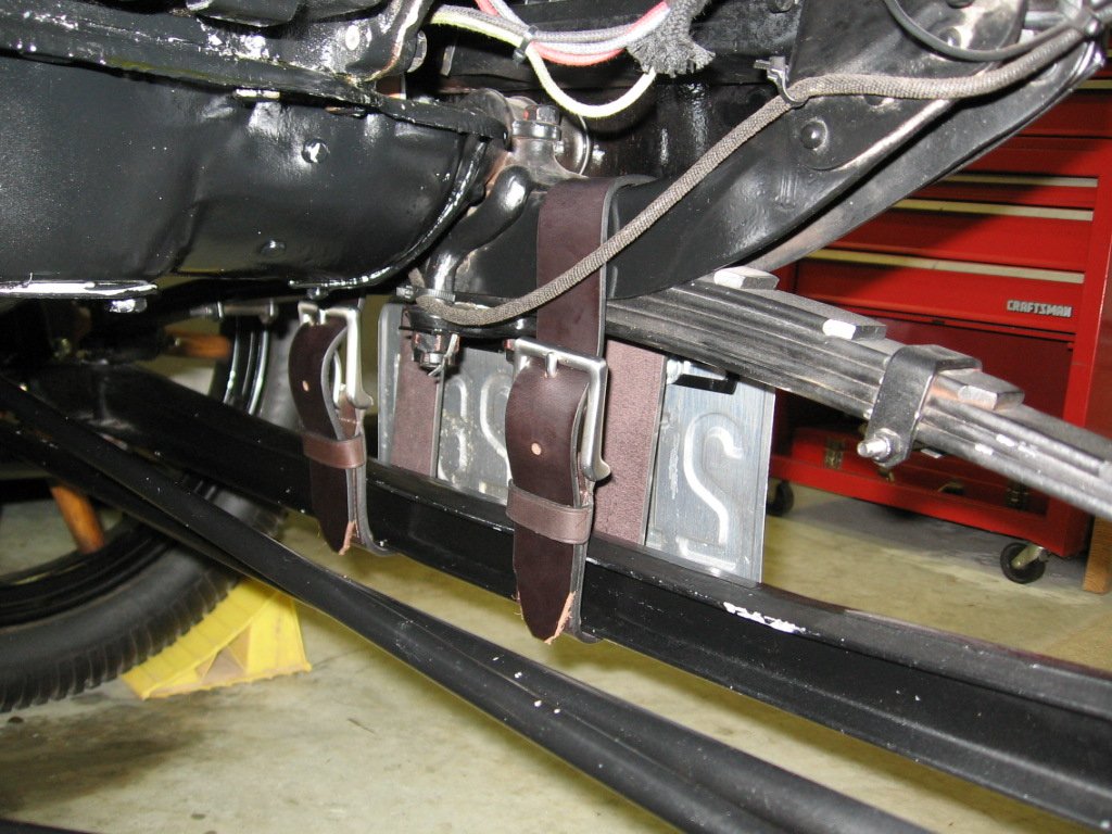

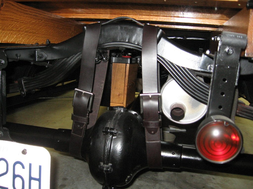

I run rebound straps on the front and rear of my 1924 and consider them a worthwhile improvement. I made them out of the heaviest leather belts I could get at Walmart.

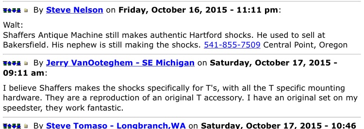

I have a feeling the OP is asking about real shocks. Yes, there are reproduction “Hartford” friction shocks available for the T’s, that cause no interference with accessory brakes or create potential chassis failure points. They simply provide resistance to the free motion of the springs.

Don’t know if they’re still available, but here is a clip from an old thread;
