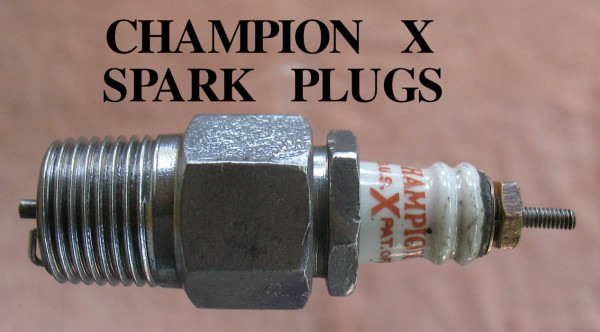

The standard Model T cylinder head was outfitted with 1/2 inch female pipe threads for the spark plugs.
Male pipe threads, as found on standard Model T spark plugs, are tapered, so that the joint becomes better seated and therefore better sealed, as it is tightened.
Because there are scads of spark plugs made that use other thread configurations, most of which are not tapered but use a crushable metal 'gasket' that bottoms out against the head and forms a seal that way, lots of folks have used an adaptor to reduce the hole in the head from half-inch pipe threads to whatever threads are on the plug they want to use. These adaptors are available from the various parts sellers of Model T parts.
It is possible, or even likely, that a cylinder head other than a Model T head, could have any of a number of threads in the spark plug holes, but I wouldn't be able to give you any help on that.
Suffice it to say, if you have an original head on your engine, you're looking at 1/2" pipe threads, and there are many spark plugs available in that configuration. In fact, the Champion Type X plug, which was the norm in Model T times, is still available from your neighborhood parts store, although they may nmot have them in stock - but can order them.

Good response. 1/2" pipe thread is the Model T standard, and the Champion X is my own recommendation, and probably a majority of other T owners. That said, there are a lot of other brands of spark plugs that were produced with that thread, and still are (Motorcraft for example). However-some are better than others (some, a lot worse!). Thousands of different cars were produced that used that thread so it's understandable a lot of plug manufacturers would offer it over the years. As a collector of spark plugs for nearly 50 years, I can tell you that nearly 5000 different brand names have been produced world-wide over the years. That number continues to climb. I'd guess that a large majority of them were available in 1/2 Pipe thread.

...the Champion Type X plug, which was the norm in Model T times, is still available from your neighborhood parts store...
...and will give you sticker shock.
Mister Thrifty would use Autolite 3095 (about $12 a set) or some other modern plug while shopping for some original plugs at swap meets or online. Champion X and other old Model T plugs sometimes turn up on eBay for $10 or less, and I have bought them at meets for $2-$5.
