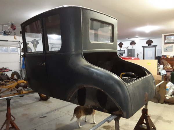

I have talked to a body shop about blast cleaning my 1927 coupe. He is well aware of the potential problems associated with blasting cleaning. I am going take the trunk lid, one of the splash panels, and maybe a fender to him. He will use both walnut chip and sharp glass media, with reduced pressure, as trials. He may also try a combination of both.
I would appreciate comments on this plan. If any of you have had experience with either of these media, that would be helpful.

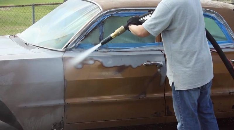

If its the original paint that has been bonded to the metal for the last 95 years why remove it all? W ill you get a better bond than that? The word on the street to remove paint off a car is Soda Blasting as shown in the picture above. Sure he knows that if the blasting method heats up the metal it will distort it. If you insist, start with the part least likely to distort.BLB27 wrote: ↑Fri May 28, 2021 9:10 pmI have talked to a body shop about blast cleaning my 1927 coupe. He is well aware of the potential problems associated with blasting cleaning. I am going take the trunk lid, one of the splash panels, and maybe a fender to him. He will use both walnut chip and sharp glass media, with reduced pressure, as trials. He may also try a combination of both.

Dustless blasting is definitely the way to go. Used it, and would do it again. Preservative lasts for a couple months if you keep it dry. Then use a self etching primer to seal the bare metal.ThreePedalTapDancer wrote: ↑Fri May 28, 2021 10:52 pmhttps://ttdustlessblasting.webstarts.com/
Dustless blasting at your property. Uses water mixed with sand, no heat or warping. The liquid has rust prevention too.
If you just dry blast it, you will be hurrying to get it primed before they humidity starts rusting it immediately.
