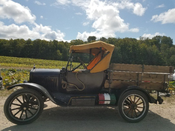

Re: HELP! How to replace 1925 turtle deck with a 1925 pickup bed
That's how I did mine, yes. Unbolted the turtle deck, bolted ash 2x4 or better, from side to side, then ran 1" ash deck boards front to back, and lag bolted to the 2x4 'slats'. Hi would have to really dig for some in-progress photos of it, as that was several phones ago!

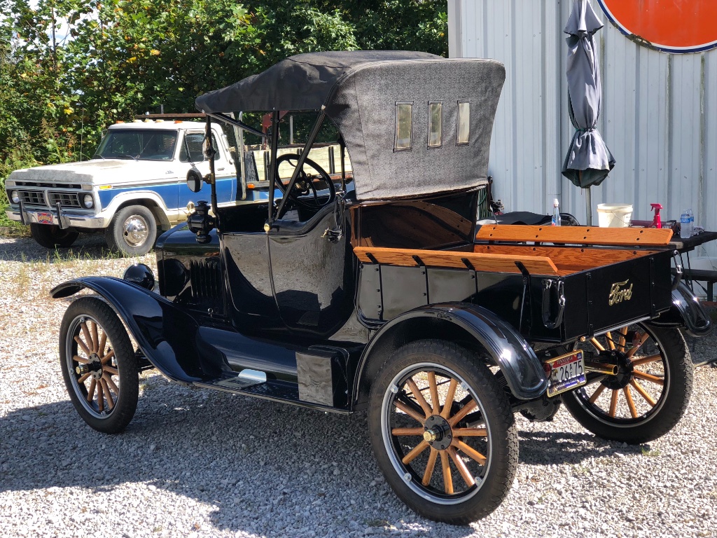

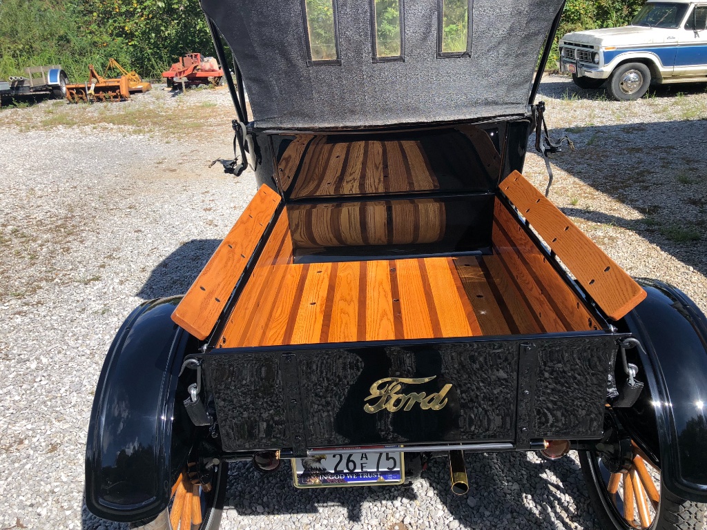

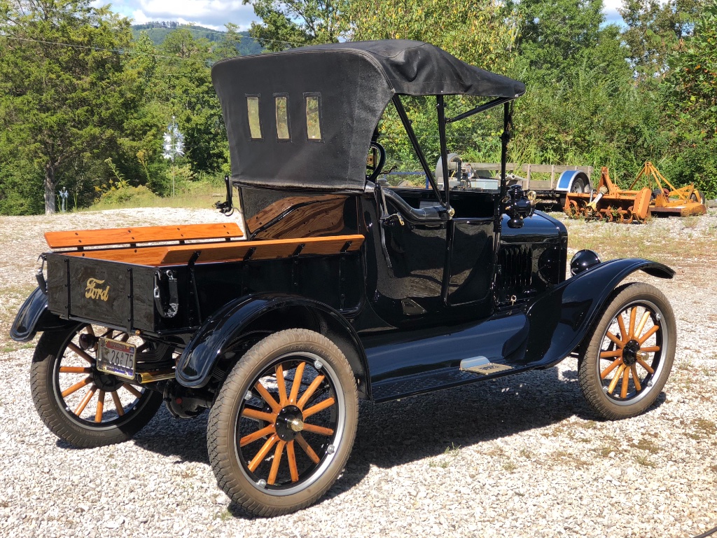

In a few hours I will let you know exactly how the factory bed is mounted on my 25. Will try to take pictures.
Remove the turtle deck, should be one bolt on each interior corner. The box should have flanges to lower over the edge of the deck platform, Should be 4 bolts spread along each side flange, back 2 are rear body mount bolts. should be a cross brace that buts against the rear of the platform, Only the rear 3 rows of the bolts are exposed that hold the metal strips between the wood bed. All the rest of these bolts are drilled thru the deck platform and are bolted thru the deck.
Henry very nicely done really beautiful & the lines are crisp. You must know someone that has a lot of metal experience ha.

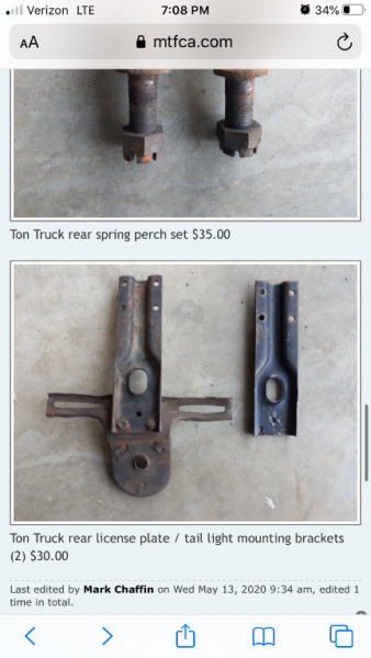

In addition to the fender mount change you will need a commercial type taillight bracket to mount your taillight under the pickup bed. If you have demountable wheels you will need to decide where to mount your spare, under bed, at driver's side fake door ( USA ), or in bed.
This is the bracket you need. It will attach on the cross bracket bottom of bed that runs against the body. Believe it was attached by riveting.I used a different light then the 26 light that is shown. Bed should attach to body by 3 bolt holes along same body line below roadster deck. I don’t have pictures of mine but could take some if needed
David how hard are those mounting brackets to find?
Afrazer
- Posts: 146
- Joined: Sun Jan 06, 2019 4:55 pm
- First Name: David
- Last Name: Frazer
- * REQUIRED* Type and Year of Model Ts owned: 1925 closed cab TT. 1925 factory roadster pickup. 1926 two door sedan
- Location: McPherson ks
They were used on ton trucks and the roadster pickups. So they come up every now and then. I purchased a reproduction from a vender.

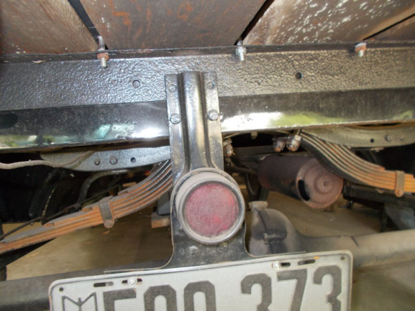

Would someone please take a picture of the taillight mounted on the pickup
Lets see if this works
Now I get it, thanks Jim for the pictures
