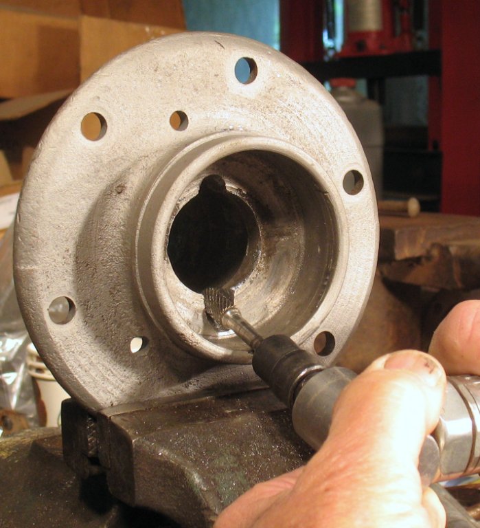

Lorien, when you do get it out, don't be afraid to take a die grinder and make a couple of grooves inside the hub like the later hubs have. That will let you drive out any subsequently fitted cones.
Here's what Allan referred to.
