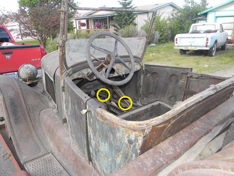

"Wider" front body mount used on the Improved Car chassis, you will need one for each side to mount the body subframe attachments.

Been a while since I had my ‘27 roadster... but seems to me that mounting bracket circled in the pic above simply supports the hood sill plate and/or hood latch...?
As for the coil box... yur going to have a he// of a time fitting it and the fuel tank under there

The 26-7 frame is deeper where the steering lower bearing mounts and the holes are located differently. So mounting the 26-7 steering column to a earlier frame is NOT a direct bolt in. Certainly solvable but some work will be involved!!

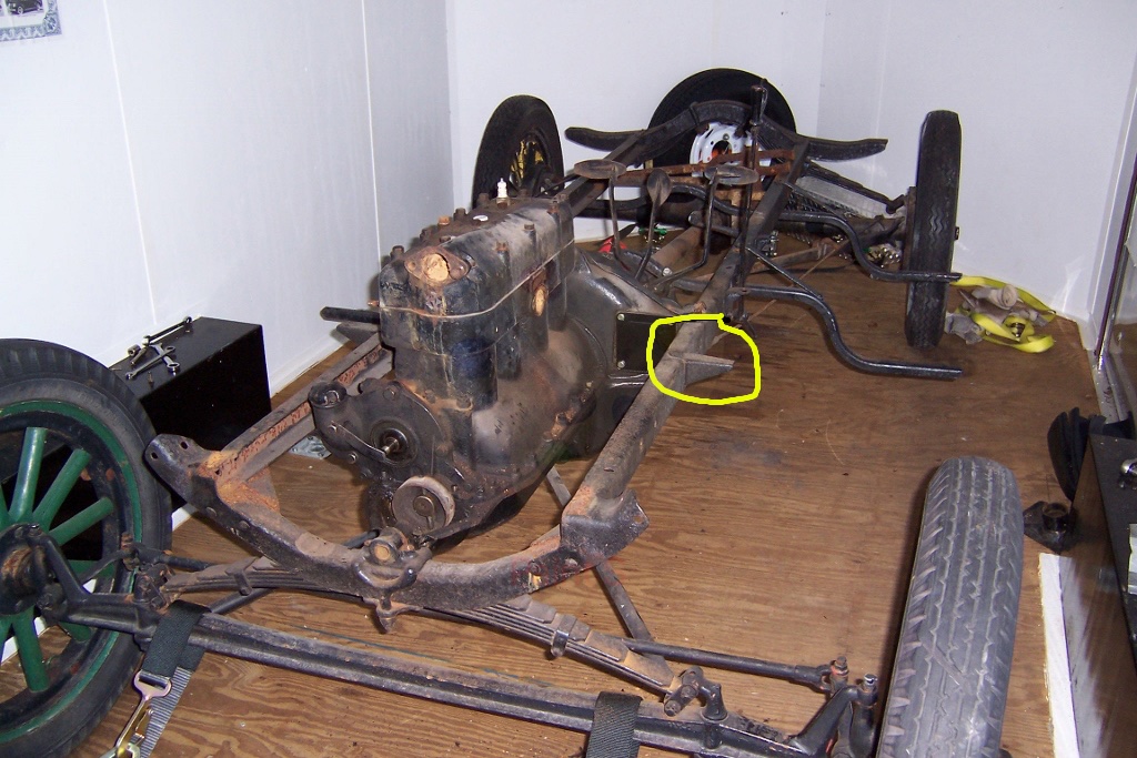

So let's take these copies of your pics:
220193 (2) copy 2.jpg (86.15 KiB) Viewed 11372 times

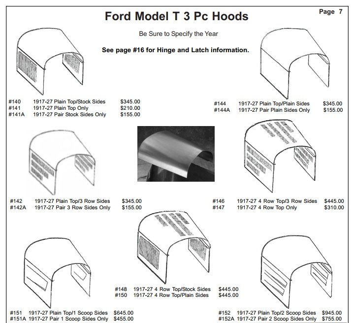

When you say "the 'wider' mount up front is for the hood clasp", I assume you are referring to the "circled green" in the car photo, not the diagram?
The "circled green" in the diagram is for mounting the front of the front fenders?
Then you say "those mounts are needed for the hood shelf so that the wider hood will mate with the cowl". You mean the rear of the hood, correct?
So if I have this right, the "improved" cowl where it mates up to the hood is still wider at that point than the '24-'25? But the radiators for the '24-'27 are all the same width?
If that is so, why does Rootlieb.com's catalog show all the same size hoods for '17-'27?:
Tom

Tom, the wider brackets at the front frame crossmember that you marked in green are for the 26-27 front fender brace. The 26-27 radiator width is the same as earlier radiators. The 26-27 firewall/cowel is wider than earlier t's so the 26-27 hood is different from the earlier ones. The Rootlib catalog page you posted are hot rod 3 piece hoods, not stock 4 piece hoods. The earlier hood will not for the 26-27 body. You are over thinking this and have received some conflicting advice.

As Jeff posted you won't need the front bracket unless you put on 26-27 front fenders.

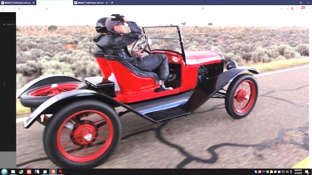

Assume you are trying to build this one:
The owner used the Improved Open car body cowl, and likely has coil box on motor as there is no gas tank on the rear so this one uses the cowl tank. If you are going to put a gas tank on the rear, elevate it for gravity feed. Motor mount coil box is best design with sealed lid, or if using other than Ford ignition, that's left off anyway :?
Fenders are Rootleib speedster mounted directly to the frame rail. No hood shelves needed as no hood sides. The hood is two piece hinged upper original Ford, high radiator needed to match hood contour to the cowl/firewall.

PS. Yes, whoops on the Rootlieb page :)

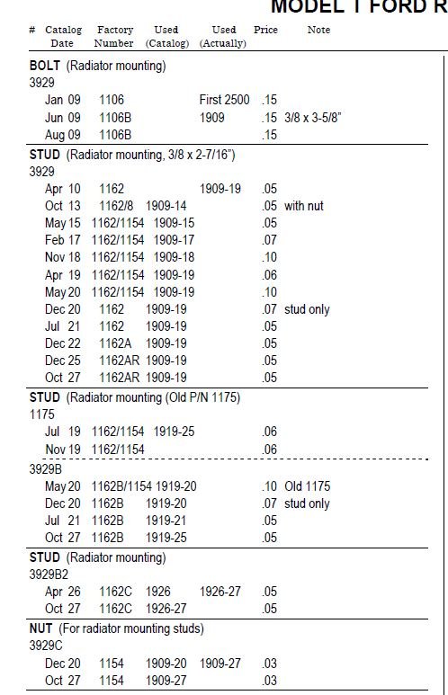

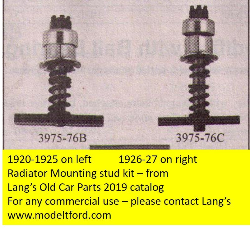

I had typed this up but then closed the internet connection, so it all went away. So this time I’m using my word-processor and it will be shorter.

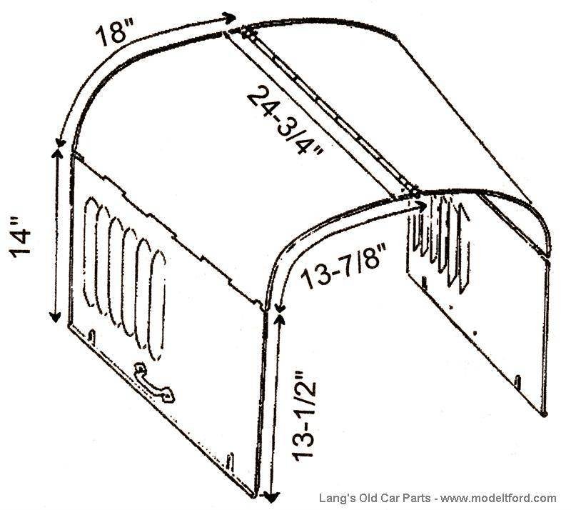

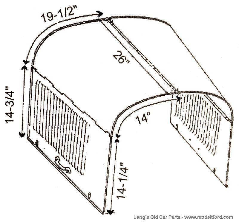

Summary – it is usually easier to fit the 1915-1925 parts to the 1915-1925 frame and the 1926-27 parts to the 1926-27 frame. The other can be done – but you will run into several areas that will need to be modified to make it work.
One of those areas will be the steering column. The 1926-27 cars (with the exception of the Fordor Sedan). For all but the Fordor sedan the steering column was lowered 3 inches (ref page 383 of Bruce McCalley’s book “Model T Ford.” If you mount the cowl area from the a 1926-27 open car on a 1926-27 chassis – it will all line up correctly. If you use the 1915-1925 style frame (actually 1909-1925) then you will need to figure out the combination to make it work successfully.
Please see the following postings for a discussion of that:
http://www.mtfca.com/discus/messages/29/24786.html
See the posting below illustrates what happens when you have the incorrect lower steering bracket for a given body style and year. In this case a 1926-27 Fordor lower steering bracket on a 1926-27 open car body.
http://www.mtfca.com/discus/messages/59 ... 1464229856
Note in addition to having the angle of the steering column look nice and fit the dash and frame nicely – you also want to make sure you have the compatible parts in good shape so the steering will NOT go over center.
http://www.mtfca.com/discus/messages/506218/572556.html
Note Royce had an excellent posting on the length of the drag length and tie-rod and the importance of using the correct parts on the cars of different years. At the moment I cannot locate the link for that thread. Again, in general if you use the parts for the year range you have it works not only easier -- but in this case safer.
Additionally, a stock 1926-27 car frame & chassis will give you a 1 ½ inch lower speedster than a stock 1915-1925 chassis. Ref: http://www.mtfca.com/encyclo/1926-27H.htm
“The “improved” Fords were lower in height than the previous models. This height reduction was accomplished by not only reducing the height of the bodies themselves (except for the Fordor) but also by lowering the frame by a redesign of the front spindles, and a reduction of the crown in the front spring. The rear cross-member had a deeper curve which lowered the chassis somewhat as well. These modifications lowered the chassis height one and one-half inches.”
And below are from Lang's showing the dimensions on the 1924-25 car hood verses the 1926-27 car hood. (Note Lang's uses 1923-1925 -- but the early 1923 cars actually used the same size hood as the 1917-early 1923 cars. The handles were no longer riveted to the hood starting in 1920 but instead were fastened to the hood without a separate rivet -- causing a "hole: to appear where the rivet was on the earlier hoods. (Ref: page 235 of Bruce McCalley's book "Model T Ford.") Note Lang's also sells just the one-piece top hoods for speedsters.
Their part number for the 1924-25 car hood NO114
For the the 1926-27 car hood NO116
For the 1924-25 one piece top NO141-23-25
For the 1926-27 one piece top NO141-26-27
Good luck with your speedster!

Rather than just guessing and possibly giving Tom the wrong answer, I thought I would add his question here. In an e-mail he asked, " ...about the front (radiator side) measurements for
those 2 hoods. Why is the radiator side on the '24-'25 13 1/2" vs the
'26-'27 14 1/4" when both can use the same radiator?"
Note he is asking about the front of the hood which is 3/4 inches longer on the side panel than the 1924-25 hood. And the top front of the hood is also 1/8 inches longer. [Side note the rear panel edge is also 3/4 inch longer -- but that one should be due to the larger cowl on the 1926-27 cars].
Reposted from above -- from Lang's catalog:
1924-1925 car hood and 1924-27 Ton Truck
1926-27 car hood
1926-27 car hood
Tom correctly points out the the 1924-1927 cars use the same radiator. And the nickle radiator shell is listed in the Price List of Parts from 1925-1927 as the same part number.
So far the only item I have found that is listed differently is the stud that the radiator mounts to. A scan from Bruce's Comprehensive Encyclopedia is shown below. For any commercial use -- please contact Barbara McCalley or to order a copy of the excellent 2 CD disc material see the posting at: http://www.mtfca.com/discus/messages/822076/844722.html
Bruce McCalley - Price List of Parts
You can see that the 1926-27 stud has a different part number 3929B2 and Factory Number (Drawing number) 1162C than the 1920-1925 stud which has part number 3929B and Factory Number 1162B.
Unfortunately the length of the stud is NOT listed. However in Lang's Old Car Parts 2019 catalog they have the illustration shown below:
"IF" the photo shows the two studs at the approximate scale, then perhaps that extra length on the hood is due in part to the extra height the radiator is mounted?
But I don't have an "Improved Car" to check out that theory/guess. So if someone who has both a 1924-25 and a 1926-27 could check why the hood panel is 3/4 inch longer in the front that would be greatly appreciated. Or if someone knows the answer and doesn't have one of those cars to compare -- that would be great also.
Note -- "IF" it is the radiator studs that cause all or most of that 3/4 difference -- then using the 1920-25 studs to mount a radiator on a 1926-27 car may throw the hood alignment off. Again -- this would be another time when using the parts from the same year range usually makes assembling the car easier.
Respectfully submitted,
Hap l9l5 cut off
Hap l9l5 cut off
