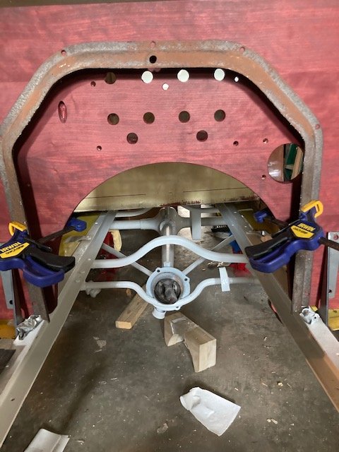

Where do Hood Former Legs Land?
Hi, I am fitting the firewall and hood former. Where should the 'legs' of the hood former align with the frame? I can widen the hood former legs or compress the legs some. What is the correct position? Also how high off the frame should the hood former be to accommodate the engine mounts sliding underneath?

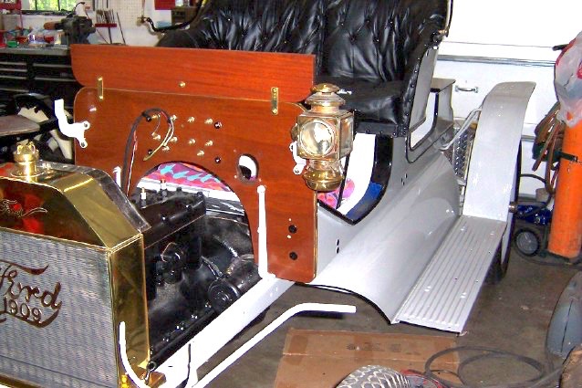

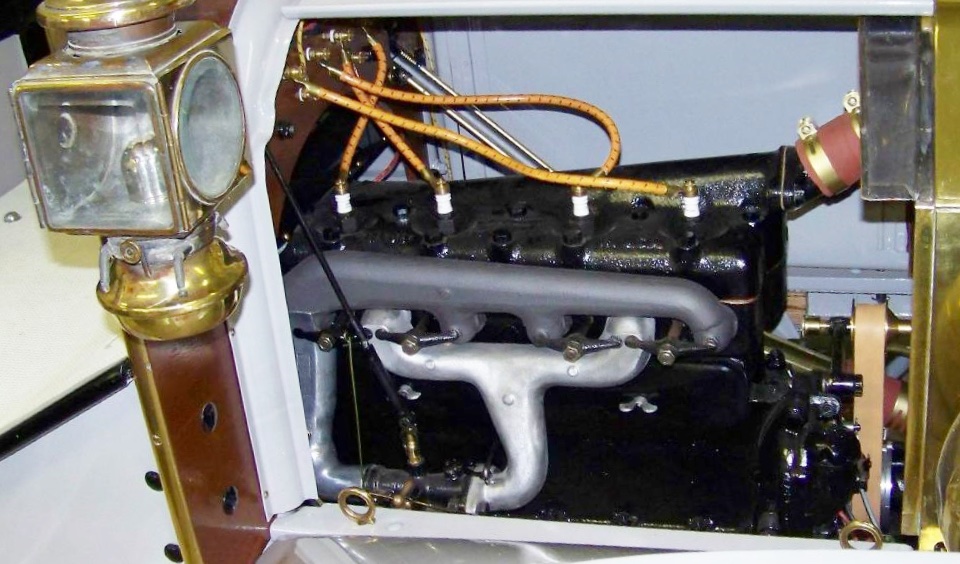

- Posts: 4047
Re: Where do Hood Former Legs Land?
Since you are building a speedster, correct factory isn't needed. IMO, mount and screw on that hood former last.
Use the tall brackets for the wood firewall, you can notch the lower inboard edges of the firewall for clearance of the crankcase arms. Also if you are adding starter, make the starter side with a larger notch.
You'll find the body building easier with the engine in the chassis, and chassis up on wheels. The firewall determines the front body parts too.
Then when the body and firewall come together, best to do test fits of all before final assembly.
Engine in and more fitting.
Finally, fit the hood former, as it will ride above the wooden hood shelves anyway, plus you can align the former to the radiator to be sure the hood fits correctly.

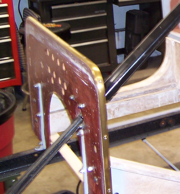

Note , in your firewall pix, there is no notch to clear the pan ears.
There would be no point to it. The early F/W brackets mount on top of the frame. Cant slide the ears on the frame without removing the firewall. The ears sit far enough behind the firewall to not interfere with it.
Or am I missing something?
Its unfortunate that later F/W brackets cant be used if sliding the engine and starter in & out was the goal. (Which i would prefer on a speedster.) Per the first pix, The later F/W brackets would interfere with the hood former. Those early F/W brackets Will get in the way for removing the starter as shown in pix 3 Thats a trade off.

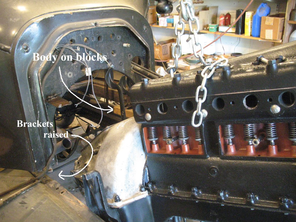

Correct. When removing the engine from my 1915 I unbolt the brackets from the frame, remove the front four body-to-frame bolts, and set the body up on a pair of 2 x 4 blocks. That leaves plenty of room for the pan ears to slide out, and I don't have to remove the firewall from the body.
You’re correct on removal of engine requires the dash brackets to be un-bolted and body lifted, forgot that.
Only the side mount brackets allow without removal, but notching of the fire wall does help removing a starter on early firewall. Just hard to see in my photo, but right at the inner edge of the bracket is a notch cut in the lower end of the firewall. That helps the upper corner of the starter housing to clear the firewall.
