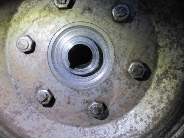

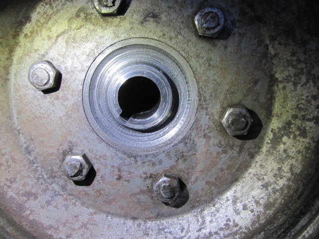

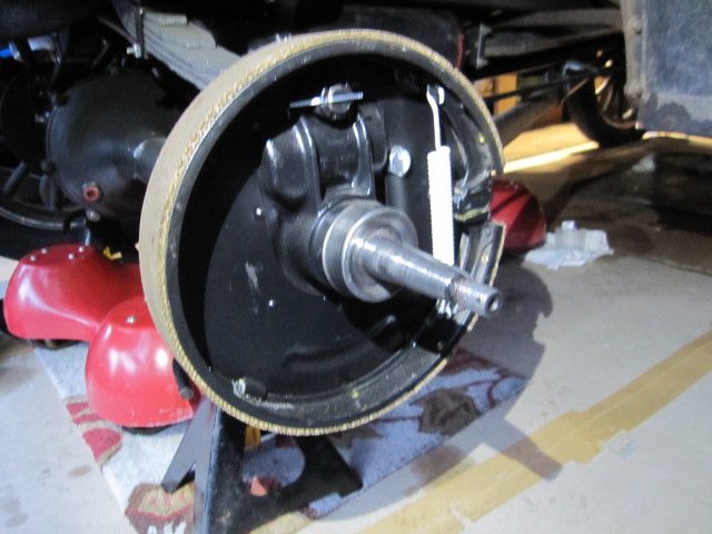

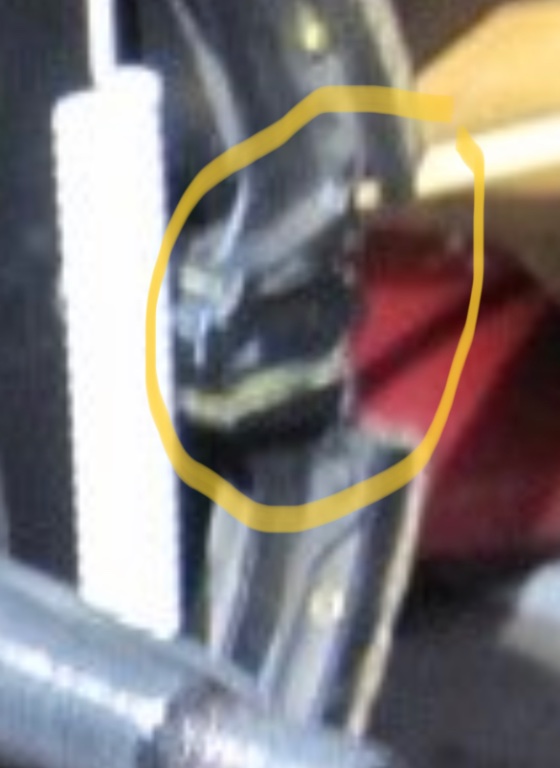

Things have been working good with adjustments to the new bands and proper link angle, very little oil weeping around the hogs head and pedal shafts with the new gaskets.
So after another good long ride breaking in the new bands I went around and tightened the split rims to the wheels and noticed the right rear drum was a lot hotter than the left drum that was just warm to the touch. I assume is more normal after a good long drive.
The pictured inside drum and wear on the lower part of the outer seal between 6 & 9 O'clock is what i found. Seems the outer seal is rubbing on the inside of the hub and thinking I need to use axle shims to bring the drums outward, hoping the hub taper is not excessively worn. Any input would be great.

I believe your axle seal was not installed completely. I think it should have been pressed on the axle housing further. But now, it must be removed and straightened or replaced.

Either the seal and cover are too far out, or the drum goes too far on...or both
Neither can be truly accurately determined until you show us a picture of the wheel mounted back on the axle and show the relative position of the brake drum to the backing plate. A simple, close picture taken from the rear will do. From that, a definitive answer can be given, as there is a correct/designed relationship between the two.
telling us if there is an inner neoprene seal inside the axle, behind the sleeve would be important to know, too.

You may have issue with worn hub or axle.

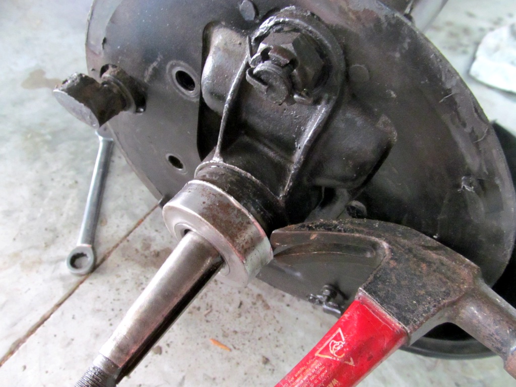

But first try to see if the seal cup can be tapped farther on the axle housing flange, to get more clearance. If the felt washer was placed dry, that can keep the seal cup from fully seating. The felts need to be rubbed with grease to thin them down and to provide better seal from seeping oil.

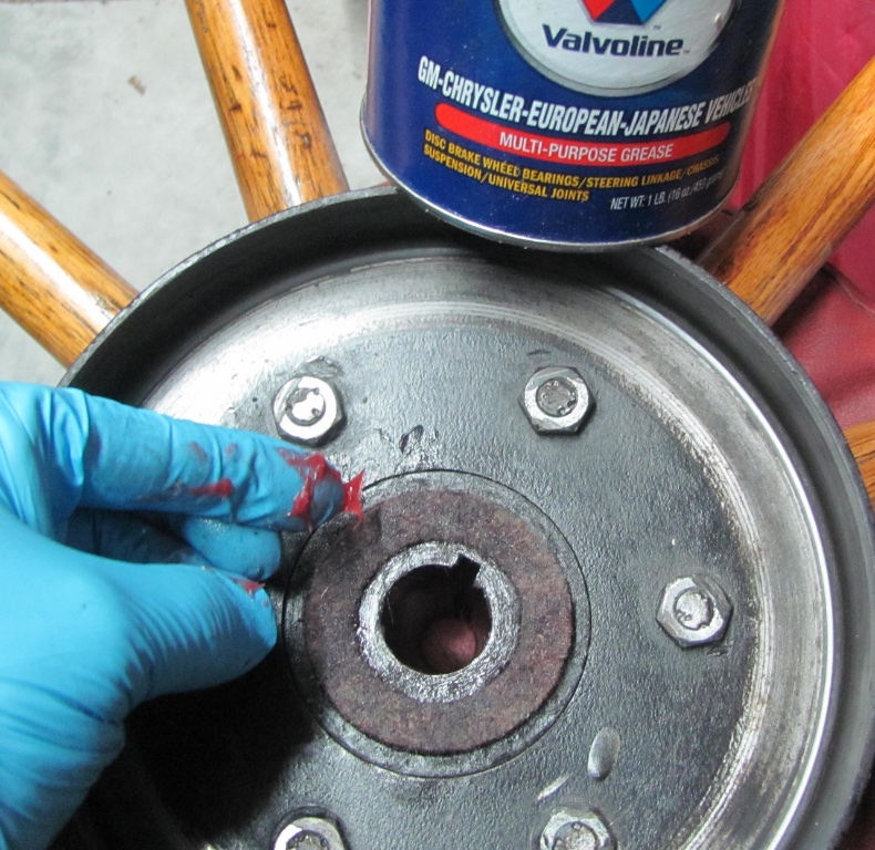

Plus on the drum hub, you can install the hub felt that is designed to fit into the hub groove. That felt is also crimped down with grease and that felt helps prevent metal contact as it lubes the seal cap cover and also prevents seepage to the brake shoes.

I'm thinking (dangerous !) that it appears the dust cap isn't seated against the housing.

I'm with Pat. That small area of contact with the seal cap is not likely to have contributed much to the heat of the brake drum. I'd be looking at brake adjustment for a slightly dragging shoe.
The seal cap does appear to e well short of completely seated on the axle housing, and tapping it further on would alleviate the contact at that point.

Pat & Allen are correct. Soak the the felt seal with grease. I actually warm the grease to a more liquid state and really drown the felt in it. Use your hands to help it penetrates the felt. When this is done it will actually be able to be reduced in thickness. That said, I believe your new brake lining is causing the heat. The brake ring may actually be sprung and not seating tighter into the clips causing steady friction thus heat. Though it may be an optical illusion, look at the upper brake boss where it meets the cam, the top boss is sprung out & not seating as low as the bottom boss. I’d also straighten the cap and seat it with a large socket for better conformity.

I had very similar scrap marks on the dust cover and drum. A member here advised a 3# hammer, that along with a block of wood set them properly. I have to agree its doubtful just that caused the heat but you never know. Hard to see in the images but linings look ok. Set the dust covers and take it for a ride.

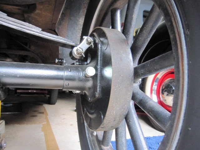

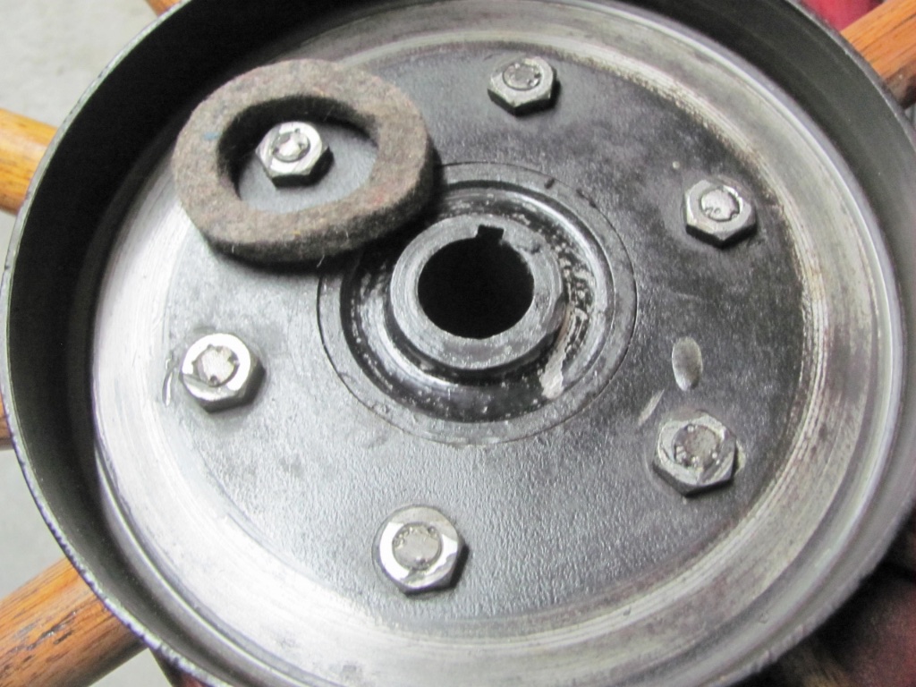

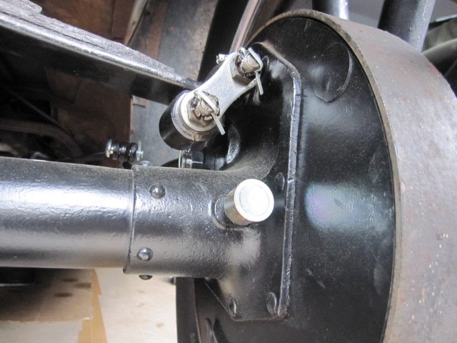

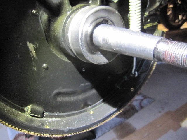

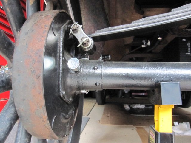

Some pictures of the Right rear back on and the left rear. Great thoughts on this subject, was suggested by Steve @ Langs to shade the inside of the drum with a sharpie and see were contact shows up. As mentioned probably the outer brake lining edges rubbing and heating things up.
I did check the clevis rods and both adjusted to operate the brake cam equally. I referenced brake drum service, adjustment by Restoring a Ruckstell by Milt Webb main text pages 46 &47.
Thanks again for the help on this matter, it means a lot. Will order a new felt/cap set and start from scratch.

Nice fit on the rear drums but there seems to be a real problem. No grease or oil anywhere. You might want to check your rear axle pumpkin.

The improved Ford guys will know, but if that was pre-26, the drums would be too far on the axle. When new, the drums only came up to, not over the backing plate. Perhaps that changed in '26...
Good of you to make the effort of the photo as now you'll get accurate advice for the issue you're dealing with. Myself, I still believe it is a combination of worn hub sliding too far onto the axle, and the neoprene inner boot holding your roller sleeve from seating fully...I bet if you take the cover, washer, and felt off, you'll see the split sleeve sticking out about an eighth of an inch. If so, this will keep the cover from going on fully. It is almost always a combination of those two issues.

Drums do over hang the backing plates a bit. Sometimes switching wheels from one side to the other will get you the best match of axle & hub wear for the best clearances.
Looks like new E-brake lining. Maybe a little grinding on the outer sharp edge to match the drum radius will be enough to make the clearance you need if its not rubbing the metal part of the shoe.
As S.C. said, make sure bearing sleeve is flush or less to the housing end.
The outer felt seal cups need a lot of push to set home. I use an old transmission brake drum shaft & a 3# hammer. Dont be shy with that hammer.
I dont like shims as a permanent fix. Everyone I have taken apart has migrated in to cut the seal & cause a leak.

The drums may be slightly deep but I’m not sure, 26/7 backing plates had a punch out on them so any material or liquid would drain out. I don’t think that would have been done if the drums were not suppose to be flush but I may be wrong. My 27 roadster, 26 Tudor , 26 Fordoor all had similar looking drum positions as you pictured. What I do know that when I replaced the brake linings on one of the cars I had to sand the linings a bit to give the drum some relief after making sure the brake was not sprung and tight into the clips on the backing plate. Simple way to check that is once the wheel is back on, jack that side up, with the brake lever disengaged turn the wheel an feel for drag. Lang’s gave you some great advice using the marker. I used Prussian Blue.
