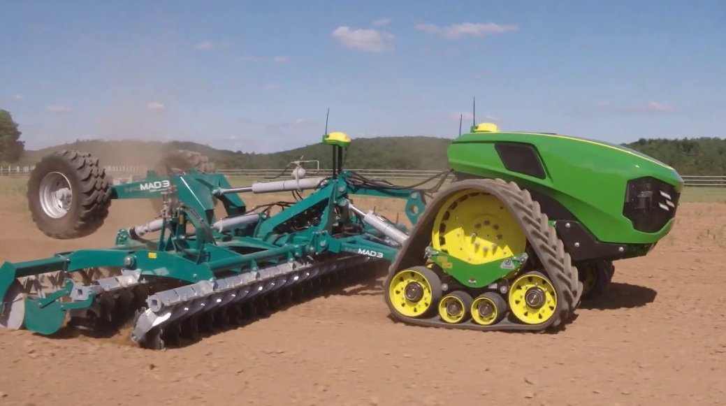

No joke - because it will not be long for them switching to autonomous tracked electric tractors (experimental prototype below). https://www.youtube.com/watch?v=TzRSzu15CLk
A natural for Farmers with leased land for windmills or his own over the cost of fuel. Concept would allow a swarm (multiple tractors fielded at a time). Combines next..... JD has had technology to map & measure soil conditions, seed spacing, yield etc, the fields are already mapped. The antenna devices on top of the prototype are the same devices that have been used in Precision Farming. https://www.deere.com/en/technology-pro ... lsrc=aw.ds
More tech - "See & Spray" targeting and spraying only weeds on fallow ground. https://www.deere.com/en/our-company/ne ... ay-select/

I'm impressed with the electronic autonomous JD tractor above; now if the Deere engineers could just come up with a gas gauge that works for my E-140, I'd be really impressed!

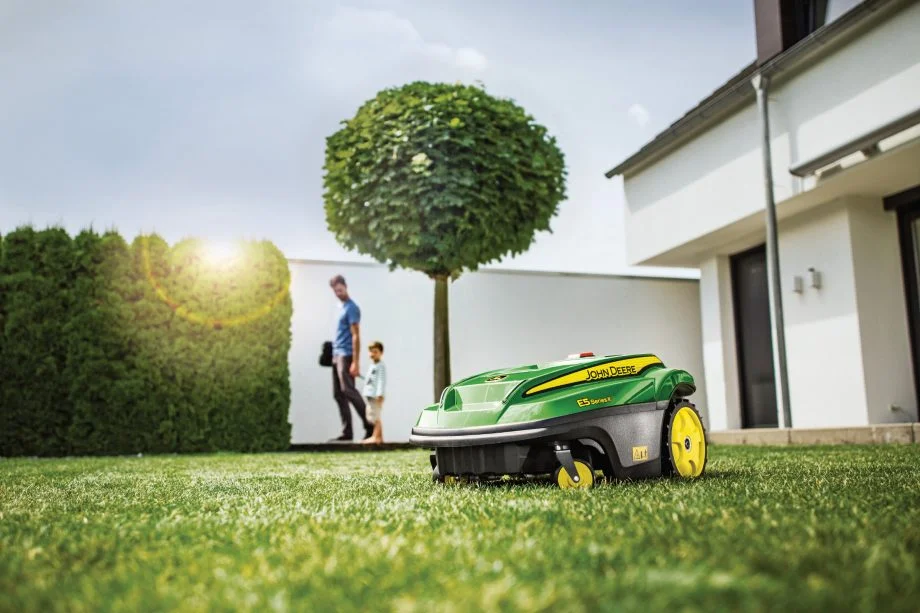

Maybe they put work on it aside , because you may not need it in your next purchase.John Codman wrote: ↑Sat Jun 12, 2021 12:00 pmI'm impressed with the electronic autonomous JD tractor above; now if the Deere engineers could just come up with a gas gauge that works for my E-140, I'd be really impressed!

The last JD lawn tractor that we owned lasted 18 years and all it needed when I gave it away was a starter. I had been looking at new JD lawn tractors anyhoo. If this one lasts as long, I will be watching the hired help cut the grass, or I will be looking at the grass from the wrong side. The 2003 L-120 had a far better gas gauge, but just about everything else on the new E-140 is as good or better.TRDxB2 wrote: ↑Sat Jun 12, 2021 1:08 pmMaybe they put work on it aside , because you may not need it in your next purchase.John Codman wrote: ↑Sat Jun 12, 2021 12:00 pmI'm impressed with the electronic autonomous JD tractor above; now if the Deere engineers could just come up with a gas gauge that works for my E-140, I'd be really impressed!![]()
I sure hope that they put work on the gas gauge aside, because if the present gauge system represents JD's best efforts, they need some new engineers.
- Posts: 6577
Re: Modern distributor or T timer
JD is a very progressive Company, that is why they have become The Major Brand. I suspect that electric lawn & garden tractors are in development since that is the direction the market is headed and a much more convenient set-up for home owners. If all you need is something to cut-the grass. Take a look below. Don't know much about it and doesn't appear to be available in the USA, but popular in Europe. I would suspect that that the issues raised in this article are being addressed given the number of electric powered mowers hitting the market (this was introduced in 2012 or so I think). I have no insider info on product development anymore - was in the Parts Division, then Corporate IT and just about everyone I ever knew retired several years ago. https://www.trustedreviews.com/reviews/ ... -series-iiJohn Codman wrote: ↑Sat Jun 12, 2021 1:51 pmThe last JD lawn tractor that we owned lasted 18 years and all it needed when I gave it away was a starter. I had been looking at new JD lawn tractors anyhoo. If this one lasts as long, I will be watching the hired help cut the grass, or I will be looking at the grass from the wrong side. The 2003 L-120 had a far better gas gauge, but just about everything else on the new E-140 is as good or better.TRDxB2 wrote: ↑Sat Jun 12, 2021 1:08 pmMaybe they put work on it aside , because you may not need it in your next purchase.John Codman wrote: ↑Sat Jun 12, 2021 12:00 pmI'm impressed with the electronic autonomous JD tractor above; now if the Deere engineers could just come up with a gas gauge that works for my E-140, I'd be really impressed!![]()
