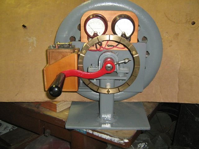

But then, I share ownership of an old fashioned HCCT that I found on the forum several years ago. It works for us. Our whole club is free to use it of course.
You may be able to find someone to check it on theirs maybe for a small fee, rather than putting out all the expense for so few times you will use it. Mike is cringing at me now!!

Tim, If they start lining up to much at Mike's send them over to me. I have that home built one that I made. Jim

There is NO comparison between a HCCT & the ECCT tester in the quality & accuracy. I have used my restored hand cranker for many years. I took my adjusted coils & tested with the ECCT. I was supprised by what the hand cranker didnt show & the needed readjustments. Fortunately, I have access to an ECCT, thru a fellow hobbyist. I use my hand cranker for initial settings only.
