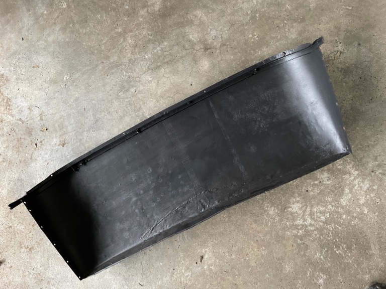

SO, back to my question. Most of the parts are coming together as they should, but the back panel of the font seat I have doesn't fit. I may have been sold the wrong part from the wrong year, or I might not be understanding how to use it.
Even though I don't have the seat or seat riser, I do have measurements off this wonderful forum and those seat measurements make sense when I look at my chassis with running boards and splash aprons.

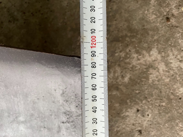

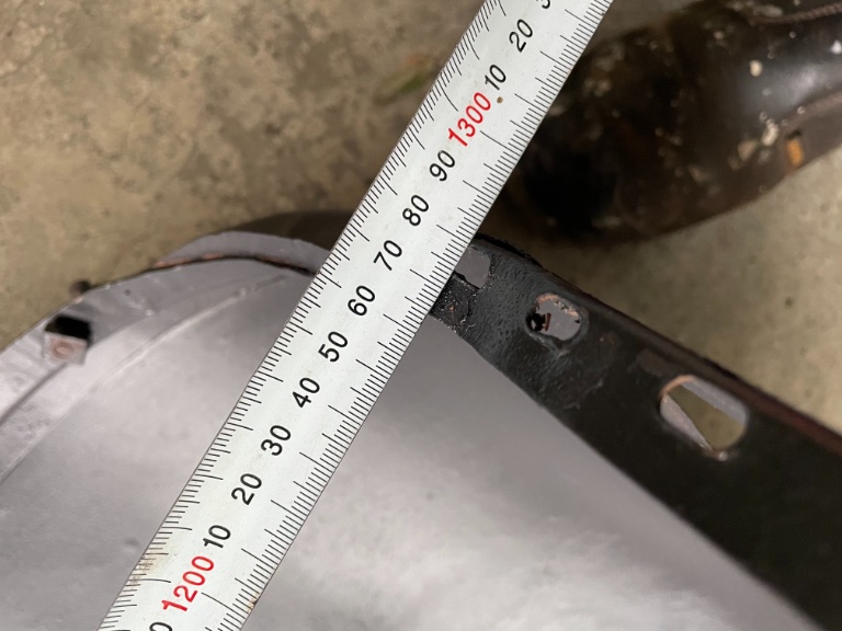

HOWEVER - my seat back panel is waaaaayyyy too wide. I understand the seat back panel doesn't come all the way to the floor but I still believe it is still too wide.
My seat back panel widths are:
Top - 1287mm
Bottom - 1187mm
The measurement I have for the widest point of the seat is 38.25" - 971.5mm.
This panel defines the locations of the panel between the tourer doors and the one I have seems to be around 8" too wide at the lowest point for the subframe I need to build. It is far too wide for the splash aprons.

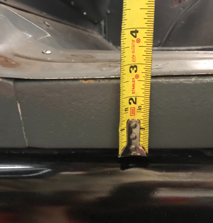

Do you know, by any chance, the lower width of body at the rear door hinge area where it meets the splash aprons?
- Posts: 4045
Re: QUESTION regarding tourer front seat back panel
Height at lower rear door to body edge.
If you meant the width (across the body sill) then the width for in rear door lower body edge to opposite rear door body edge is approx. 43”.

Thanks so much Dan,
the width at the bottom of the sill - across the body - is what I'm after.
Your measurement of 43" is very close to what I though it should be.

I got 1098 mm to the outside of the bottom of the body where you described. 1143 mm across the door sill. BTW: I like those side lights!
