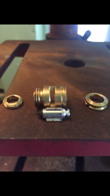

One last thing, I hope this is not considered out of place, but I am curious if anyone knows exactly what changes the late Stan Howe made to Holley H-1's to make the floats and needles work safely and reliably. I have made some of my own changes and when my car sits for about a week, I can smell the slightest hint of fuel. The needle has a very very small leak. Something I do NOT like, and have never had with other carbs. I would appreciate any info regarding what Mr. Howe did if that's not out of place. I respectfully admired all of his work and he was a true gentleman, but never had the opportunity to discuss the matter with him. RIP Stan.

The H1 works splendidly on my 1912 van, and has done so for more than 25 years of mainly city driving on promotional work. It did drop fuel every now and then if the needle didn't sit in the seat correctly when I stopped. In latter years it became a little more temperamental to start.
I had Stan rebuild a replacement for me. He altered the needle and set arrangement, reversing their relative positions and using a viton tipped needle.
It was way to nice to look at, so it sat in the shelves to be admired rather than put to work. I finally got sick of the fuel dumps at stops, and fitted it a few months ago. I could hardly believe the wear in the throttle and choke shafts. Now I am back to no leaks and one pull crank starts. I am thankful that I relayed this to Stan before his passing.

The H1 is the same as the G with a different float/float valve arrangement. The venturi, idle pickup tube, jet and bores are the same. After a year of the S, they went back to the H1 design but with a simpler and more reliable float valve.
You can modify the needle and seat from a GM Quadrajet and make another float arm to have a modern leak-proof setup. You don’t even need a lathe, it can be modified with a drill press a hacksaw blade and a file, drill where the original needle seated and tap 3/8”-24 and used a lead washer.
