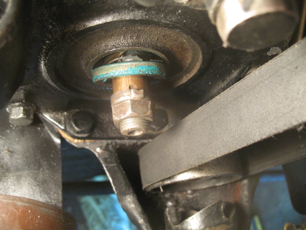

Topic author - Posts: 7340
Re: Feeling stupid
I was away from this for a couple of days, working on non-T stuff, but this afternoon I got back to it.
I started with compression testing, first dry then with six squirts of oil in each cylinder.
1 24 24
2 33 30 I have no clue why it would be lower wet.
3 0?* 36
4 30 34
*Zero? On the compression stroke the needle jumped up over 30 and immediately fell back to nothing.
I must say I have my doubts about the accuracy of my tester. Going by the difference in feeling when I crank with plugs out and plugs in, I think it may be reading low.
With the cylinder oiled and compression apparently at least good enough, I decided to try starting again. I set the NH at two turns open, set the throttle down to what looks like 20-30 mph, choked four times, flipped the switch to BAT, and started cranking. As before, in many pulls I got a smoky pop back through the carburetor a couple of times. Otherwise all was dead.

When I set about checking the timer I found this. I doubt that it has anything to do with non-starting, but I'll have to get the radiator out of the way and deal with it.

Steve, Check your valves, those compression readings could mean that some valves aren't seating all the way. At hand cranking speed it would be hard to get enough fuel to start that way. I bet if the timing is good and you try towing it to start, it will run, and loosen up enough to hand start after a little running.
- Posts: 2536
- Last Name: Strange
- Location: Hillsboro, MO
- Board Member Since: 2013
Re: Feeling stupid
If I recall, on one of your previous engine builds you had to remove the plugs and oil the rings before cranking for the first few starts in order to get enough vacuum in the intake manifold for the mixture to get sucked into the cylinders. Once the rings sealed, all was well.
Of course, you have all the plugs out and the throttle set fully open when you're doing the compression test (right?).
Certainly, fix the loose cam seal, check the position of the timer rotor (verify not 180 degrees out), and try again.
Regarding fuel, the engine should pop and maybe even run for a few seconds with no carb installed at all and with a shot of ether in the open intake manifold. I've seen guys run V8s without carbs before for a few seconds, just by dribbling gas into the open manifold hole.

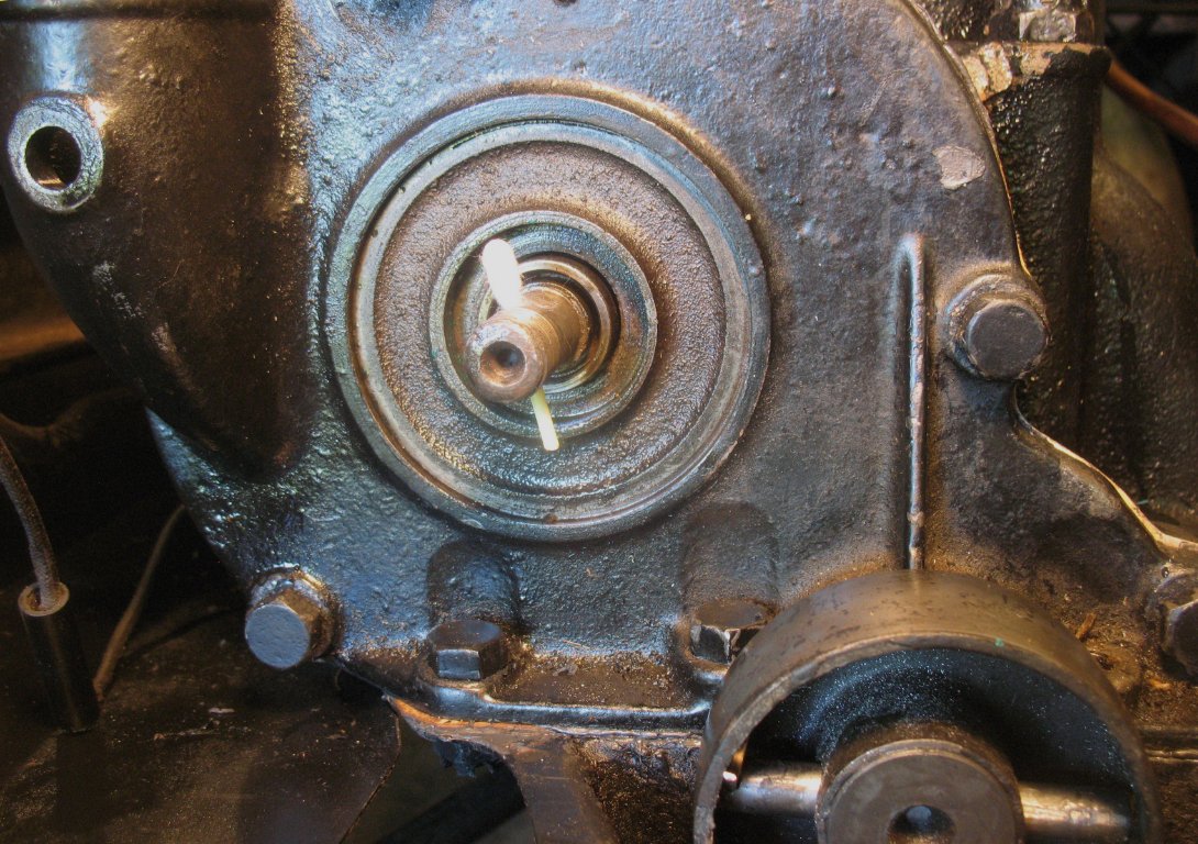

Re: Feeling stupid - hard starting
Well. See what I found.
The 180º guys nailed it. I was sure the cam was a later one, but I was sure wrong.
The brush is pointed to green (#4), not black (#1).
But wait, there's more. The broken brush flops around on the shaft like a wet noodle.
I also found that the timer control arm wobbles on the rod. I have more to do here than just replace a cam seal.

- Posts: 6590
Spark timing was perfect...just not when the valves were closed
Just how old IS that cam??? In a refreshed engine?
Good going Steve, and you don't even have to pull the timing cover to check the cam gear. You will be driving your 1915 roadster soon.
OK so it was always hard to start but it did run. Your brush is 180 degrees out? Actually I don’t believe it is. I think the cam gear was installed 180 out. That’s totally possible as it only mounts on 2 pins. The marks will align but the cam shaft is 180 from where it originally was. This swaps all the companion cylinders. Where 1 was on TDC compression now 4 is on TDC compression and 1 is on the top off the exhaust stroke. Reversed. Remember it was always hard to start but it did run. My point? Your brush isn’t pointing wrong. It may be broken but it’s not on the wrong cylinder.
- Posts: 1458
- Last Name: van Ekeren
Charlie. makes no difference, fit the cam gear 180 around or the cam 180 around, only way to be 180 out is with the timer on the early cam having the hole going right through.

I'm back, after a bit of a detour. My timer control lever was loose and floppy from wallowed out holes in the lever and rod, and the pin was a cut-off nail. So I took a couple of days to find and paint a better lever, pull back the steering column to fill and redrill the hole in the rod, install the lever with a new pin, and reinstall the steering. Then I got back to attempting a start.
I replaced the broken timer rotor with a new one, installed it pointing to #1 (red) with the timing set at 15º past TDC. Looking through the #1 spark plug hole, I observed that as the piston came up after the power stroke the exhaust valve opened. I assumed that if the #1 valves are right, the rest have to be also. I set the carb adjustment at 1½ turns, set the throttle lever down at what looked like about 20 mph, pulled four times on choke, buzzed the coils, and gave it a go. Nothing. Dead, dead, dead. Not even a cough.
I unscrewed all the plugs, dribbled some gas in each cylinder, replaced the plugs, flipped the switch to BAT, and tried again. Nothing.
I'm grasping at straws now. I'm sure the Splitdorf plugs are good. They look great in the tester. But I replaced them anyway with Autolite 3095's that also tested good. Nothing, of course.
So that's where things stand now. The next thing I'll do is go back and study all the posts above and see if there's something I missed. After that, I don't know.

I’m a bit lost. Concerning why you said the brush was pointing at 4 instead of 1. What was wrong there? The thing ran like that didn’t it? Or am I mistaken about that too? I sure as hell hate this long distance diagnostics. It just doesn’t work. Every time you look at this thing you seem to find something else. If (yet once again) you’re sure everything is 100% I’d be thinking about a tow.
- Posts: 6590
If the timing was that sloppy and imprecise, I'd venture a guess that this was the entire trouble of hard starting all along before all of the engine work was done (which in no way improved the starting sequence).
I agree with Charlie and multiple other posters, who have stated the opinion that at this point, if (IF) everything else is finally right, your rings are leaking badly enough that you need a tow and it should start very quickly in high gear.
It would not be the first time that new rings in old cylinders would not seal well enough at low cranking RPM that an engine failed to start. And once started, it would not be the first such engine to start just fine from then on.
