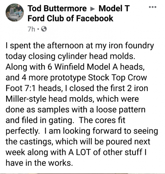

Moving ahead nicely. We expect to get 6.25 -1

They will available in Aluminum and cast iron.

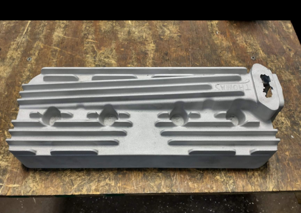

Post by Model T Tom » Sun Jun 13, 2021 11:41 am

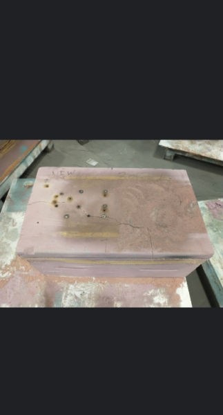

Up date.

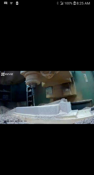

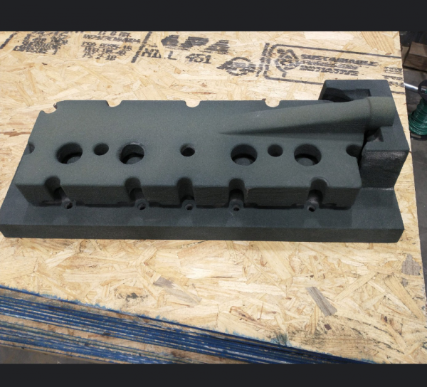

Post by Model T Tom » Wed Jun 16, 2021 7:40 am
Another picture

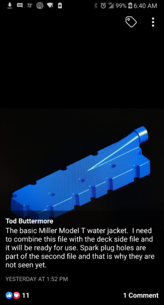

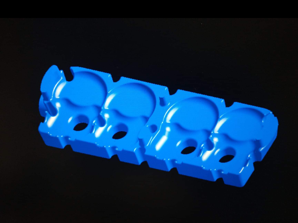

Post by Model T Tom » Fri Jun 18, 2021 7:39 pm
Water jacket
Water jacket
Water jacket

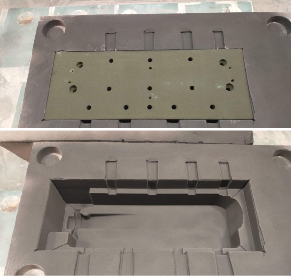

Post by Model T Tom » Mon Jun 21, 2021 5:51 pm
:cry: More progress on head

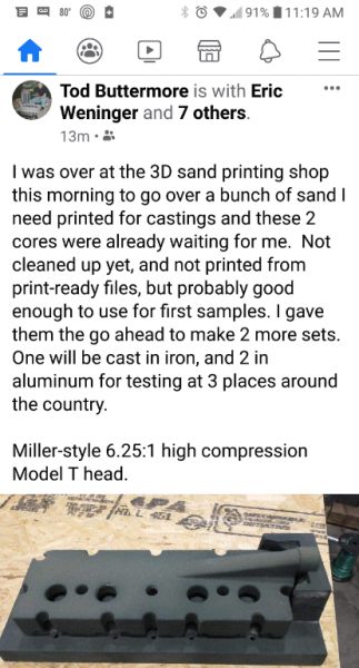

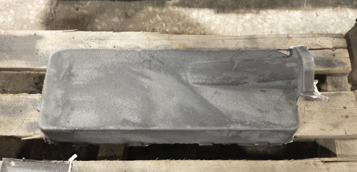

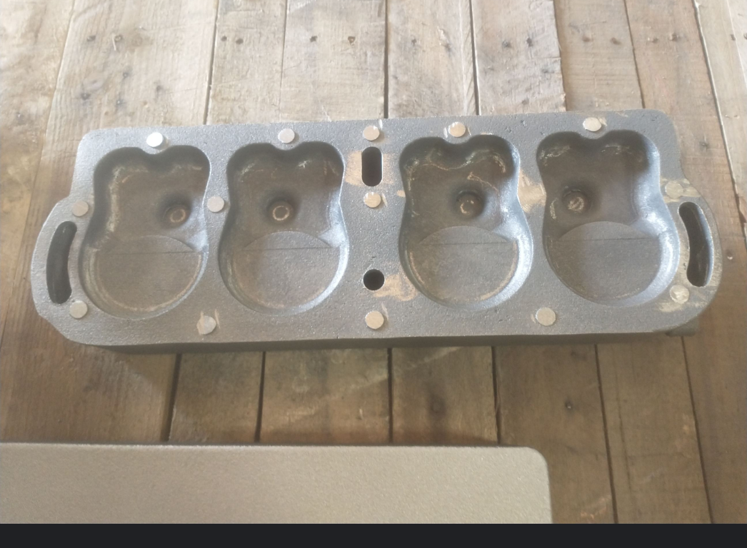

Post by Model T Tom » Sat Jun 26, 2021 11:16 am
Almost ready for the first prototype

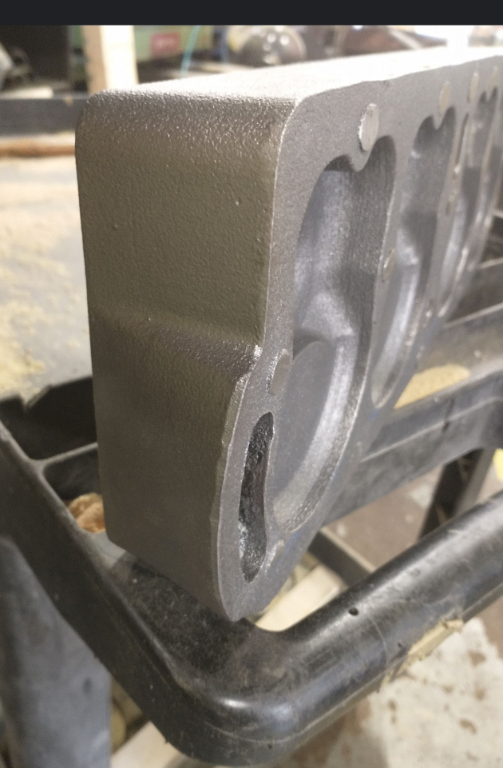

Re: Miller head update
Post by Model T Tom » Sat Jun 26, 2021 11:21 am
Update
Posts: 6634
Post by Scott_Conger » Sat Jun 26, 2021 11:33 am
I will admit that I was a skeptic in the beginning, but must make amends. Very impressive progress, and kudos for supporting the hobby in this fashion.

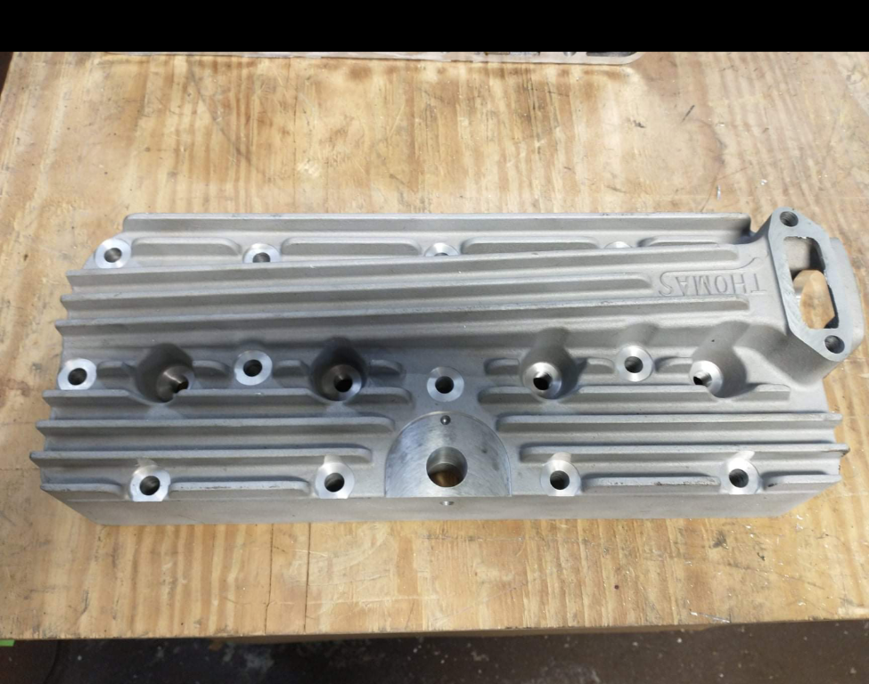

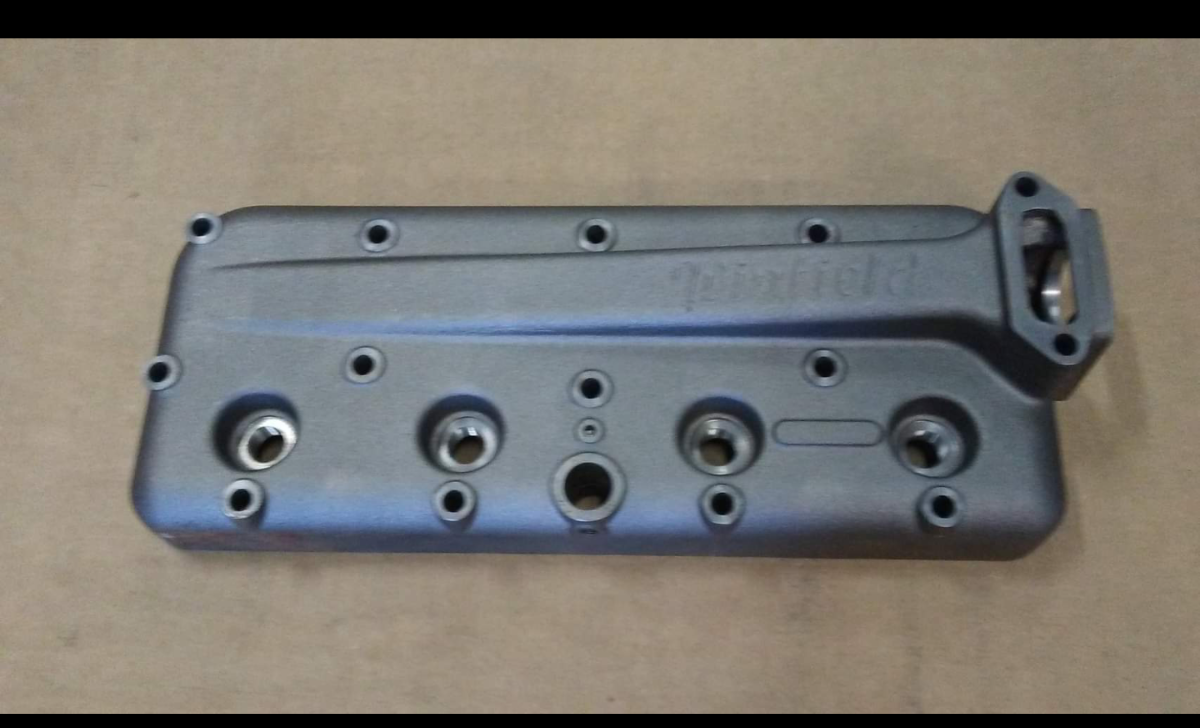

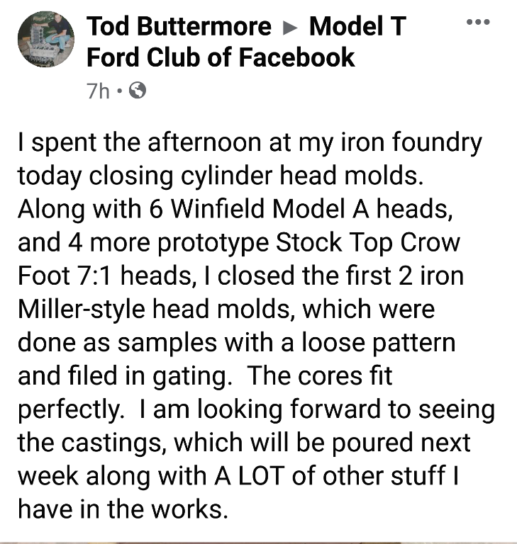

Post by Model T Tom » Sun Jun 27, 2021 11:13 am
This is a sample the quality heads he produced. Having 1 aluminium and 1 iron head made to test.
Post by Model T Tom » Mon Jun 28, 2021 12:59 pm
Here is a model A Miller head in iron. Quality work only.
Post by Model T Tom » Mon Jun 28, 2021 1:36 pm
Sorry Winfield head

Post by Model T Tom » Tue Jul 06, 2021 10:06 am
A test chamber was CNC cut and CC'D to get an accurate ratio.
Dan McEachern
Posts: 1455
First Name: DAN
Last Name: MCEACHERN
Location: ALAMEDA,CA,USA
Post by Dan McEachern » Tue Jul 06, 2021 12:12 pm
Seems the solid model should have given a pretty exact volume- no need to machine a dummy?? So what is the chamber volume?
Model T Tom
Posts: 430
Joined: Mon Jan 07, 2019 9:26 pm
First Name: Thomas
Last Name: Butterworth
* REQUIRED* Type and Year of Model Ts owned: 1911 speedster
Location: Florida
Post by Model T Tom » Tue Jul 06, 2021 1:05 pm
Chamber volume is 180.
Dan McEachern
Posts: 1455
First Name: DAN
Post by Dan McEachern » Tue Jul 06, 2021 7:17 pm
4" stroke, stock bore and piston volume of 52.25 cc, that comes out pretty close to 6:1

Location: Florida
Post by Model T Tom » Tue Jul 13, 2021 6:36 pm
First 2 head's poured today. They will be shaken out tomorrow and we will see what we got.

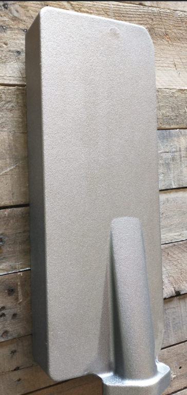

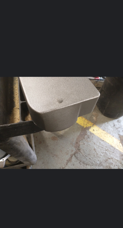

Post by Model T Tom » Wed Jul 14, 2021 11:42 am
One more
Model T Tom
Posts: 430
First Name: Thomas
Location: Florida
Post by Model T Tom » Wed Jul 14, 2021 2:46 pm
Better picture
Michael Peternell
Posts: 730
First Name: Michael
Last Name: Peternell
Location: Albany mn
Post by Michael Peternell » Wed Jul 14, 2021 8:15 pm
Bottom and top side photos don't seem to match?
Posts: 6634
Post by Scott_Conger » Wed Jul 14, 2021 8:54 pm
Michael
I was wondering the same thing and wonder now if it isn't a function of camera angle. As an amature machinist I could see where the gasket side would be molded to a machinable profile with the water jacket being above it and squared off. All views have so little depth of field that within an inch or two the far side is shrunk beyond the line of sight. Look at the underside view and magnify it while looking at the right/forward corner and see if you don't happen to see what appears to be (?) a squared off profile lurking below/beyond the seal surface.
A 3/4 view would be most interesting and at least dispel confusion
At any rate, pretty nice looking castings with an absolute minimum of obvious porosity
Michael Peternell
Posts: 730
First Name: Michael
Location: Albany mn
Post by Michael Peternell » Wed Jul 14, 2021 9:31 pm
Michael
Just can't be unless there's a flat top hiding the rest? Not trying to be any sort of expert! I'm definitely on the other end that!

Model T Tom
Posts: 430
First Name: Thomas
Location: Florida
Post by Model T Tom » Thu Jul 15, 2021 10:28 am
Better pictures
Posts: 6634
Post by Scott_Conger » Thu Jul 15, 2021 11:34 am
Thanks Tom
that's exactly what I had imagined was lurking!
that is one beautiful casting

Model T Tom
Posts: 430
First Name: Thomas
Location: Florida
Post by Model T Tom » Thu Jul 15, 2021 1:26 pm
Optical illusion
Posts: 6634
Post by Scott_Conger » Thu Jul 15, 2021 2:21 pm
Michael
you a believer yet? :D
Michael Peternell
Posts: 730
First Name: Michael
Location: Albany mn
Post by Michael Peternell » Thu Jul 15, 2021 11:19 pm
Michael
Yup! My bad!
