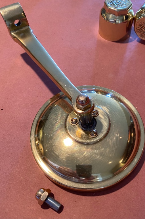

I picked these sturdy and great looking aftermarket side view mirrors, custom built for Model T’s, at the Bakersfield Swap Meet. I can now actually see what’s behind me.
They are cast and assembled by Bill Bohlen in Southern California. You can find his store on eBay by entering: “Model T Ford brass rear view mirror 1910-1916” in the search bar. Currently $78 each. Cheap if you consider how much they are used.

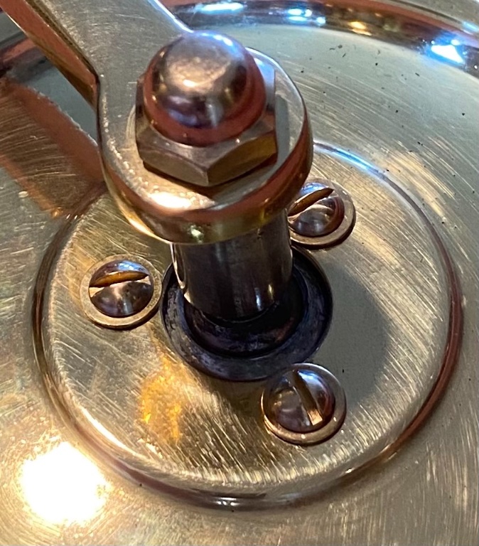

I was able to swap out Bill’s modern fasteners with three solid brass, period correct, round top screws (one at a time as to not set free the innards) and a solid brass dome nut atop of a short piece of 5/16 x 24 bolt thread. See pictures. This didn’t improve the function so much but did improve the overall look.
PS, If the insides do happen to fall apart, you need only remove the rubber gasket around the glass to get everything back together, like pulling a tire off a rim. …Ask me how I know this.

- Original fasteners which I replaced.
Source: ebay - 8CA8F650-278C-41A4-A3CF-2203BA36AC82.jpeg (11.9 KiB) Viewed 4829 times

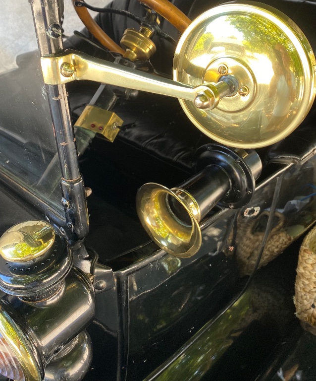

I have a brass one on our ‘12 pickup and a black one on my speedster.

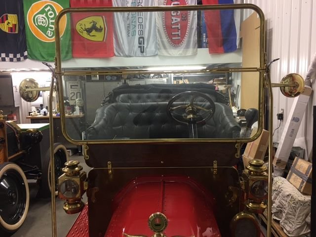

On my 1915 Touring, I simply removed one of the original machine screws half way up on the side of the windshield frame and screwed Bill's mirror into that same threaded hole using a slightly longer screw, in my case a round top brass one. It was just that easy. However, Bill does specify that his mirrors are intended for "1910-1916". This would make me think that you do not have such screw assemblies on your 25 windshield frame. In any case, please note that I removed the modern fasteners (4 per mirror) from what Bill sent me and replaced them with period correct solid brass hardware. You can see this difference in the photos above. In other words, this final retrofit you will have to do yourself.

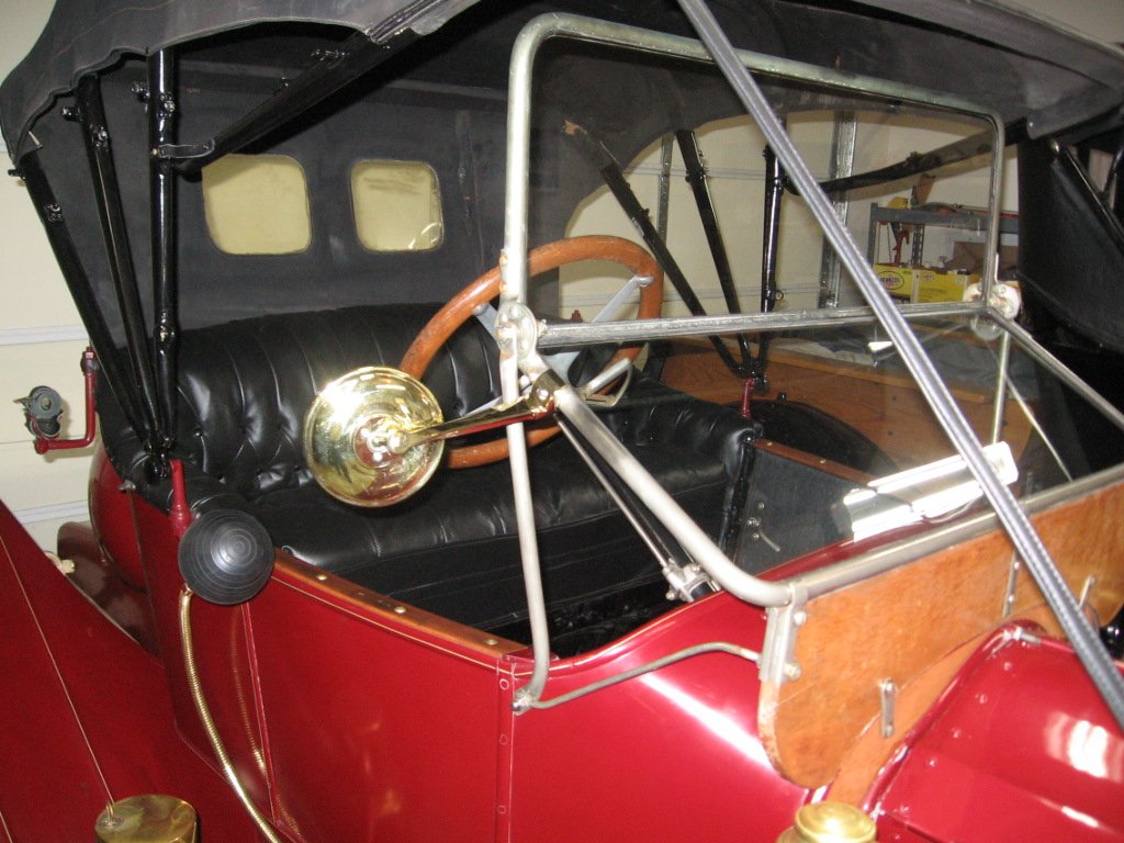

They are my favorites as well. I have used them on several T's. 1921 was the latest year, and they went right on using a (longer) hinge screw. No drilling required.

I have a pair of those on my 1912 Flanders. They mount onto existing windshield pivot holes, no drilling required. I had to heat and twist the arms to get the mirrors to the correct angle. I also found a matching diameter convex mirror on Ebay for the side opposite the driver to give a wider field of view. It bolted right up to the arm, but only came in black, so I had to scuff it and paint it brass color.

I have 2 mirrors from Bills for my 1911 Touring and I'm really please with them. He also provided longer brass screws with it. I Installed them in a minute and work really well.

I too was able to swap out Bill’s four modern fasteners with three solid brass period correct round top screws (one at a time as to not set free the innards) and a solid brass dome nut atop of a short piece of 5/16 x 24 bolt thread.
If the insides do happen to fall apart on you, you need only remove the rubber gasket around the glass to get everything behind it back together again.

I just got around to installing mine on my rusty 15 runabout.
It looks so good I just ordered another one.
