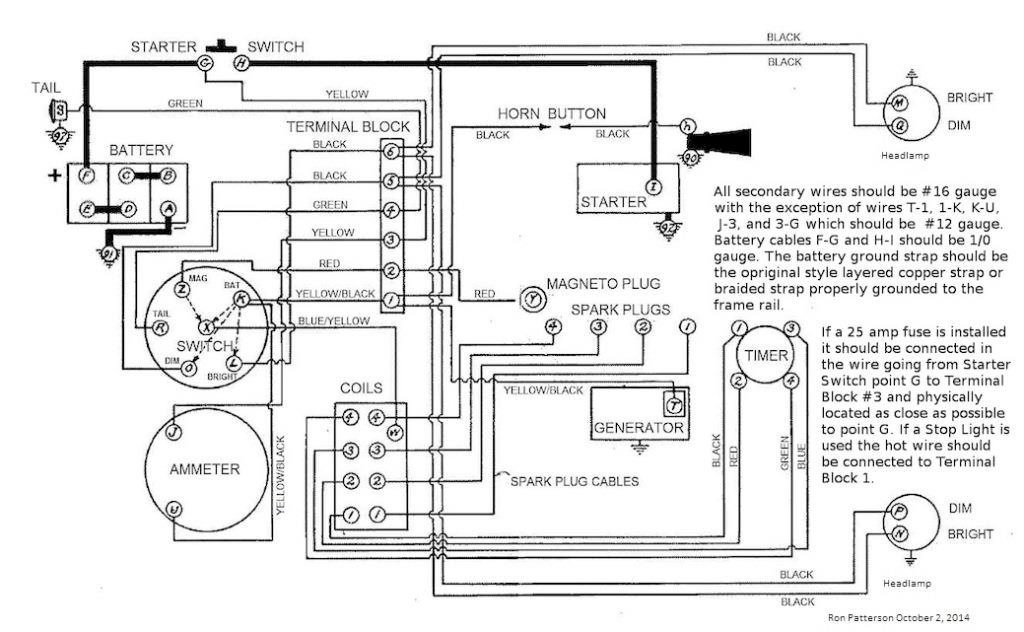

I want to Thank everybody for your continued support by helping me and others! We want to keep this Hobby going......Just cant find any mechanics in Staten island to work on Model Ts. Anyway, I had a hard short and it melted some wires. Unfortunately, I have to replace the whole harness and this is my first time doing this. Any suggestions and hints to make this job run smooth. I want to know where to start first and would it be a good idea to install a fuse to avoid something like this from happening again. Can I install the fuse at the firewall instead of underneath the car by the starter, I have a bad back and had neck fusion, so I am limited. Thanks! I appreciate it!

The closer you put the fuse (25 amp) to the power source (starter switch) the better. With the floor boards out not to difficult. A search of the forum should give your the routing diagram and Ron Patterson's schematic will help.

I have replace wiring harness. Just get them from a good source. IE from the guys on the resources page.
Use the diagram shown above.
you will be all set.

It’s not hard to do. Follow the diagrams, change one harness at a time. Some of the harness manufactures have the correct color code while others are almost right.
Doing it one harness at a time, one wire at a time while your doing it is the best way to get it right the first time.
DONT take a harness completely off and the then try to install a new one.
If you haven’t done a harness before the one harness at a time, one wire a time is the best way to do it.
