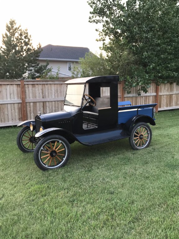

I got my truck on the road today! first time in high gear and one drive around the block. It starts very well but it seems to run a bit rough on the road. New Champion X plugs, rebuilt coils from Brent Mize, new wires, new timer, it just seems to labour and has quite a bit of vibration. I rebuilt the motor about 20 years ago and it just sat until two years ago when I was able to get back to it. It also seems very stiff when I crank it by hand when it's hot. Is that normal for a freshly rebuilt motor? I'd say I have about three miles on it total. Wondering if it just needs to run in a bit.

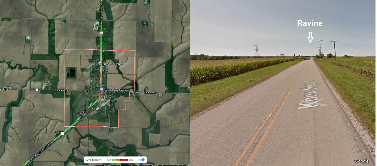

Thought I'd shed some light on the terrain question. Altona is a village in Knox County, Illinois. The population was 531 at the 2010 census. In the mid-west the land is mostly flat with ravines (we go down hill before we go up hill). The steep hills are around the major river valleys. The dark green areas outside the town are the ravines, most are relatively shallow. There aren't many roads outside of the town, but it looks like getting to a "country road" may require a bit of highway driving to get to one. Looking at the map detail, the road (S. Station St) goes to the Cemetery and continues on to what looks like a nice practice area if its a blacktop road vs macadam (tar&gravel).

I have to set you guys straight on Altona...it's a town of about 4000 people in Manitoba Canada, not Illinois! however the terrain looks similar. Flat as a table top and lots of gravel and dirt roads around. I'd have to drive 35 miles west to find a hill. I live on the edge of town so I can drive 1/2 a mile down my road and be in the country.
There's also an Altona in Manitoba. It's pretty flat too.
JamesD
Topic author - Posts: 62
- Joined: Wed Jan 16, 2019 2:10 pm
- Last Name: Doell
- * REQUIRED* Type and Year of Model Ts owned: 1921 pickup
- Location: Altona
Re: first drive
that's the one!
