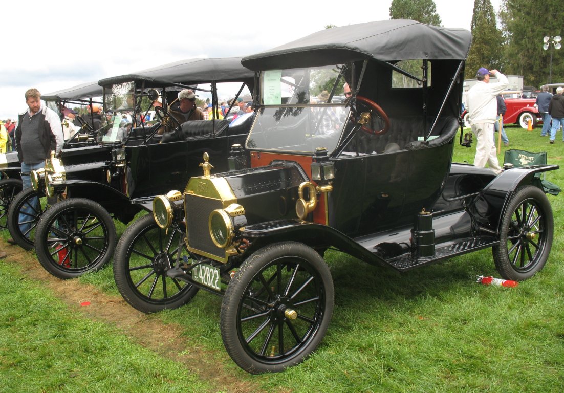

Re: Model T Tires

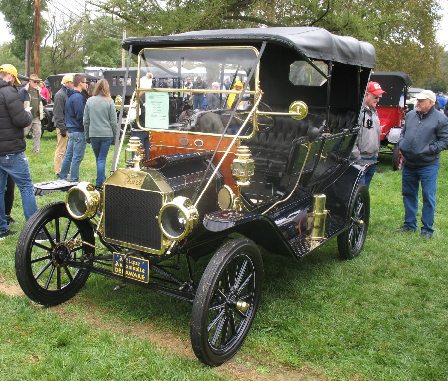

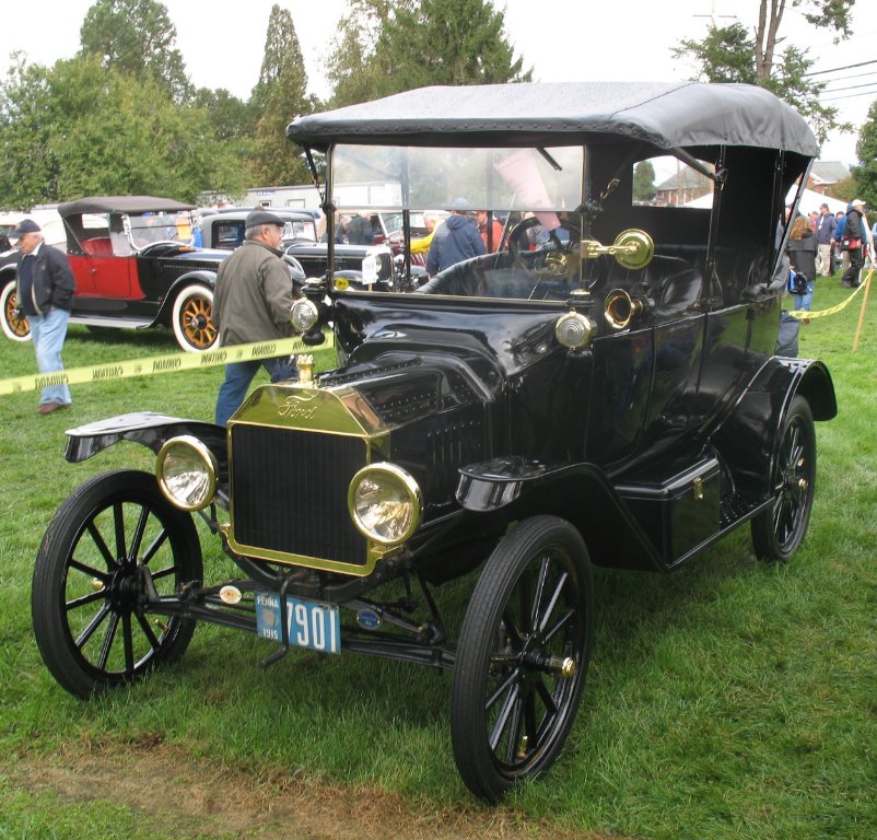

Some tires at Hershey.
Pete Ratledge shows his 1911, but he also drives it a lot.
Most of the brass fords wear black.
I think this 1915 looks good in black.

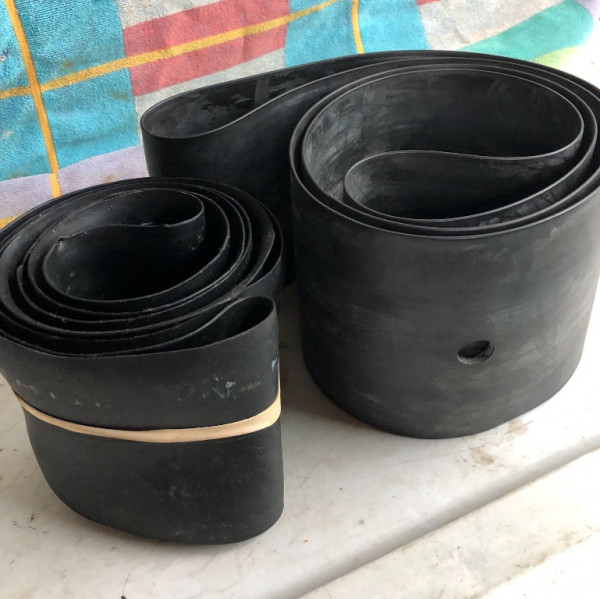

Fellows, it's not the flaps to which I object. I have 6 Ts on 30 x 3.5" clinchers. My objection is to the $40 cost. That's $200 per car, for something which is unnecessary. Flaps help clumsy fitters keep the tube isolated from tyre irons, and they keep the tube away from rough/rusty rim bases. I solve the rusty rim problem by fitting a rim liner cut from the outside diameter of a 13" inner tube, usually free from my tyre dealers scrap bin. This means the tube is entirely encased in the tyre and rubber liner when fitted. The liner also helps to fill the bead on the rim, making the narrower beads on modern tyres a better/tighter fit, and less likely to move under lower pressure. When fitting tyres with both beads at the same time, that solves the problem tyre irons impinging on the tube.
I totally agree with the poster who said that older tyres last so much longer than the new stuff we have had foisted upon us.I can see the logic of buying the lesser quality stuff if one is not going to put mileage on them, but that is a false economy if the tyres will crack up when not in use, as many of them do. Bring on the Blockleys. The small premium in price I will gladly wear.

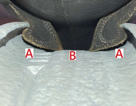

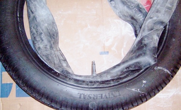

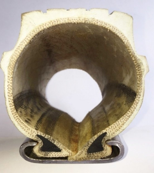

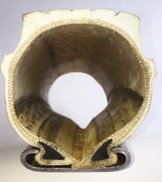

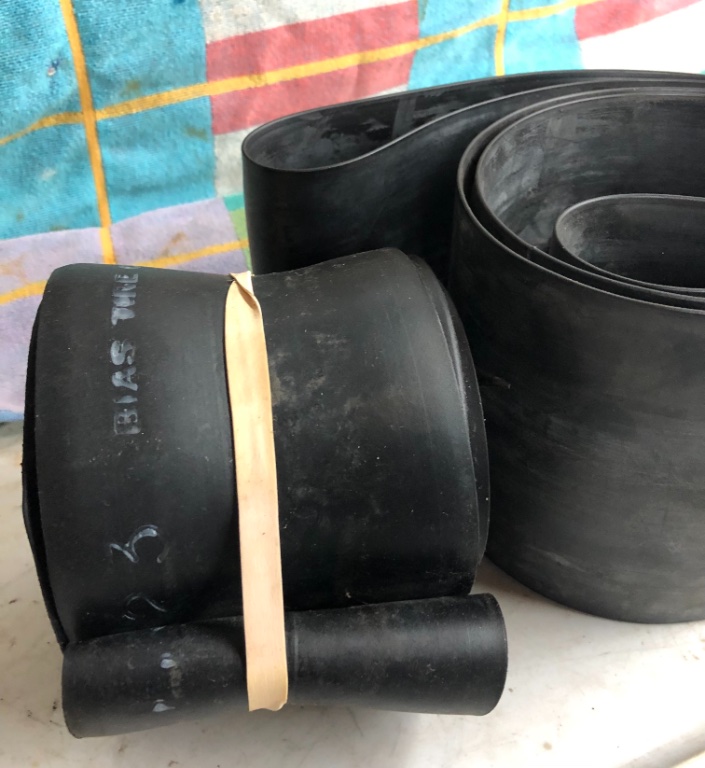

Folks who are dead set against the use of flaps may feel free to avoid this post as it will contain information that may be disruptive to their paradigm.
This is for newer hobbiests who are wondering why others rail for or against a particular item. In this case as is usual, facts matter. After seeing/hearing the facts, conclusions are up to the jury.
This is the cross section of a vintage tire...note that there is no way for a tube to contact the clincher rim, and thus has no need of a flap...very likely the reason that they were not considered necessary "back in the day": photo courtesy of MTFCA and Dan Treace
And now, we have these beauties and similar, which do not fit at all correctly, and pose risk to the tube via extrusion and chaffing, thus making the use of a flap a prudent if not obvious decision for many T drivers who no longer see any charm in repairing random and frequent flats. The tube shown is inflated with only 7PSI and not 60PSI, so deformation of tube has not yet occurred...the pertinent view is that the modern tire does not envelop the tube as it should: photo courtesy of MTFCA and Bob Cascia
In fairness to the Universal T Driver tire shown above, the opening between the beads is so massive that it cannot extrude the tube sufficiently to damage it, though a less than perfect rim will. Firestones and others have a narrow gap here and pinching and extrusion is all but assured. Installation of flaps on modern tires blunts the effect of tube deformation and places a physical barrier between it, and the rim, regardless of the condition of the rim.

As a new guy I appreciate the photos that you posted. Do you have any showing what flaps are? Also what brand/style tires would you get now a days? I am not going to be taking my 1915 across the country but I do plan on driving it.
Ron

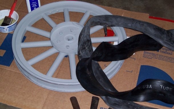

before I proceed, you should know that there are two terms often misapplied when discussing this topic. It hasn't come up yet in this thread, but has in others, and that is the difference between a Rim Liner and Tire Flap. A rim liner is a thin rubber strip which is stretched around the rim...some folks swear by duct tape as an alternative. When I was at your stage of the hobby, I became convinced that I needed to go the Duct tape route. What a gawd-awful mess I found 2 years later. Investigating the situation I discovered that I did not need a rim liner, but a tire flap. A tire flap is a heavy rubber flap (more than a strip) which is moulded to have a curve in it. The tube is placed into the tire and inflated to about 3-4 # so as to hold it's shape and fill the tire without wrinkles. The flap is installed over the tube and tucked under each bead of the tire. The molded curve of the flap allows it to hug the tube and conform nicely to the inside of the tire (there is a single hole in the flap for the valve to stick through). The valve core is removed, allowing the tube to deflate entirely, and the tire can be levered onto the clincher. I do both beads at a time, starting with the valve area...tire is pushed over the clincher, valve pushed through the clincher, about 7" of tire on each side of the valve seated fully with a rubber mallet and then work your way around with a tire iron, popping both beads on simultaneously. The rest is normal stuff, as in inflating and deflating the tire several times to allow the tube to find it's final resting spot without wrinkles or pinches.
The flap will come with a sticky coating which I have found will make your hands filthy, but I get best results by leaving it on the flap. I do not know if it is a mold release agent or some sort of wicked rubber lube, but things just seem to work better by leaving it on. I use talc or Ruglyde to make the beads slick and want to go over the clincher...which one I use depends on how long it takes to find the bottle of Ruglyde.
I get things likd Flaps from either Chaffins or Lang's and do not know if there are different mfgs or not. I have always been happy with what I receive. They are a one-time purchase and will outlast you, your tires and maybe your car.
I do not have a picture of a flap installed, but suffice it to say that it is inside the tire, supporting the tube at the clincher opening. It is made of a substantial cross section of rubber, well in excess of the tube wall which is thickest at it's midpoint and tapers somewhat to the edges, providing the most support where it is needed the most. I'd estimate that it envelopes about 1/3 of the diameter of the tube.
A picture of a rim, tube, flap (the thing marked "USA TUBE"), courtesy of MTFCA and Dan Treace:

Scott: great pix of the issues with todays beads.

Flaps should be used on clinchers. They are also good to be used on split rims. However on drop center rims. the rim strip keeps the tube from contacting the rim. It is not necessary on very clean smooth rims, but if pitted or rusty, the strips will save a tube. So it just depends on what type tire and rim you are using.

Your post was very clear on the purpose of flaps in today's modern tires. Have used flaps in all my clincher rims for 20 years. Makes tire mounting easier and saves on tubes as you wrote. BTW, Ford factory used flaps in Split Rims, and should be used today. Ford Service also warned with the marketing of the new wire wheels in 21" size Not to use flaps in drop center rims, that will cause issue in install or removal. Once had to pull a tire off a drop center rim Ford wire that someone foolishly put in a flap, that was a chore!
Just one thing, I got a recent batch of flaps from Langs. 30"x 3 1/2" flaps to install in a Firestone tire, BUT....these pair of flaps when received weren't going in my tires.....no way. This pair was HUGE, bet they are Truck Flaps, too wide, and no molded curve or taper to fit to the narrow tubes used in T tires.
I called Steve Lang to let him know others will likely complain, fortunately for me he had two slightly used flaps on hand that he just sent me.
Note the proper flap on the Left, Made in USA and marked for 23" rim, with marking to note "tube to this side". These are correct and what I have always used.
Seems that Lang's and maybe others can't get the proper flaps now, maybe a supplier issue, or Covid19 issue or what ever. But the large, wide, flat with no taper flap on the Right just won't work!
Proper Made in USA 23" flap surrounding a new tube going into a new tire casing.

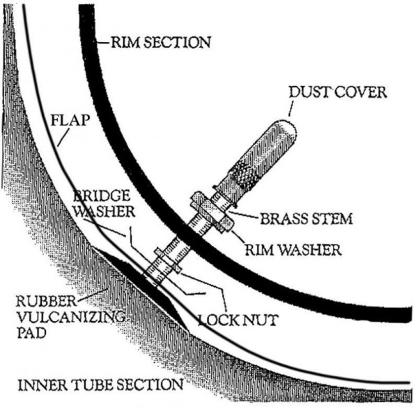

Scott, the photos you posted tell a story. However, only part of the story. The first one shows a rim section which has the bead turning back on itself, not the usual profile. I suspect it is a modern replacement.There is no way the tyre can properly fit in that bead. We are not told whether that is for the narrower front wheel. We are not told whether that section of tyre is from a 3" or 3.5". The fact is, when properly fitted and inflated, the overlap in the centre of those beads will disappear into the rim beads.
The second photo shows a proper clincher rim. The tube type rim liner I fit is cut to the width of the outer edges of the A's you use in the illustration. As such, they lift the inner edge of the tyre bead, and make the bead a better fit in the rim. The totally isolate the tube from the rim.
Some of the flaps today are far too wide anyway for narrow T tyres. I had a job removing a set of Firestones to replace some cheap, undersized motorcycle tubes that had valve stems too short to access them without an extension. The flaps fitted had prevented the inflated tube pushing the tyre out into the beads, resulting in wear groves in the sidewalls some 3/8" up from the seat on the bead. One tyre had to be discarded because the wear grove was into the canvas.
Flaps are essential in 21" split rims like those on 26-7 Ts. The tyre tube and flap assembly is fitted as a unit over the collapsed rim. The same applies to the TT rear wheels, and all truck wheel up to the advent of tubeless truck tyres.

Question for Scott - looking at the cross-section of the Universal T driver, would you use a bridge washer between the flap and rim to reduce tension from the stem pulling on the tube when the rim nut is snugged down? Blockley says no Bridge washer required but will the thick flap be enough to prevent the tube from being pulled down between the beads if you don't over-tighten the rim nut?
- Posts: 7141
Re: Model T Tires
For general information, the bead on Blockley tyres is no wider than that on the current offerings. This may be a reflection of their Vietnamese origin, like the rest of the current offering. To my knowledge, the tyre carcases are not the problem with the current crop. The life of the tread and the cracking in the sidewall are. I believe the Blockley tyres have been developed to overcome these failings.

Tim, regarding bridge washers and Blockley tubes: I don't know one way or another
I'd be inclined to follow manufacturer's recommendations until such time as they are perhaps shown to be faulty
Allan, to your points regarding the pictures, they are not my pictures and were selected from MTFCA archives to simply clarify discussion points.

Pete Ratledge also has a complete set of white tires on new rims for show inspections - sometimes.
I visited Pete last month and saw them there. I suspected that was why they were not on the car.
