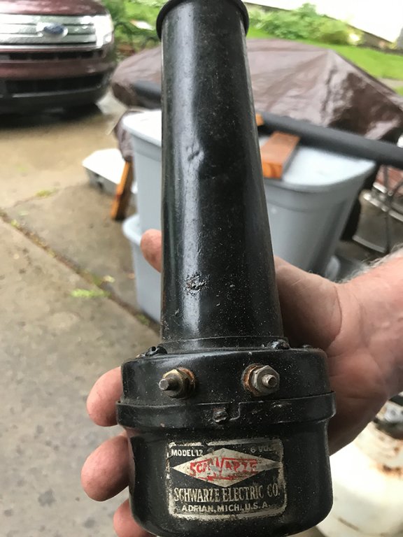

Anybody know anything about a Schwartz Electric Company Model 12 Horn? Is it an Ahhooga horn or what? Came with a Model T my buddy bought.

Schwarze (note spelling) Model 12, 6 volt
Hook it up to six volts DC and see what happens.
Otherwise, remove the rear cover. If it has a motor and diaphragm, then it may be a klaxon/ahooga.
If it has electro magnets and a diaphragm only, then it is not an ahooga.
