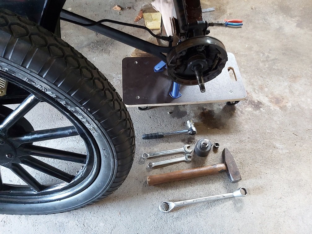

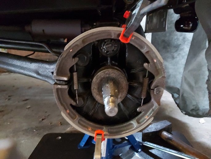

Finally got my rear wheel off to look what makes a noise there - but found none
After some trying last year to get off the left rear wheel without success (using the puller did not show any result) I now followed the hint I read here somewhere and this was driving a short distance with slightly loosened axle shaft nut.
Moving some meters to and fro already did it. Although I did not here a sound of the wheel getting loose on the axle (it was said there could be one) the puller now did what it is supposed to do without too much effort.
Reason for taking the wheel off was a loud 'tok - tok - tok ...' while driving and moving the T by hand in the garage - and this since I bought the T in 2015.
I never could find a loose spoke by wiggling every spoke and knocking against so I supposed perhaps some parts inside the brake drum were having contact they better should not have.

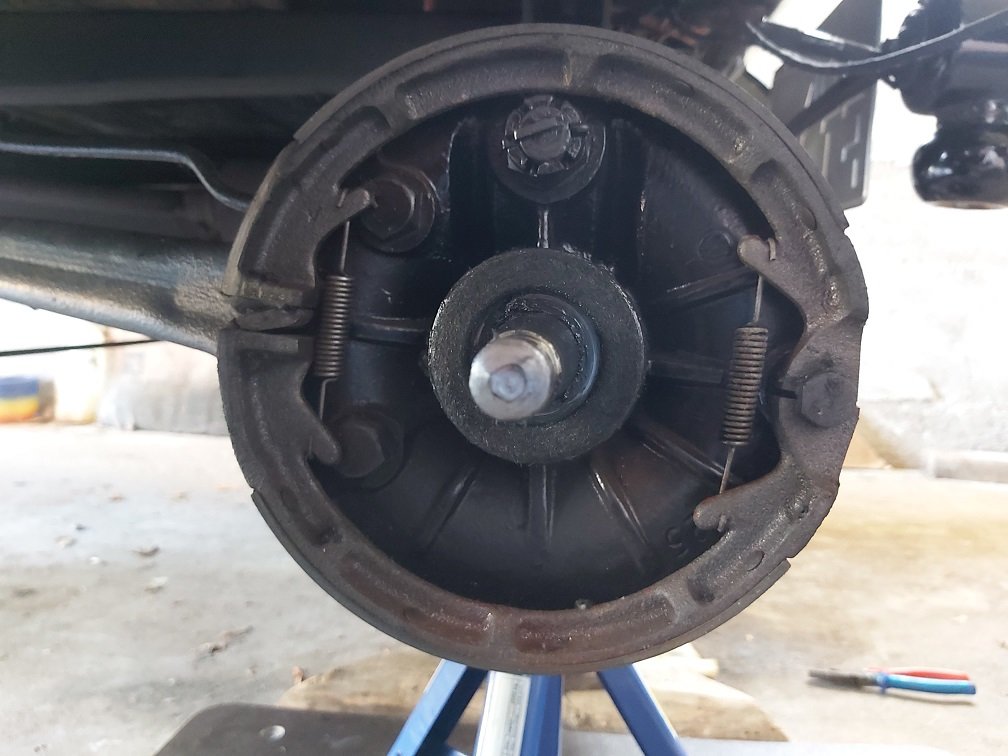

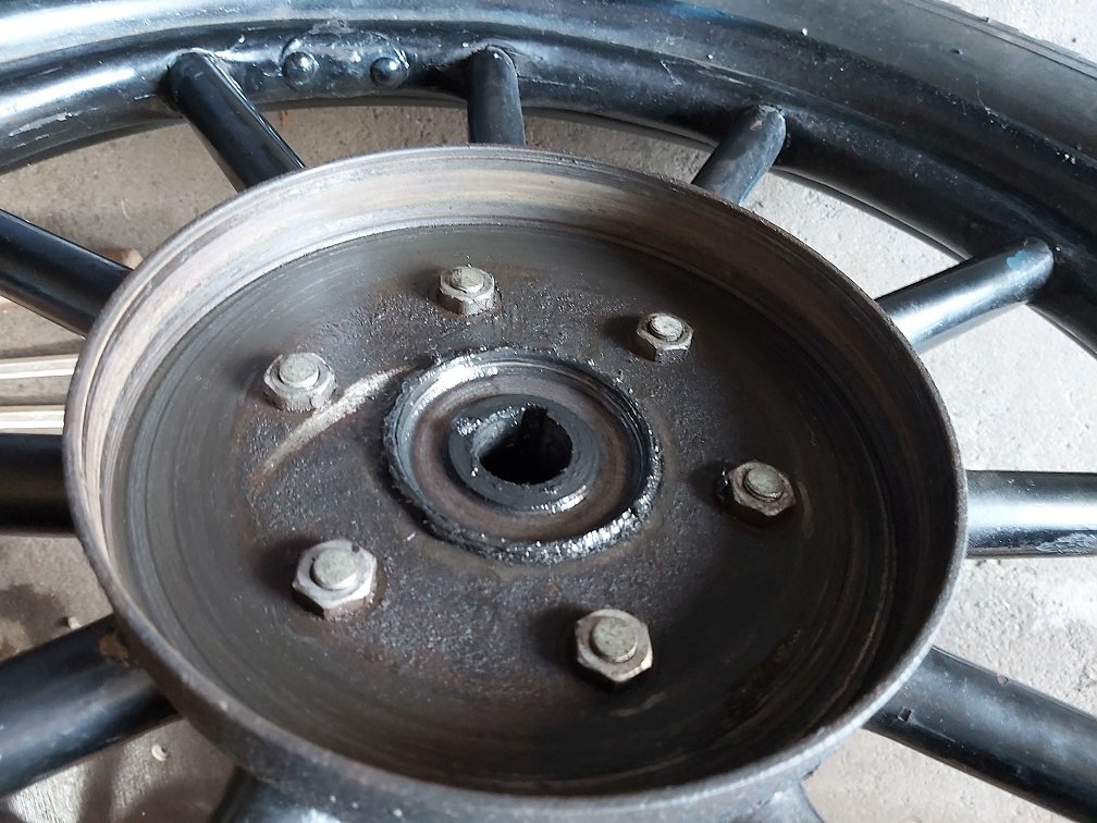

As obvious on the below photos there is no mark to be seen that could be caused by any bolt or nut or anything else rubbing against each other.
The bright stripe in the brake drum was caused by the end of the axle when taking the wheel off.
So what else could cause a loud sound like that ?

Joerg,
I see some wear on the TOP brake shoe near the brake cam. There is also a matching wear pattern on the inside of the brake drum. I agree with you, and I do not see anything that would cause the sound you hear.
I agree with Mr. Jelf, and the sound may well be coming from your rear end and not from the wheel areas. Does your axle slide in/out or up/down to any extent?

For sure what Norman said above- most likely loose wheel hub bolts. Order new bolts and nuts would be my choice. You can try tigntening yours, but be aware that the nuts on old bolts often strip out when you tighten them.

Is it just the pictures? I do not see evidence of a felt washer on that wheel.

@ Terry: no movement on the axle - checked it several times before, the wheel was sitting solid in every direction

@ David: the falt washer is there, just greasy and compressed. I already exchanged it for a new one

Joerg, I removed the wheel took out the hub bolts and found wear on the bolts at the point they pass through the inner and outer hub plates (or whatever they're called.)
I ordered 12 bolts and 12 nuts for both rear wheels from Langs, disassembled, replace bolts, put it back on and no more tock, tock, tock noise.

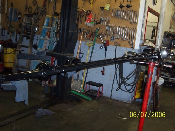

Take a look at the photo of the car, dated 2006. Notice the 6 shiny, new, unpainted hub bolts in the same wheel. There was an issue with that wheel even then. As Scott C. mentions, just replacing the bolts won't cure the issue. Apparently, it didn't in 2006 either.

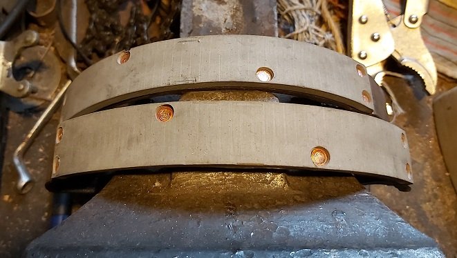

Yesterday at least I finished to reline the brakes - and of course the linings are too thick with 5 mm (I bought it per meter and obviously did measure the distance in the brake drum somehow wrong). At least after some grinding at the ends of the linings (and YES I am aware one should not do it but that must do it for now ...) the wheel is on again and is turning but the brake rod now is too short so I will add some 'long nut' (when finished pictures will show what I mean). Next step will be to have the car running on stands to let the new linings 'run in'.

THE SPRING WAS FASTENED AFTER TAKING THE PHOTO

With all said let me point out that I am not the professional mechanic and I envy all the fellows around here who have all kind of equipment, take their T apart and together every second day and do know all the details of 'how to' as well as do's and don'ts. For me it is always a challenge to find out what is not working and how to cure it - so please do not be to hard in condemning my tinkering on my T - I do believe that this car is somehow made for that and I am proud of the things I am able to finish (even in the non professional way).

As always I too will start by saying I'm no expert. And sometimes my eyes, as well as pictures, deceive me. But as I've looked twice at the inside of the drum, it sure also seems to me that the end of the bolts protruding through the nuts are not peened over, to prevent them from working loose. Correct me if I'm wrong please, Joerg. But they do work loose, which of course may allow this noise? You'll eventually figure it out. Good luck!

am not sure but think that I need to ask…is the height of the hub nut correct? Are the bolts longer than needed?
Chasing rear end sounds can spend a lifetime without ever finding them. However, I agree with others and would really question how ‘tight’ the wood felloes are against the steel rim. Just because there is a rivet in place, doesn’t mean it hasn’t lost its ‘cinch’ and the riveted end is still in place and tight. The wheels always have some side to side wave once used a bit, the rims maybe not so and then can cause a click from the shrink fit as they try to true themselves. (You don’t have to ask me how I know this….grin). Even then I for a while said ‘felloe is tight enough…I only drive slow’ before realizing how significant that skinny rivet really is! Don't make the same rationalization.
You have determined situations where the tik-tok-tok can be recreated as a dry test.
Have you tried swapping real wheels side for side and for the same situation to see if there is a difference?
Have you tried an axle shim? I know, guys hate them and recommend against their use…but you could cut one out of a beer can for the sake of a test…it moves the nuts/bolts just a smidgen further away from whatever is mounted to the axle backing plate. For the sake of a why not, why not try it if only to eliminate?
(Pictures are certainly deceiving, but I think those nuts might be thick nuts and even at that there is too much bolt showing even if proper nut thickness for me to be comfortable)
It might also be that your lined brakes 'kiss' a spot on the drum and sometimes it self-corrects with a tip-tok-tok and other times does not care. Have you tried one of your known tip-tok-tok experiments where the shoes themselves are removed and while at it also the cam lobe (they tend to wobble in place too?
From the above, something should point you in a more definitive position.
Good luck

@ Tim and George:
I know the nuts are not secured and I thought about 'flexing away' the part of the bolts standing over but I first wanted to find the annoying sound and there was absolultely no trace of any part scratching against another. The sound is definitely within the wheel as I can create it when leaning on the wheel having it off the car. Until now I could not find any spoke or the felloe being loose in any way - I could not move anything by manual force or with a rubber hammer.
It will take now some time to test the new lined brake and adjust the right side (with supposed worn linings) to operate together - then I also will see how the wheel is 'behaving'. Mid of June I will have some vacation with time to proceed so I hope to be able to give an update then.

Joerg,
The linings you show have a better chance of scraping than most. The new one piece linings now have the outer edge of the flat which sits on the cam ground off at 45 degrees because that square end does impinge on the hub nuts if things are not absolutely bang on. You can make the same modification to yours if they do scrape.
Hope this helps.

Brake and wheel reinstalled, brake on right and left side 'synchronized'.
Linings had to be grinded to lower width but that worked pretty fine.
Bolts have been grinded down and punched to secure.
Wheel is still making noise what should be mainly the felloe - due to the fact that I drive less than 200 miles a year I will leave it for now, and YES i know that is against all reasonable advice given.
