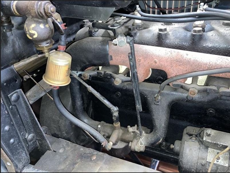

New owner of a 1927 Touring, I know about nothing on Model T's

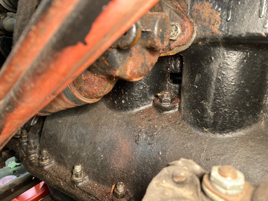

I have some weird linkage set up on my carburetor, I believe because they added a water pump and it was in the way of the throttle rod, I'm get rid of the water pump and going to try to go back to original. My engine has a hole in it for the throttle rod but the tappet cover does not, can I just cut a hole in the tappet cover or is there some specific cover I should be using.

As far as I know, all 1927 Fords came with Vaporizers.
- Posts: 5118
Re: 1927 Touring carburetor throttle rod?
Throttle arm position is for a vaporizer. Someone made a way to adapt for the 25-26 carb. Normally there would be no hole in the casting between 2 &3 cyls. & no hole (or slot actually) in the valve cover.
You will need to relocate or add another throttle lever lover & add a hole or slot. As uncommon as an undrilled valve cover is, I would find an original earlier cover (23-26)

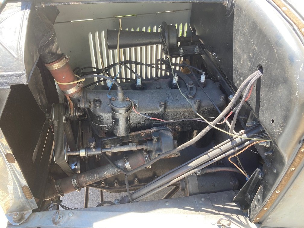

Interesting: no terminal block on the firewall. Strange wiring issues.

I agree with the above. I don't see any coil box bolted to the head so I'm guessing that you have a distributor car. That most likely means that the magneto is bad. You have a choice - either you have a fair amount of work on your hands , or you can just have a fun driver. Either way is OK.

If you are going to drive it, leave the carburetor you have. Add what is needed for 26. Vaporizers were used because gasoline was such poor quality. They dont allow a t motor to use its full potential, in my experience.

My apologies, when I say original I just meant the throttle rod, I am going to keep the Holley NH carburetor and it does have a distributor.

No. you have the correct heat pipe. There are after market air filter kits available. If you do a lot of dirt roads, might be a good idea.

I would ditch the plastic fuel filter. If you want to run one, get a metal filter. Plastic that close to hot exaust manifold can melt or crack.
There was a plastic line and plastic fuel shut off on mine when I got it. After two trips (1/2) mile total the line crystalized and was leaking gas.
Looks like a nice car you have. I look forward to progress you post.

Unless the entire fuel system was drained, you might have some fuel blockage. The sediment bulb at the outlet of the gas tank, if in good condition, and the screen is good, should be enough to remove the small particles or small amount of condensation from the fuel system. It should be drained from time to time just to keep the sediment out of the carburetor. You really don't need an additional fuel filter, in fact it could cause starvation on a hard pull. It is also important to find out what voltage your ignition system is so you can use the appropriate battery. If you have a battery higher than the 6 volt battery which was standard, you could also have problems over time with the starter, which, if original equipment was made to work on 6 volts and it will slam into the flywheel very hard and will eventually be damaged.

As others stated, the throttle rod going over the head is correct for your car. If what on yours looks like a home made conversion for an NH does not work well, the vendors sell one that may work better. https://www.modeltford.com/item/6299CL.aspx
