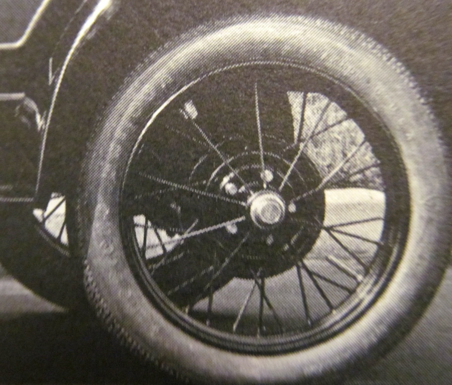

Just to add a bit on the dust caps. The wire wheel used 3" long dust cap, as the standard valve stem stuck up higher since no thick felloe , like the wood wheel has.
Note height of the dust cap
