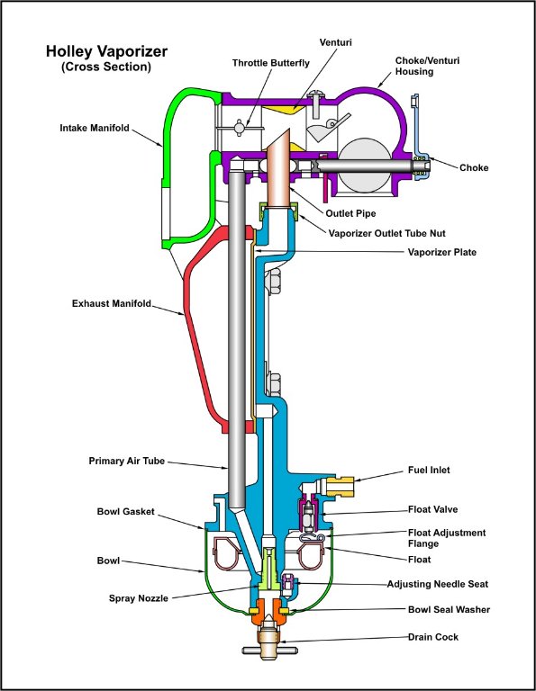

The vaporizer requires generous use of the choke as the fuel has to be sucked up a long distance compared to the NH carb. If the previous owner started it and drove it on the trailer, the carb is fine.

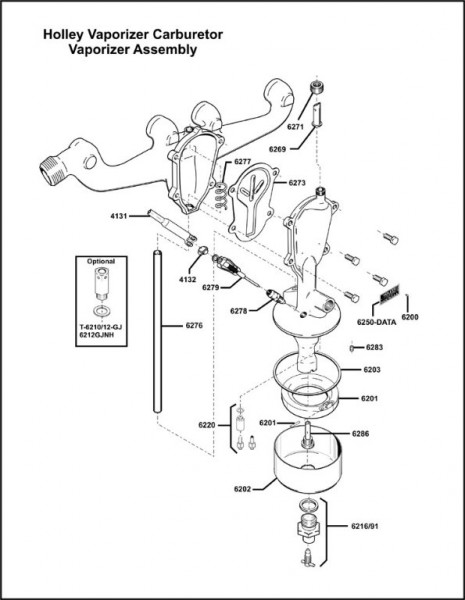

Yeah, choke the hell out of it. If it has compression, spark and vaporized fuel, it should start. After the grandkids had their rides, remove those 4 bolts from the outside intake manifold and inspect the sheet metal plate between it and the interior intake manifold. Sometimes it’ll burn and/or rust real bad allowing air leaks causing hard starting.

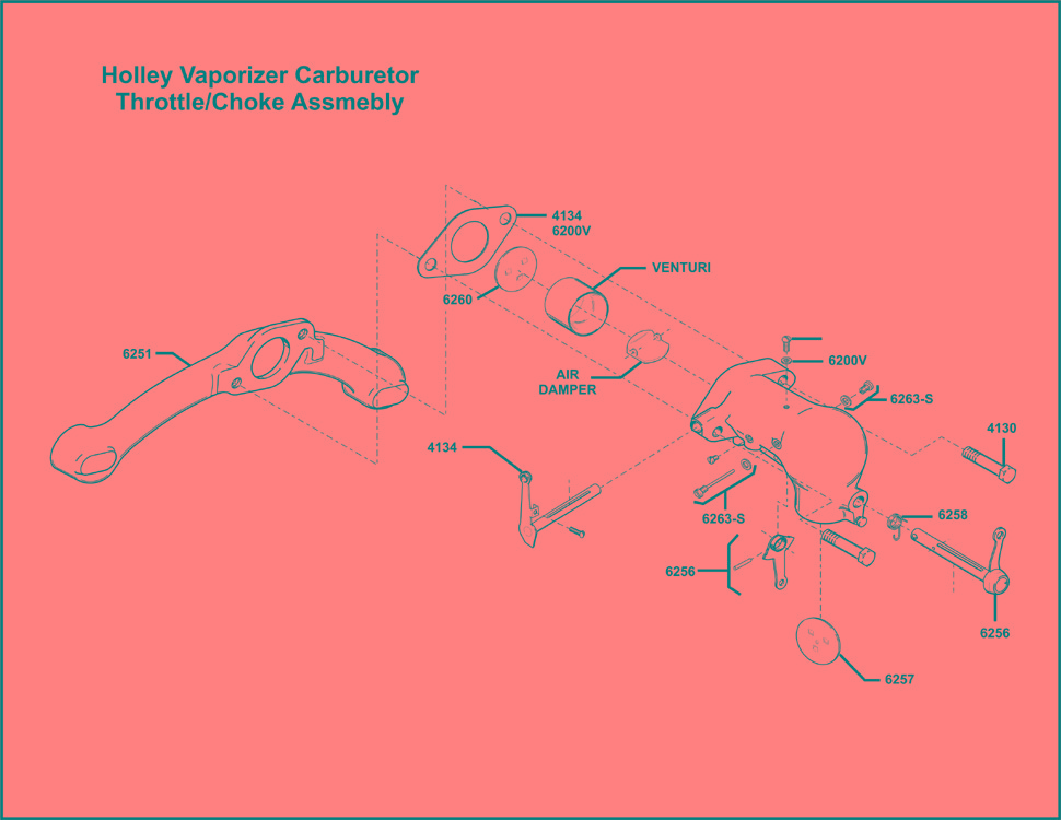

Be sure the gas is turned on first, there is a lever on top of the firewall filter that turns the gas on and off. Do choke it, when it starts and smooths out leave the needle where it runs best. You adjust it by turning the choke rod. The vap will give you good service.

check your drain plug that hold on the fuel bowl. It should not have a hole in the top like earlier carbs. If it has a hole it will try to start but will just fire and quit. I fussed for a week until Russ Potter straightened me out.

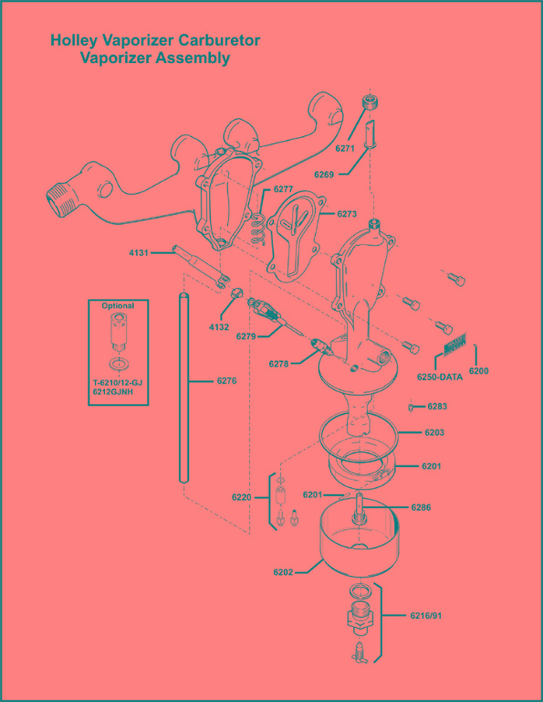

Sometimes the plate 6273 gets small cracks in it so the carb won't function properly
