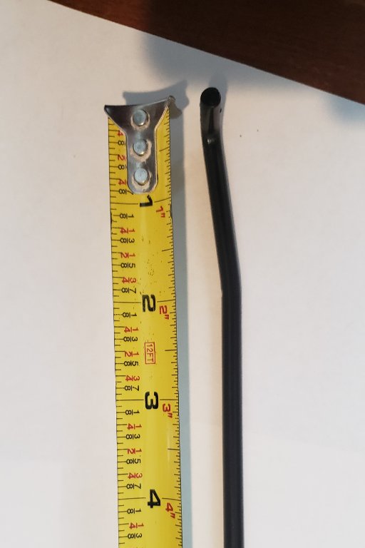

Happy Independence day weekend to all! I have a question regarding the throttle rod running through the block from the steering wheel to the carb. This is on a 1924 model. There is a distinct bend of about 10 degrees a little less than 2 inches from one end. My question is: Does this end go to the carburetor or the steering column? I am thinking the carb but wanted to try and find out for sure but the service manual does not mention it. Thanks and enjoy your weekend.
[/size][/b]

The bend goes closest to the steering column
