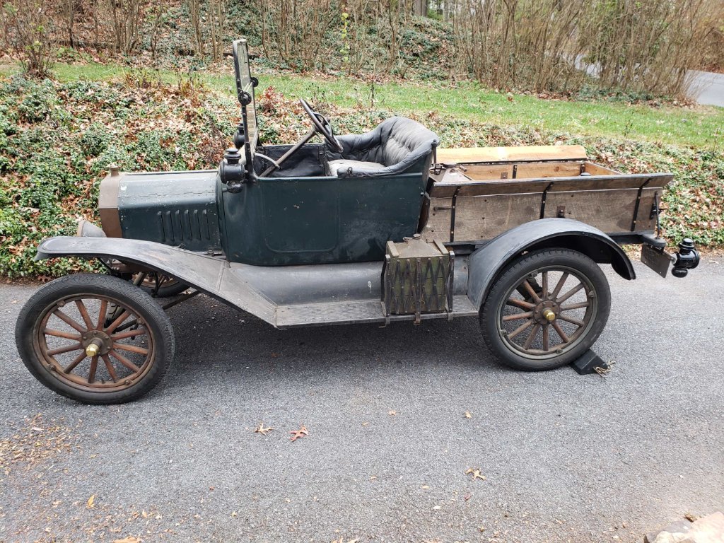

It's a bit late now, but your bed could have been a foot longer. Yours terminates in front of the fenders. The red one finishes well behind. I made the same mistake when I built my first buckboard. If you could shift the whole tray back on the frame, that would give you a nice space between the body and the tray for your toolbox.
I love the way you have used full width boards in the construction. So many times undersized lumber is used and it takes away from the looks of the original construction methods.

You did an excellent job fabricating the box. I would like to buy a roadster and do as you did. Sort of to the replace the one my father had in the 20s and 30s when he had a auto repair garage.

I like it. Are you going to paint or varnish?

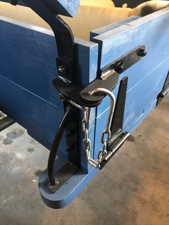

Beautiful box. I love the toolbox idea. I bolted a toolbox on the running board, but it would still be nice to have another place to put some other items. I painted my box, but the wood wasn't nearly as nice as yours. here's a picture of my tailgate latch for reference.

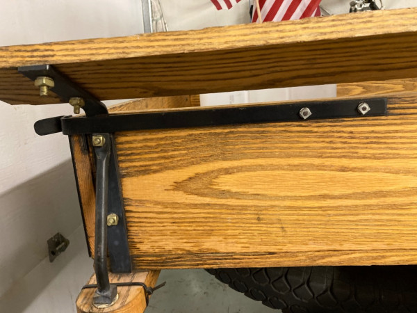

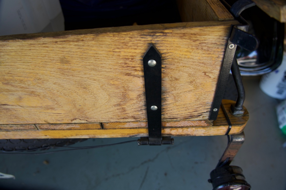

Last one. I made my box out of Oak about 10 years ago so it's not as pretty.

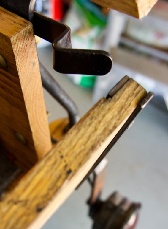

Dean, Just a 1/16 X 3/4 x 15ish strap from Ace. That is enourg "spring" for the aplication

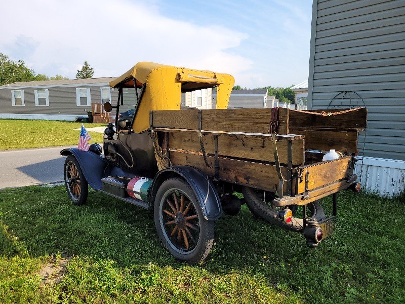

My Henrietta cut down tourer buckboard has the top made from the bows of the original. It no longer folds, so that made the modifications much easier to achieve. You just need to set the intermediate bow at the right height and set-back, and fix it in place in a manner that suits you.

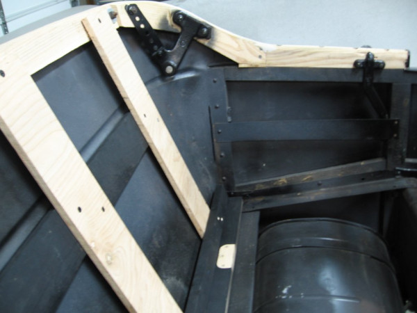

Here is what I did to install a one-man roadster top onto my cut-off touring / pickup. The process might be slightly different for an earlier two-man top.
I found a set of one-man roadster irons and rear brackets online, then bought new top sockets and bows from Lang's. I bought the top kit from Classtique. The seat back upholstery hadn't been installed yet, so I had clear access to the inside of the tub.
The angle of the ears on the rear brackets didn't match the tub, so I had to cut off one ear and fabricate a new ear from some strapping material for the bracket to fit properly. I also had to add shims to the remaining bracket ear to get the angle of the pivot irons right as they came through the body.
The scariest part was cutting the holes in the body for the top pivot irons to poke through. I used a long rod between the rear brackets to locate where to drill the pilot holes in the body, then finished with a hole saw.

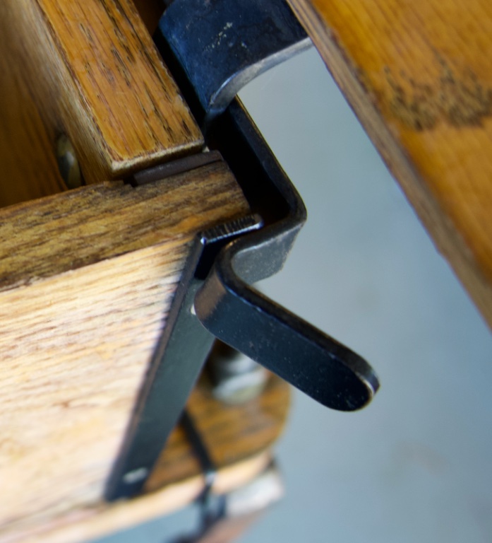

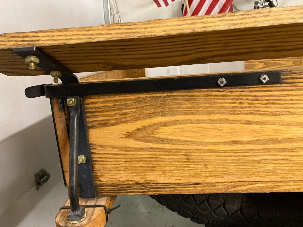

Dean: What is the source for your tailgate hinge hardware? I'm in the process of building a pick up box.

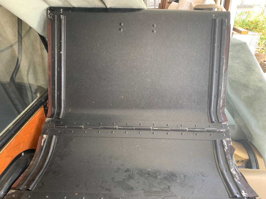

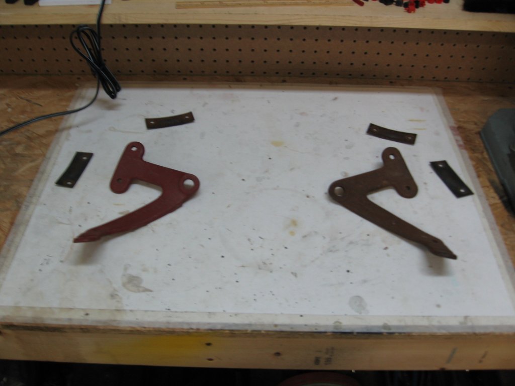

Does anyone have pictures of underside of above type hood showing correct position of leather lacing
ewdysar
- Posts: 372
- Joined: Wed Jan 09, 2019 6:48 pm
- First Name: Eric
- Last Name: D
- * REQUIRED* Type and Year of Model Ts owned: 1914 Touring, 1915 Speedster #32, 1916 Touring, 1927 Runabout
- Location: Greater Portland area
Re: This weekends project (touring to pick up)
It’s not “lacing” like the later style hoods that have woven padding threaded in-and-out on the radiator and fastened flat to the cowl. The brass cars use leather pads on the underside of the hood panels, slipped into a crimped channel like this…
There are little “barbs” that can be set into the leather with a small punch or the edge of a screwdriver to secure it better.
Thanks for asking the question, because you can see in the pic at the lower right, on my ‘14 touring, I need to fix that pad to protect the aluminum hood, right at the top curve of the radiator. The top right front channel and the front segment of the hood center hinge, formed from the top right hood panel are currently buggered up (by the previous owner) and the front channel rivets need to be tightened to get the hood, channel, and pads to lay better. Luckily, the exterior paint is not the greatest, so the touch up afterwards won’t be too critical.
Keep cranking’
Eric
Keep cranking’
Eric

You are converting a 23 to a 15 ish with an unusual, aftermarket radiator. Trial & error.Caswell wrote: ↑Mon Jul 26, 2021 9:39 amDoes anyone know the correct thickness of leather pad that goes under radiator mounting tabs ? I'm having alignment problems with the hood.
Hope to get the fender irons made today for the rear fenders. Also may install a flat bottom instrument dash as I have a NOS one, I know for the year style I'm going for it would not have one at all but I don't want to change the coil box/ignition switch etc., back in the day it may have been an upgrade anyway.
As a side note when I installed a new pitman arm on the steering a few months ago I used aluminum anti seize in the cone and woodruff key (spelling) area when it came to removing it a week or so ago it came right off with a light tap of the wrench used to remove the nut.
So close to removing the balance of original body and building the cab section in picture below and combining it with the rear I have already done.
