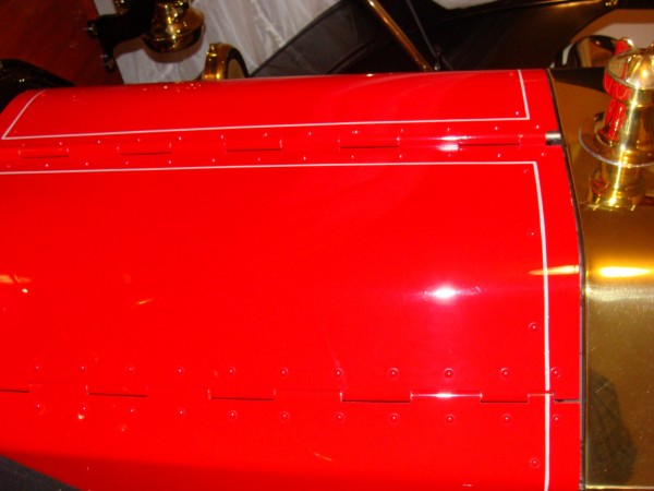

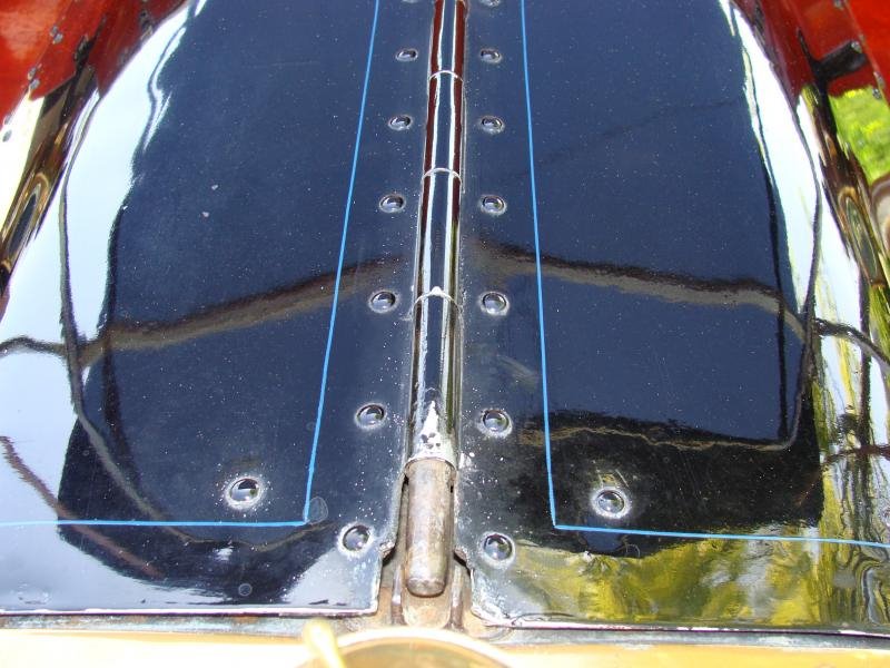

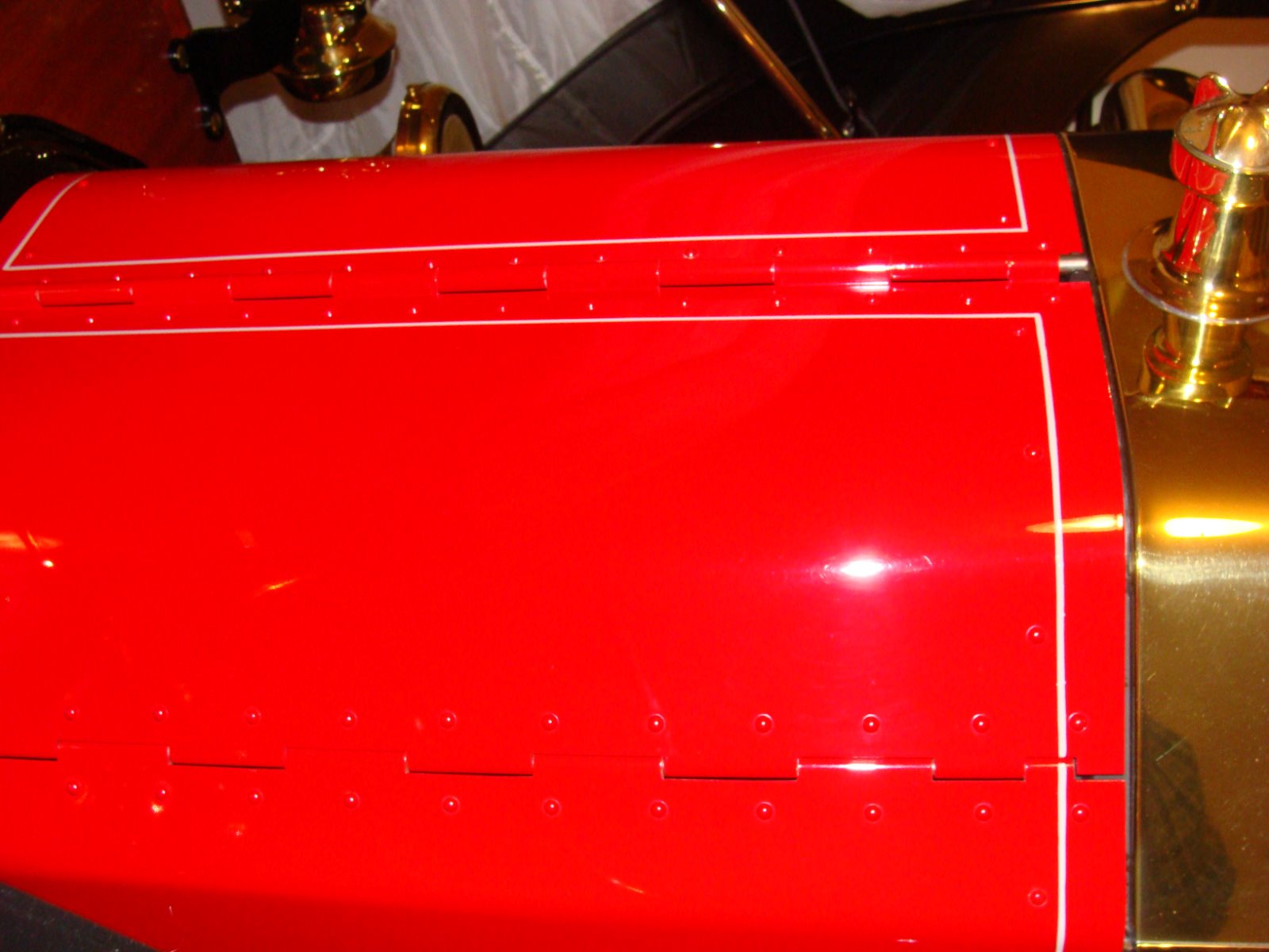

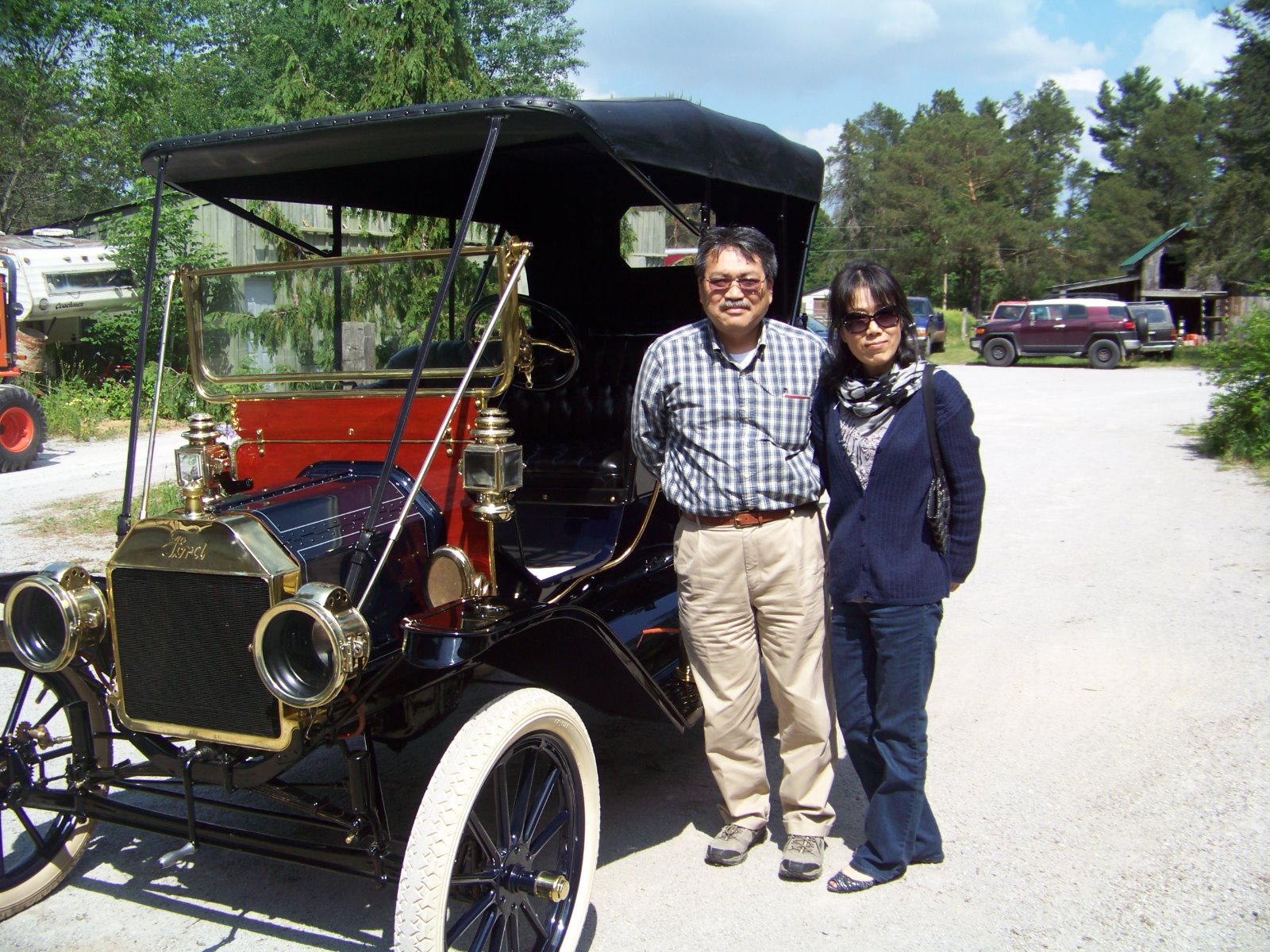

About 3/4"r form the outer edges, straight up the front, along the center hinge, and down the back.
Sometimes across the bottom.
NO BOXES!

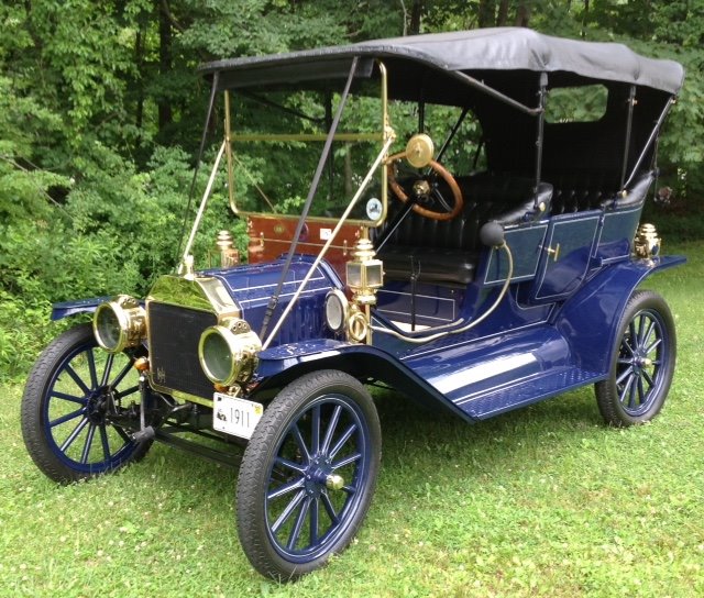

NOT like these:

Very interesting! And here I thought there were boxes, because every early T I've seen pictures of (after restoration) they all have the areas boxed in with pinstripes. That original picture sure makes it clear - thanks Keith!

I agree with Keith look at the original photo this is correct. Mark Cameron has restored some great early cars, they where not striped in in box pattern. There is a great photo of Henry Ford in the early photos section (1912) it shows the hood with original stripe this is a 1912 but great reference too many restored cars are not correct. The photo of Henry Ford also shows the removable front door stripe.
