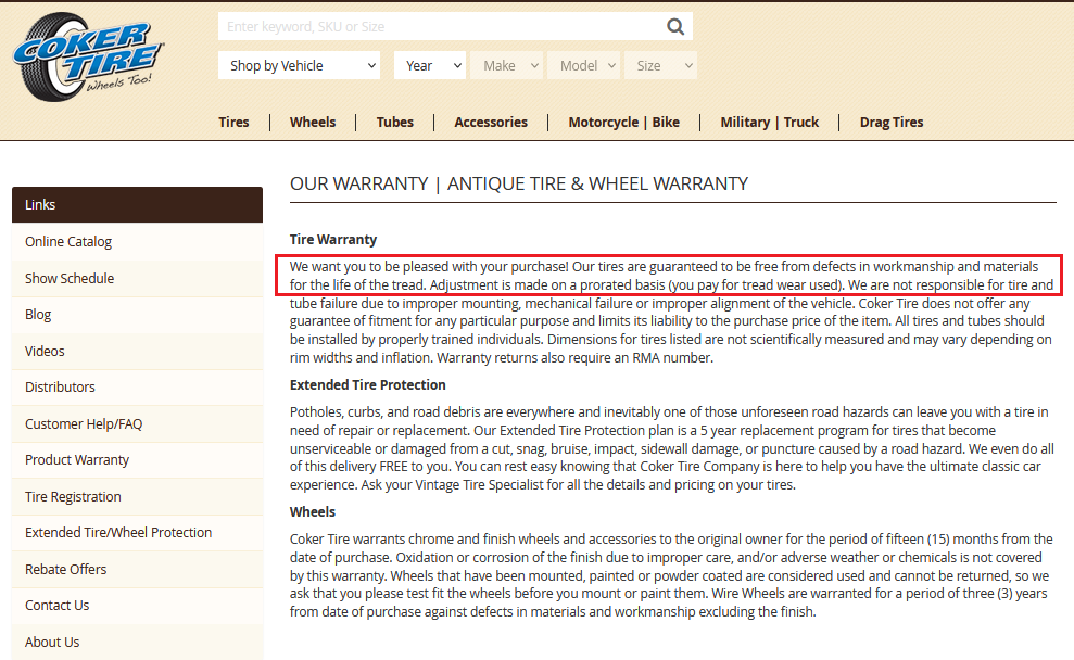

Start contacting seller or Coker. Ask them to help you resolve the issue, describe the problem and the say "several members of the Model T Ford Club of America" suggested that I follow-up on the warranty. That should get some attention.
Don't try to remedy the situation and don't put anything on it - they'll say that the product had an adverse reaction to the rubber on the tire

Find your sales receipt and if within a year from purchase, return at your expense, or live with them.

Got a resolution from Coker Tire today. They will replace them at no cost to me. New tires will be shipped in September and I can send the cracked ones back to them then. Nice customer support!
