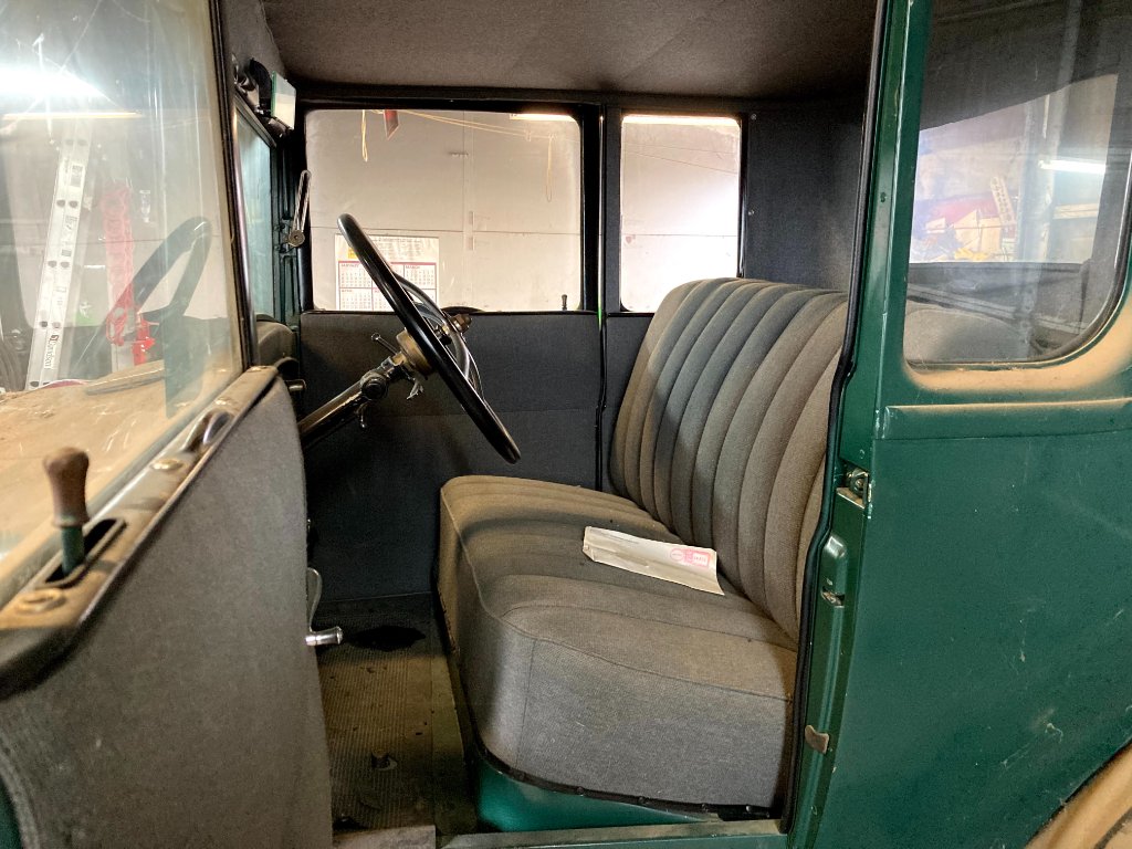

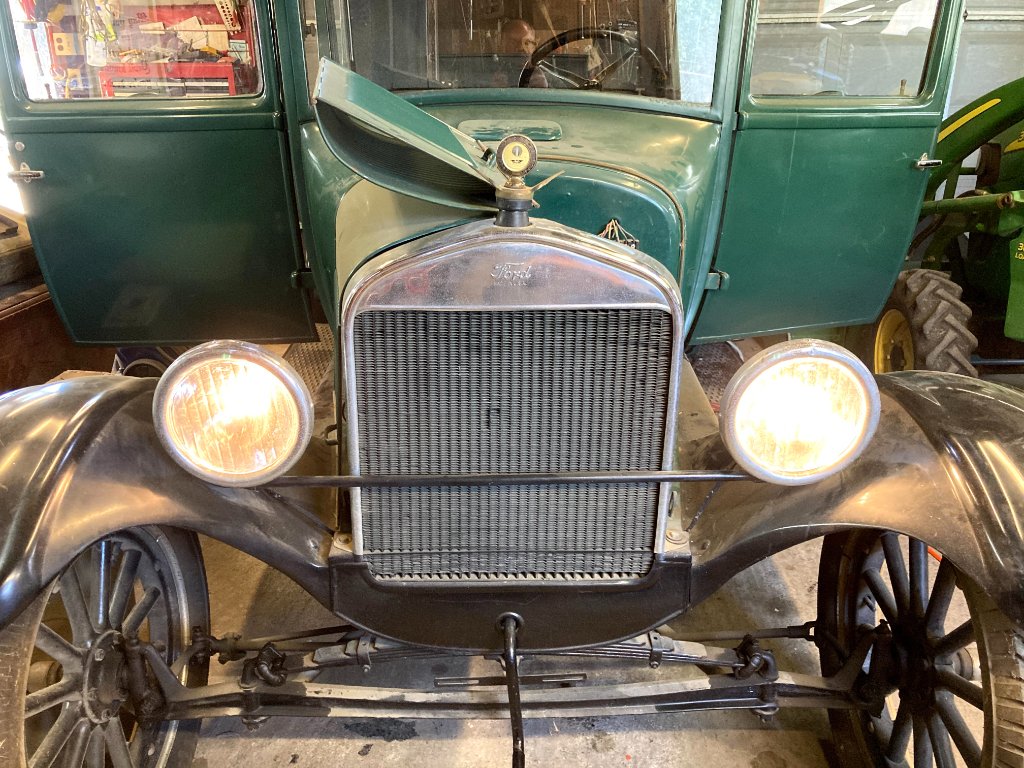

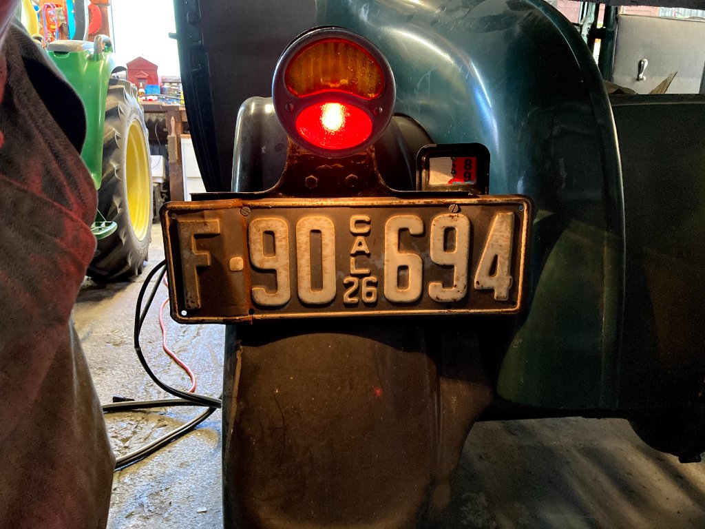

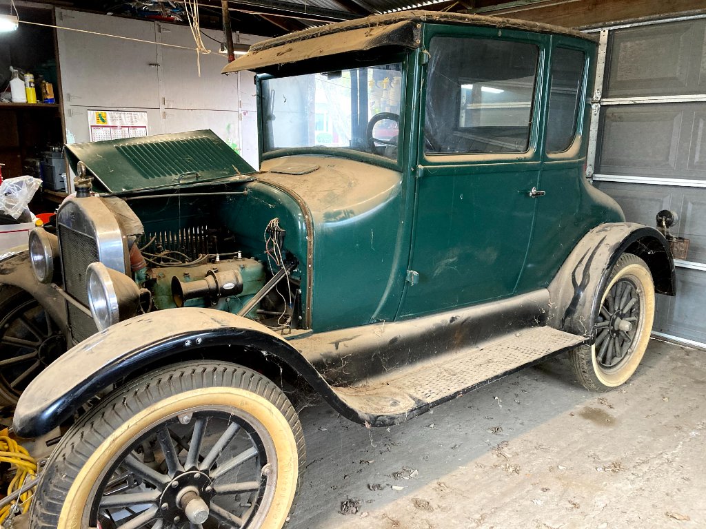

Hello from Northern California. I just joined your sight and I am excited about learning from all of you. I will share what little I know (should take about 30 seconds). I have a 1926 Coup that my father purchased many years ago. Over the next few weeks/months I will be working on getting it back on the road.

Welcome to the group! You will find lots of help & opinions here, not always in agreement. We're a friendly bunch and always ready to lend a virtual hand.
Your coupe looks like a good solid car, you have a lot to work with right off the bat.

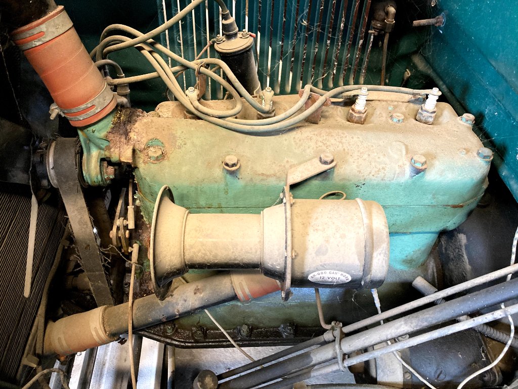

Very nice start of a running car.
I see that the horn indicates 12v but I would not assume that everything has been converted over from 6 volts.
The thing to be the most careful with is the starter as it may still be 6v.

Hi Jeff, welcome to the affliction! As has been said earlier, there are different philosophies as to what constitutes a "true" Model T. I too noticed that yours has a distributor; that usually means that there is a problem with the magneto. If the problem is beyond a recharge, I would stick with the distributor until you have another reason to pull the engine and hogshead. At that point I would rebuild the magneto and ditch the distributor. An operating magneto is a significant part of what makes a model T a Model T. Do a safety check ASAP; the MTFCA has a checklist of the things to check/repair. Most of the parts that you will need are available through the various suppliers of T parts. 1926-7 gas tanks are hard to find, but their was a recent thread that someone is making them again. Good luck with your new friend!

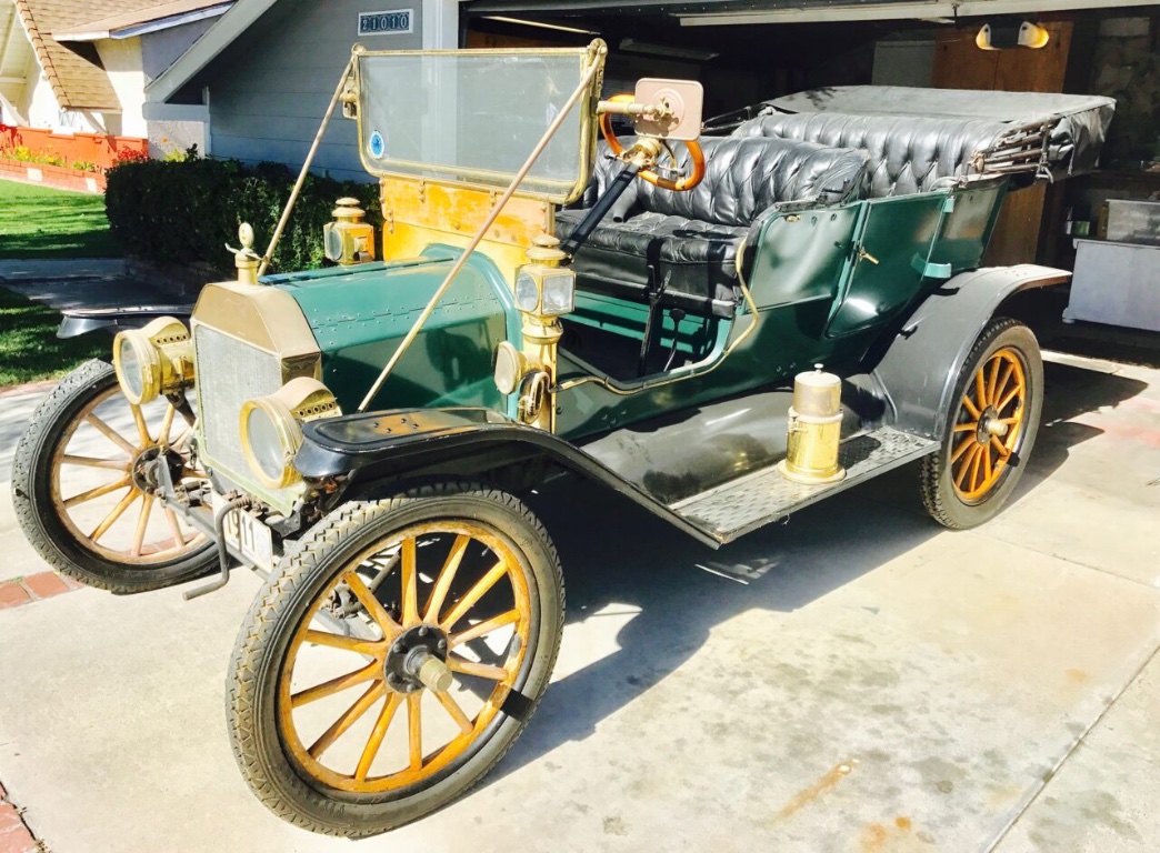

Welcome Jeff,
You have a nice car there in Tracy and have started a useful thread here. I too am relatively new to this club and to the Model T hobby. I live in Marin County, and am in the process of buying this 1911 Ford Touring "project" which has been just sitting in a garage for 3 years. I am watching the replies to your post with interest and expect that other Northern California Model T-ers might run into to you if you plan on coming out on one of our local driving tours once your coup is back on the road.
Steve

That is a gorgeous machine Steve. Can't wait to hear how your project progresses.NorthSouth wrote: ↑Tue Jul 13, 2021 6:38 am-

Nothing like a nice paint job well protected by a layer of barn dust. Whitewalls with air in them too! Good start.
