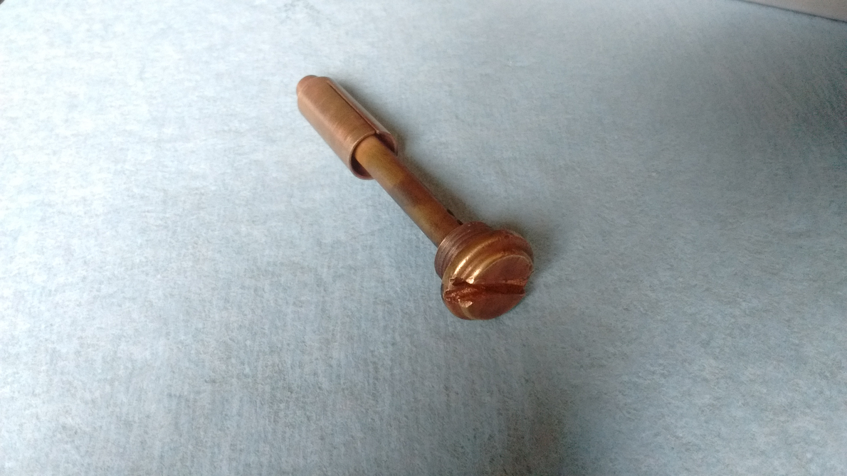

I just couldn't put this butchered part back into a nice OF, so spent a little time and made and then installed a new head...
from this:
to this:
Making the fixturing took almost 2 days, but I think it was time and effort well spent. Future jobs won't be difficult or terribly time consuming at all now that the tooling is in place, though I may never need to do this again (but I bet I will).

How is the shaft attached to the head? Press fit?

It is a soldered union
