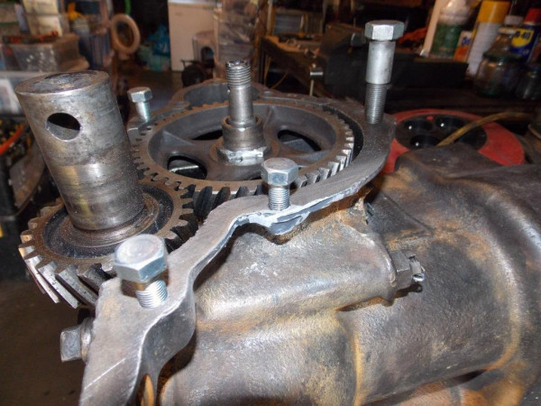

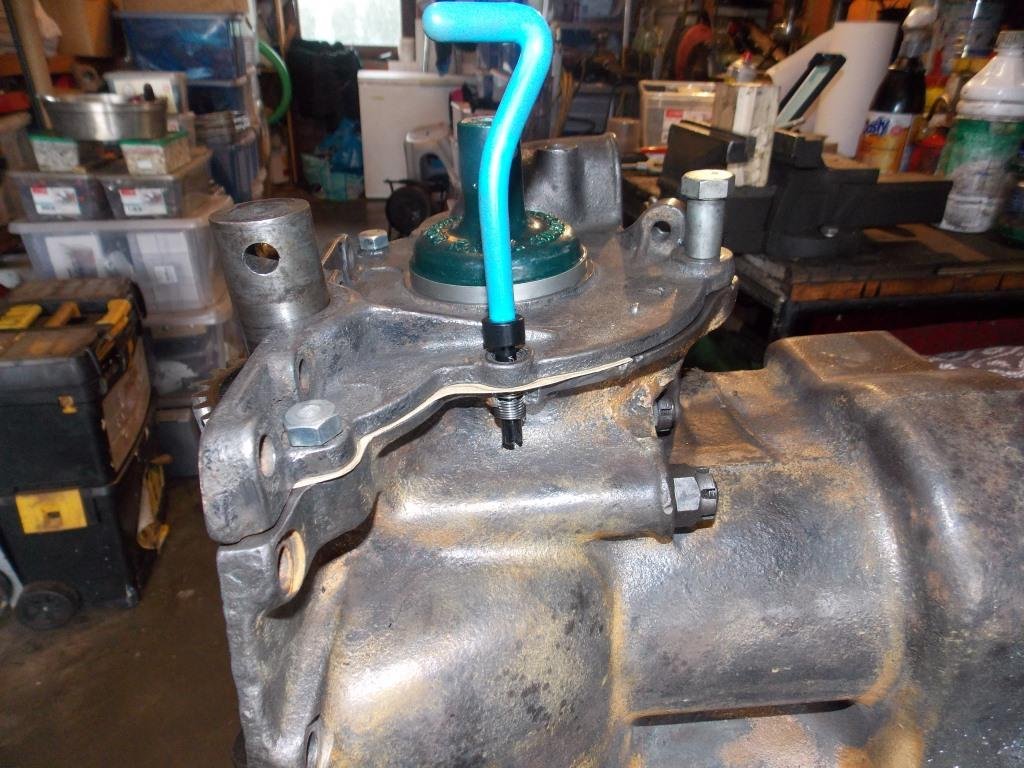

I've been helping my friend (as he helped me) with the 1922 Model T he acquired recently. All had been going pretty well until today. The fan that was installed when he bought it was a 26-27 which was a poor fit for a low radiator. He bought the parts to convert it to the correct fan which also required changing the timing cover.
We got it all apart, scraped off the old gasket and gunk and discovered that the threaded hole in the casting where the fan arm attaches had been chipped out and filled with J B Weld or the like. When he tried threading the correct bolt in place and putting a little force on it the J B weld cracked.
Needless to say, the excitement of owning a Model T has taken a serious hit as my friend contemplates what to do next. Can it be repaired? Is the block scrap? We'd love to hear from anyone who has a suggestion as to how to deal with this problem. The arrows on the photo show the area that was filled in. About 2/3 to 3/4 of the original threads remain. Maybe now we know why the previous owner moved the fan mount to the upper elbow......

Now you know why a previous owner installed the later fan setup. Here is my off-the cuff idea, no guarantees.
If there's enough room on the back side for a washer and nut, you could try using the nut instead of the casting thread to hold the fan arm bolt. Once you confirm that the fan arm with the bolt and nut will hold, you could then re-apply the JB weld, then sculpt and paint it to make the casting look whole again.

A big fat maybe....worth a try.
I have used it and drilled and tapped it before.
https://www.walmart.com/ip/Q-BOND-ADHES ... lsrc=3p.ds

UCK. I would not consider the block scrap. I might consider staying with the 27 fan mount, even if trimming the fan blades is necessary. Possibly a smaller belt so that the pulley is as far down as possible.
Possibly cut a 1/2" nf nut as a replacement chunk & braze it in, using the nut threads in alignment with casting threads. If you have a really talented welder- mig or tig that chunk in with a bolt in to end up with a usable threaded hole.

I don't see a structural reason to not use it almost as-is
That bolt goes through the unthreaded portion of the timing cover and relies on the block threads to retain it and you say that well more than 50% of the threads remain. That bolt isn't going anywhere and there is no need to whop down on the threads anyway.
Would a reapplication of JB Weld faced back down to provide a surface for Ultra Black be a good idea? Probably, if only to control the sealant cross section and ensure a good and even cure.
If the hole in the cover was a wobbly fit to the shaft, then it would be an EXCELLENT idea to make a custom bushing there to make the shaft a dead slip fit so as to provide plenty of support and ensure that there is no bending moment applied to the damaged casting. So long as the only force the threads see is pure linear tension, you have plenty of threads for the job they must do.
In any event while a surprising find it is nowhere near a disaster.

I have used a product in the past called "Liquid Metal" that comes in a tube and you apply it to a VERY clean surface. It dries hard and can be shaped with a file, sandpaper, etc. It is as hard as metal when dry. I can't remember if I got it at a big box store or NAPA Auto. Still holding for me and I applied it 8 years ago.

Scott, please help me understand, in the first picture the timing cover is off since we can see the gears - isn't the smooth surface we are looking at the front of the block?

there is no oil seal issue and the epoxy would be entirely for cosmetic reasons
center the thing on the timer and be done with it. Once snugged up I don't even think there is a moment-arm stress worth worrying about

I agree with Scott. Doesn't appear that enough of the block/threads/ear is missing to present a real problem. I'd build up the missing metal with JB once again, file it flush with the surrounding surface and button it up.

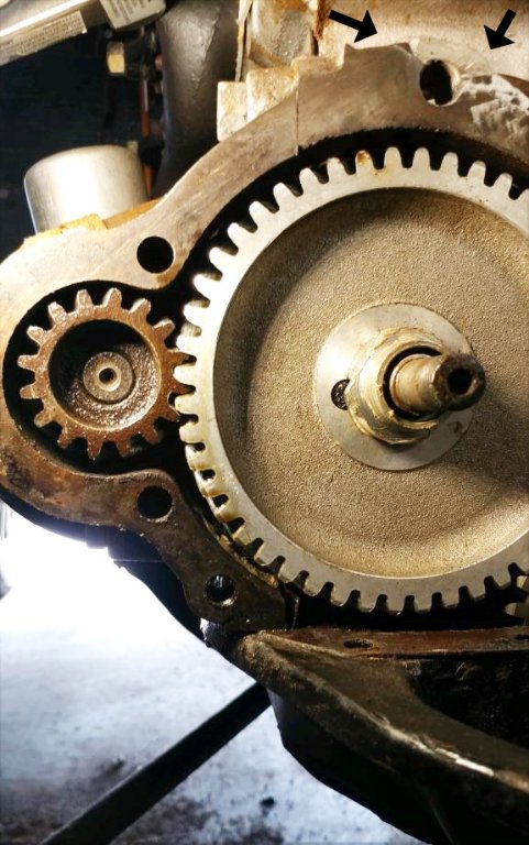

As an aside, the generator gear looks very worn. I'd have a good look at that...

Jerry - with the limited angle on the generator gear, what is your clue that it is worn?

- Posts: 4508
Re: Oh Crap!
Tim,
The shape of the gear teeth appear to be "off". The teeth look a bit narrow and the shape of one side of the teeth look flatter than the other side, with the flatter, (i.e. more worn side), being the "pressure side", that the timing gear pushes against. Just something to check out.

YES the bolt hole for the fan bolt can be repaired! I have a 1919 Roadster that had the same location as yours broken off. Only mine was more than yours and a little more than half way.
I used a nickel welding rod and welded up the area a little at a time and built up the area till it was welded in a rounded profile. I then shaped it with a small hand grinder.
I then bolted the timing gear cover back on to get the center for the fan bolt. I center punched the center, drilled and tapped the new hole and all was well. That was almost 25 years ago and all is well.
DONT throw away the block! It can be repaired.
Your block has enough metal where you can use JB Weld to build it up enough to be able to use a washer and nut and would be OK by the looks of it. I would use a washer on the the back and use JB Weld to hold it on first. Then after it dries fill up the rest and carefully drill with cover bolted in place to get it centered. and then tap it. Install the cover, and use a nut to help hold it on. You should be OK.

All, I definitely think a nut or threaded piece of steel needs to be fitted to the back side of the flange and secured in place. I think we can pull it off and will report back when it's done. Thanks!

That block is a VERY easy repair for any machinery repair welder worth his salt. Repaired many castings such as that over the last 40+ years. Just need to know what welding rod to use. (NOT epoxys, those just make it harder to do it correctly). Brazing can work too, but requires a LOT more heat. JMHO Dave

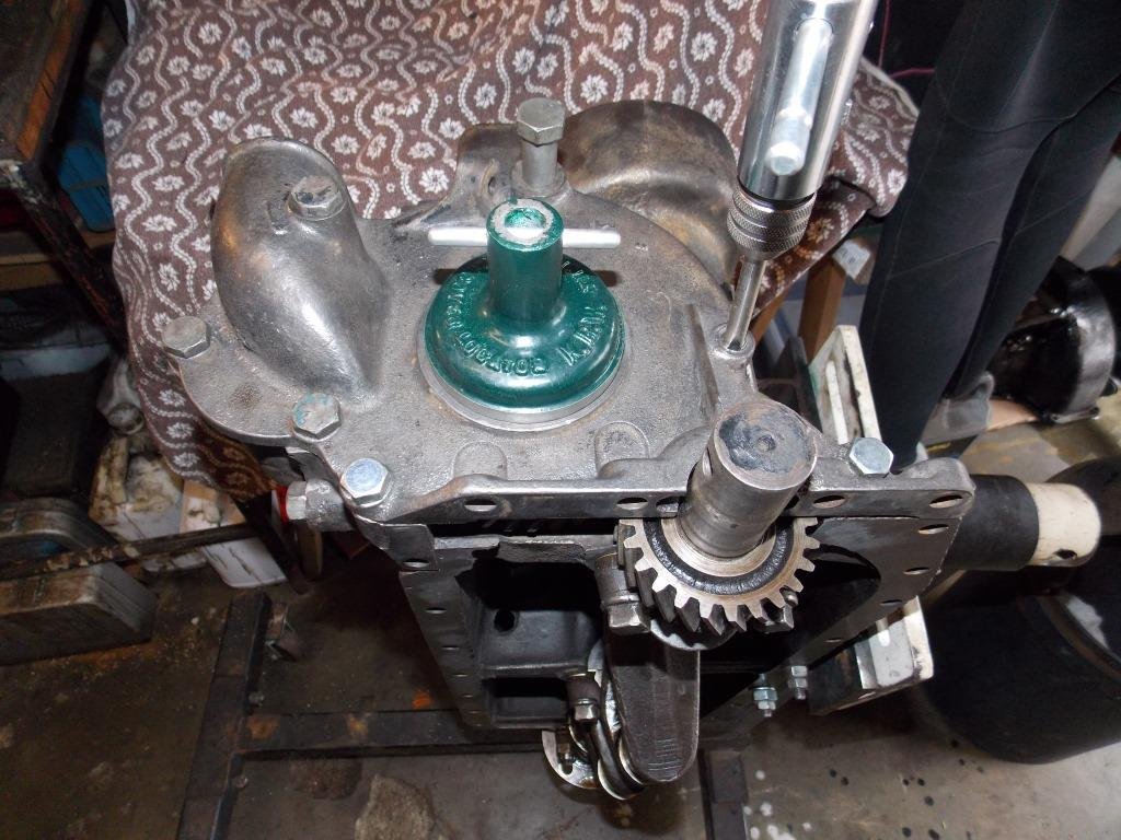

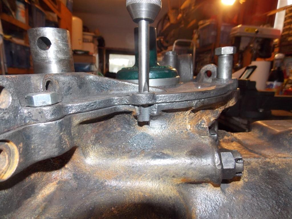

Here is how I did a sort like repair on the cover.
I used a heli coil and J&B weld.
