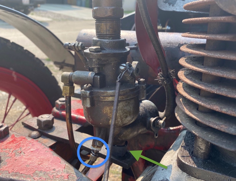

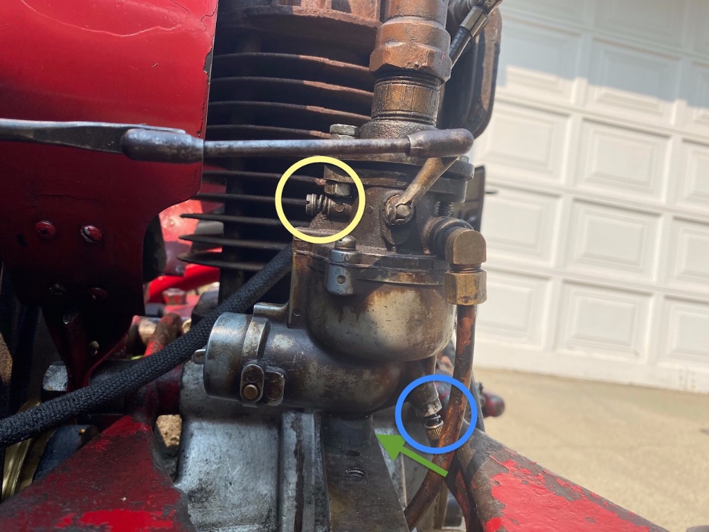

I've owned this 1906 Orient for many years. It came with the original carb and a selection of miscellaneous small-engine carbs. The one shown in the photos below was on the car as acquired. I did experiment with the others back then, including the original, and this one worked best. "Best" in this case meaning least unsatisfactory. My understanding is that the original carb dated to an era when gasoline was far more volatile, and will not work satisfactorily with modern fuels.
Anyway, I'm hoping someone here will recognize this carburetor, and have experience/suggestions as to proper adjustment. As is is, the choke needs to be mostly closed for the engine to stay running. Two adjustment screws: yellow and blue. The green arrow points to a bit of heater hose that keeps the carb from vibrating at the end of its long intake tube. Fuel seeps out from this area when starting.

It is nearly certain that the upper adjustment is an idle mixture screw and the lower is the main jet. If it only runs with the choke mostly closed, there is an obstruction in the idle circuit which requires a huge vacuum level to pull up fuel from the main jet. This would be true if "wide open" (what ever that entails) will run with minimal or no choke (and the main jet is not clogged, too)

Looks like your carb. is from a early 10 horse Briggs and Stratton engine.

For Chris's issue. Take a close look at the inside design of the carburetor. Some of these early carburetors are essentially constant cross section air passages which do not develop the needed negative pressure to pull the gas into the airstream like later venturi carburetor design. Several of them used a spring-loaded air valve on the inlet end of the carburetor. The spring was a very light spring with a thumb nut for adjustment. The carburetor needed to be adjusted to produce a small negative pressure in the carburetor body to pull the fuel into the air stream.
It may also be possible that the fuel inlet port/needle passage is too small a bore to pass the needed fuel for this engine at the speed and inlet air pressure that it operates at. I would also suggest checking the fuel path for possible flow restrictions.

Jim Sims had the key to getting this thing on the road today. There are a wealth of videos and pages dealing with Briggs and Stratton carbs, and while the newer ones look different the adjustments same the same. And similar in fact to Model Ts, in that the initial settings are 1-1/2 turns from closed and fine tune from there.

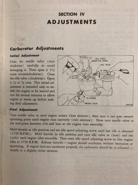

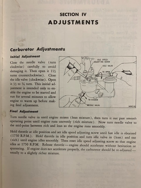

[attachmeTry this. Not to exact BS carb, but all of that style adjust the same. Hope it helps.

I would ignore the fast idle rpm spec when using that carburetor on a 1906 Orient...

This was out of a B&S engine manual. Only posted for to ID as to what did what on that type of carb. Dan
