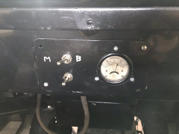

Two 3 way switches as pictured are becoming ever more appealing..... thanks Scott for the link.

Bummer..... you just sealed it... two 3 ways it will be.
Any advice on switches[load capacity)? I'm mechanical but electrically dumb.

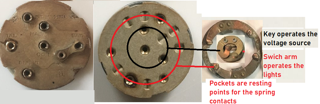

Here is what the switch internals look like. As stated above the inner switch contact ring that rotates between the MAG & BAT contacts only makes contact with one or the other. Can you explain how/where this jumper is connected "My car runs with a jumper from battery to coil and key off." and how you disconnect that voltage source.

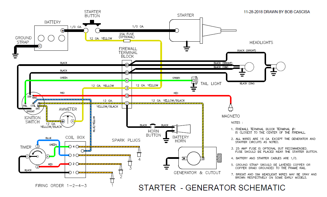

Long shot - does you coil box have just one post for voltage input or one for Mag and another for Bat? Looking at the wiring diagram and the picture of the switch, if wired correctly, not much chance of continuity between MAG & BAT. A "bad" switch usually makes no contact, a shortage, rare, could result by over lubricating tumblers with graphite and having that work its way into the steel cup that holds the switch internals. The switch internals don't need lubrication once assembled. The key contact is directly connected to the tumbler and doesn't really ride on anything. The light contact ring does ride on the bottom of the steel cup and could wear, but I have lots of these and none show wear. Usually the steel cup does.
