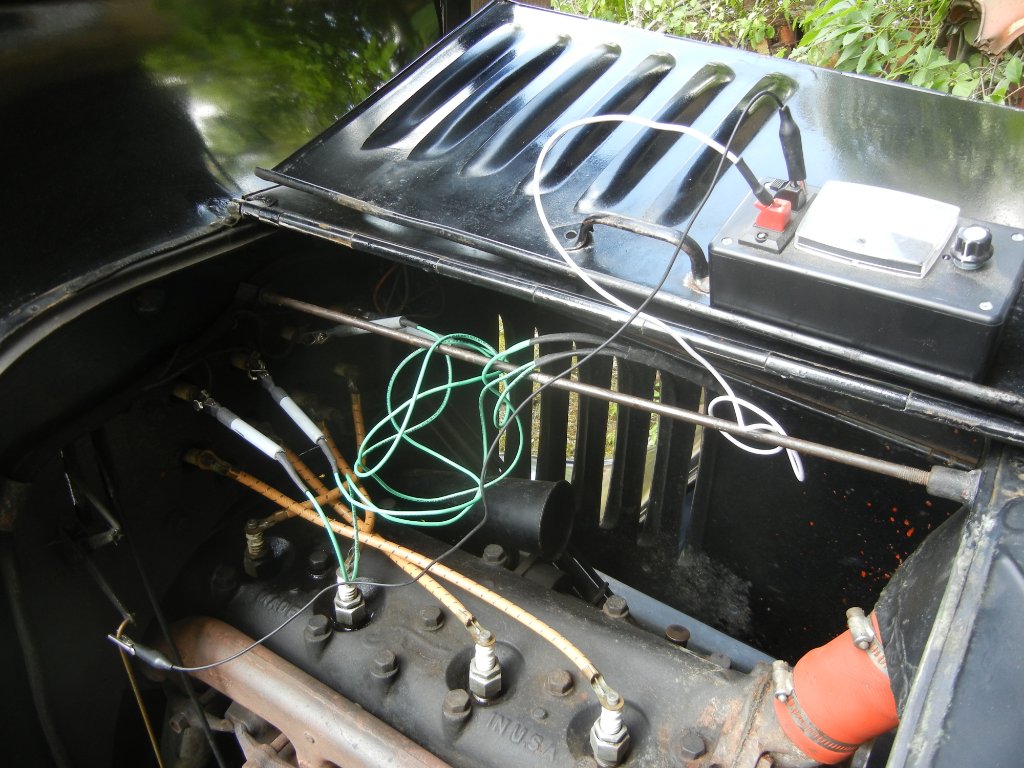

Constructed an analogue meter that indicates which coils are firing, or not. Indicates both battery and magneto operation. Simple . (diagram from Ford Fix)

What’s the jumble of green wire?
How does it work?
How does it work?

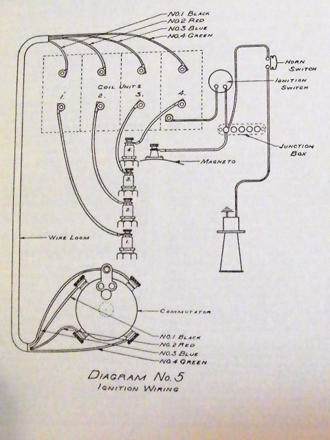

The Ford Fix diagram fails to show how/where the meter is connected. Also, there is no mention of the type of meter being used. More information is required.
If you have to connect the meter for EACH coil, I agree with Andy, it would be quicker, less expensive, and more simple to use a screw driver to check spark at the end of the plug wire. You then can rule out everything up to the spark plug.

The ford fix diagram is to show how the coils are wired for a Model T using a mechanical timer. The meter shown is based on a Radio Electronics, August 1966, article by Duane Sweet, Simplest Tachometer/Dwellmeter. The question - "What’s the jumble of green wire?" - is answered by having each of the wires connect to the timer side of the coils, as the coil is excited it sends a pulse to the meter as an active coil vibrates. The ford fix diagram has terminals from the timer, 1to 4, and that is where the green wires attach with clips. The probes with the clips are designed not cause interference between coils.

This is the device in the first photo of this thread.

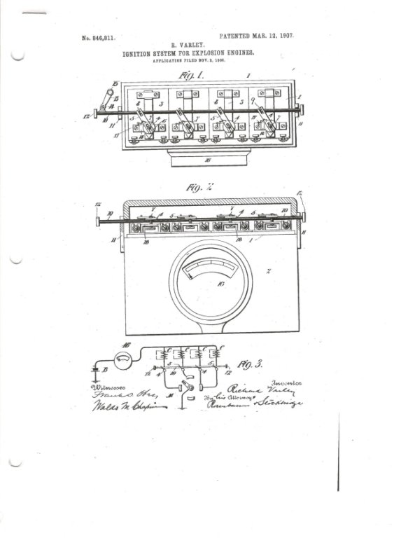

[attachment=0]Scan1905metreoncoilboc.jpg[/attachment
It is time to put this discussion to rest.
The purpose or sharing the circuit was to show a way to identify problems with a vibrator or trembler coil. Matter fact there was a 1906/07 patent sharing a similar design.
Varley stated that the quality of current taken by a coil varies greatly according to the adjustment. To tight, large amounts of current, to loose very little current, if not adjusted properly no current and no spark.
I guess the 1906/07 use of a meter was a way to show if a coil was firing or not.

The patent was a setup to simultaneously increase or decrease vibrator tension for supposedly identical and interestingly, user variable current draw. The meter on the box was measuring coil current. Clever but impractical as the operator was expected to slide the bar such that the coils barely drew any current to save the battery(s) and then as power was needed, the bar could be slid the other way to increase current and subsequent spark intensity, which the patent referred to as "power". I would think that driving a car thus equipped would be more work than fun!
As for test apparatus, coil current is not a sure measure of whether or not a coil is actually firing. Anyone who has built enough coils can attest that coils can be rebuilt and set up perfectly with "ideal" (insert your desired value here) and still not have a spark that will jump a gap if there is an internal short. The old time HCCT would and regularly did, prove that out.
So it sounds like you built a device which monitors/measures average current draw of 4 coils or perhaps one coil at a time, I still don't know but it doesn't matter. If that is the case, then I follow what you're doing. I just had a hard time following what was happening.

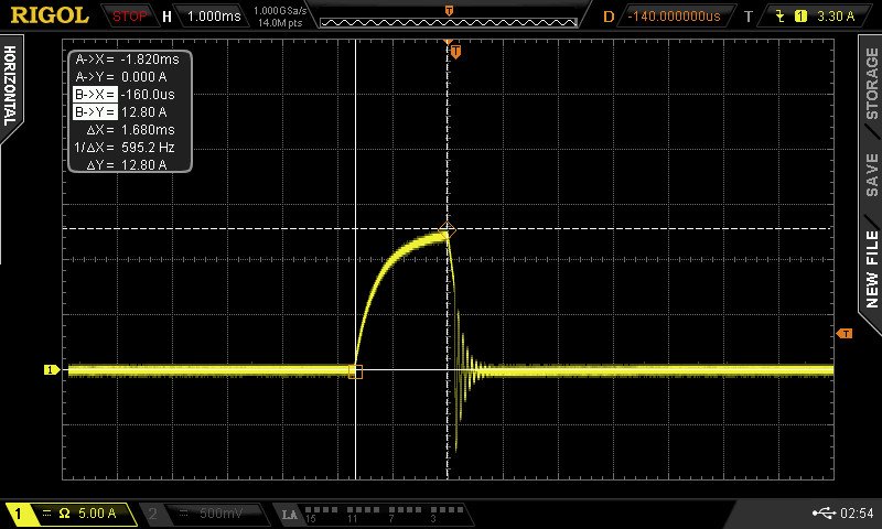

Here is an example of normal Coil operation with proper spark gap. (Each vertical division is 5A, each horizontal division is 0.001 second) Coil current ramps up linearly (straight line) from 0A to 6.4A. The coil magnetic field increases steadily during this time until it is strong enough to pull open the coil points after 0.00186 seconds. The points open at this time which abruptly stops the flow of primary coil current and causes the magnetic field to rapidly collapse and induce high voltage across the coil secondary winging sufficient to generate spark across the spark gap.

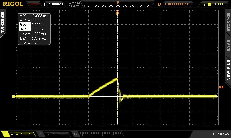

Here is the same coil operated with a shorted spark plug to ground (secondary winding):
Note how the coil primary current rockets to over 10A in amplitude in just 0.0007 seconds because of the shorted secondary winding (loss of mutual inductance). Coil primary current continues to rise but flattens out due to magnetic core saturation. The coil primary current reaches 12.8A (twice the normal amplitude) before the points pull open the coil points to stop the flow of primary current and generate spark. Note that the magnetic field is plenty strong enough to open the points but the vibrator spring and attached contact has mass that takes time it to get physically moving. This test was conducted using a bench power supply not 12V car battery which can supply significantly higher current. Also consider the coil primary coil current could be higher if the coil points are not properly adjusted or malfunctioning (remember, something may not be operating correctly if the operator trying to troubleshoot coil sparking). This is why holding the coil points open using a non-conductive tool would be a better method of checking if a coil is firing spark at the spark plug compared with shorting the spark plug to ground using a screwdriver.

Shorting the spark plug to ground with a screwdriver effectively shorts the coil secondary winding to ground during firing. The shorted secondary winding causes the the mutual inductance of the coil to decrease to very low value which in turn causes a very rapid rise of coil current to approximately twice the typical firing amplitude. The coil mutual inductance is dependent on the magnitude of the inducing mmf (A-T ampere-turns) produced by the winding, and if too large, will cause the iron core to saturate and the mutual inductance effectively reduces to that in air (ur~1). What that all means is the effective primary inductance drops to a very low value which results in the coil primary current rising very rapidly until the core saturates. An example may be helpful to understand this better.Please explain how the primary circuit in the ignition coil is "harmed" by shorting the plug to ground.

Mike:
Thank you for your explanation. However I do not understand the x or time axis. If each division is .001 seconds, the normal one took about .0095 seconds to build up to max current while the shorted to ground spark plug took about .0092 seconds to reach double the amperage.
Am I reading the traces correctly? If so, the time to reach max current(amperage) in the primary circuit for each case was about the same but the shorted plug resulted in about twice the amperage in the primary circuit. Is this summary correct, or am I not reading the time axis correctly?
I have been guilty of shorting spark plugs in the past as I did not realize that the amperage would increase in the primary circuit of the ignition coil doing it this way. Thanks for alerting us to that. Can you estimate what the maximum amperage the primary circuit can withstand for a short period of time?
I guess I will use my plastic comb to hold open the coil points to check for coil operation rather than shorting the plug out with a screwdriver in the future!
Arnie
Arnie

Arnie, The current and time scales in the oscilloscope screen capture refer to the large white boxes on the display. Each large white box is further divided in to 5 sub sections. For example, time on the X axis is 0.001 seconds (1ms) per large division and 1ms/5 = 200us per sub section within that large white box. Current is measured on the vertical Y scale and is 5A per large division or 5A/5 = 1A per sub division.
Sorry, I don't have test data on the maximum DC current the Model T coil primary can withstand. The popular lore is that a coil will overheat and tar melt out if left buzzing continuously on battery, especially 12V battery. That may be the case for poorly maintained or improperly adjusted coils.
I tested properly maintained and ECCT adjusted coil points and found they function to limit the coil current to a safe level even if left buzzing continuously for several minutes from the testing I conducted in this thread: https://mtfca.com/phpBB3/viewtopic.php? ... ly#p157543 although it is not good practice to permit a coil to buzz continuously for extended periods of time.

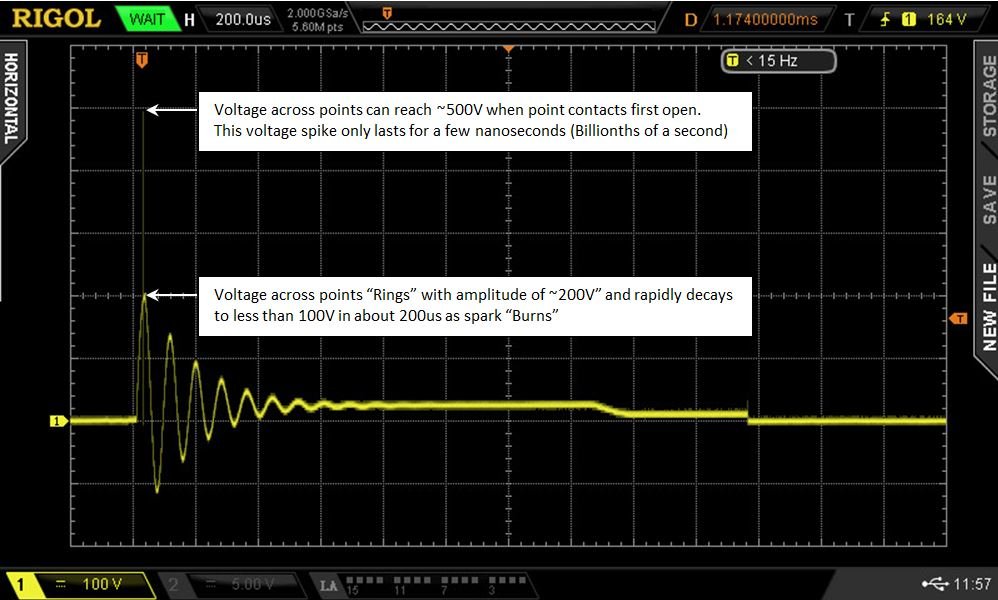

Scott, there is sufficient electrical potential developed across operating coil points to pose a shock hazard. Weather you experience a shock or not depends upon several variables including one's skin moisture/resistance. Good electrical safety practices is to avoid contact with electrical conductors with voltage potentials in excess of 30V and use of safety guarding for voltages in excess of 50V.you can hold the coil points open and will not receive a shock.
Operating coil points that have been properly maintained and adjusted can develop voltages as high as 500V for very brief intervals as spark is initiated and remain at around 200V for longer intervals during the spark interval. Here is some measured data I took to illustrate.
A plastic fork with missing center elements makes a simple and safe tool for depressing the vibrator spring open on operating coil points. Just be very careful to not interfere with the normal opening of the coil points or that too can result in abnormally high coil primary current.
Apologies for the thread drift. For those interested in more details on the Model T ignition coil spark anatomy, see this thread: https://mtfca.com/phpBB3/viewtopic.php?f=2&t=22868
