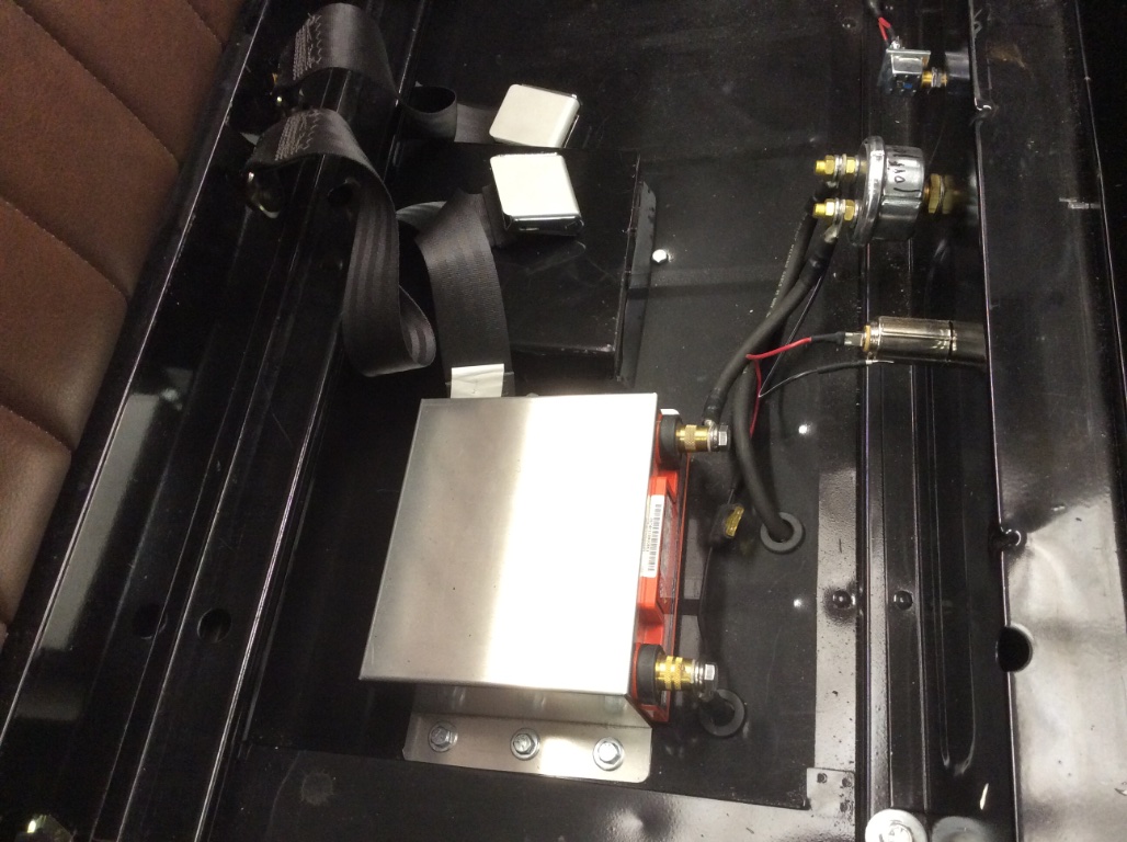

Taylor, on my 1912 van I have a 12 amp motorcycle battery mounted in a separate compartment next to the fuel tank under the front seat. It has been that way for 27 years, and I am on my third battery. It powers the ignition system and indicators and brake lights, works for two days of city driving, and is kept charged in the garage at the end of each day.
If you want to run headlights for any length of time, you may need a larger battery, or LED headlight globes. The ultimate solution may be an Optima battery, on its side, under the back seat. That will even power a starter if you go that route.

An Odyssey PC 680 is a very compact AGM battery. It can be mounted in any position. I have had one in my hot rod for 5 years. Should be perfect for a T ignition. They provide the case shown. Starts a Flathead V8 easily.
John

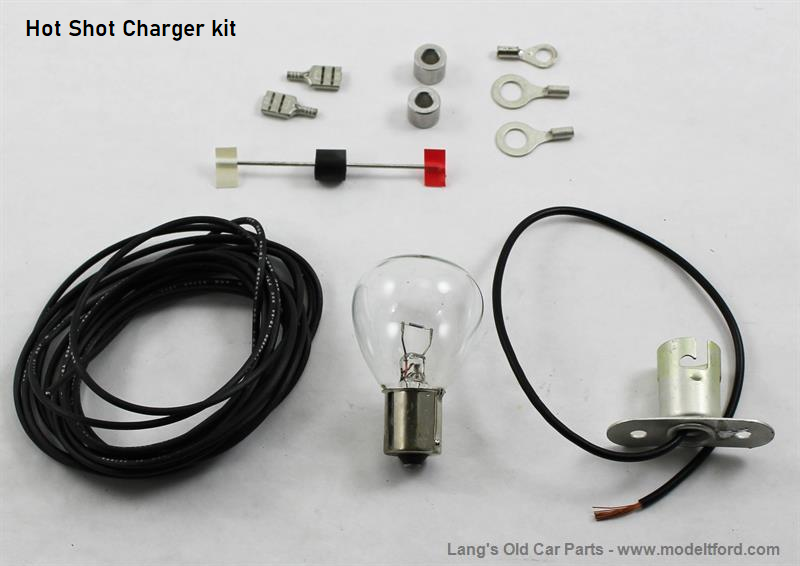

Hey guys - appreciate all your responses. Jim/Scott I agree with you and would honestly love to keep it running on the coils. The main reason I am considering adding the battery is because my uncle remodeled a 1915 and he said that his vision for the car was so all grandchildren could drive the car and that the battery option made things simpler (I understand that's debatable but seems to make sense for his situation). The local Model T chapter told him the best way to go was to add the battery. However, his already had the parts ready for a battery installation and mine does not (the battery holder under the rear seat and the front plate for the distributor). I would love to keep with the coils so if there is a way to keep the coils and run headlights and tail lights and keep things simple for posterity than lets do it!
Jim - I wanted to clarify what you said about sticking with magneto. So if I do run off coils then you are suggesting I install the battery holder under the rear seats and buy a hot shot kit such as:
https://www.modeltford.com/item/HOT-SHOT-C.aspx
Is there anything else I would need?? Would this be enough to run my headlights? Also is there a coil rebuilder anyone would recommend? I've seen the coil testers and would love to own one but they are so pricey - does anyone have a strong opinion about owning a tester vs not?

Does your magneto work? How much voltage @ speed? A good magneto will run the coils & charge a battery.(with a little magic)

Getting a T to run on a battery does not require a group 1 automotive battery under the floorboards. Other suggestions for a MUCH smaller battery which can easily fit under the seat or elsewhere will work fine and definitely aid in starting.

Here's the setup
by Steve Jelf » Tue Apr 13, 2021 12:15 pm
I use a small six volt battery strapped in the frame rail of my 1915 mostly to buzz the coils for starting. I use the stock mag headlights, but run tail lights off the battery which is charged by the magneto with a home made charger using John Regan's design. I've added a converter for 12 volts to charge my phone and Garmin. I plan to install LED turn signals, using the side lamps in front and a pair of T-era-looking tail lights in back. Maybe I'll even get fancy and add a brake light.
http://dauntlessgeezer.com/DG102.html Hi-Tech kit available to charge the battery from the magneto
- Posts: 7393
Re: 1916 Distributor and Battery Installation
I'm currently working on the tail/brake lights and turn signals. I'll post pictures when I get a little farther along.
