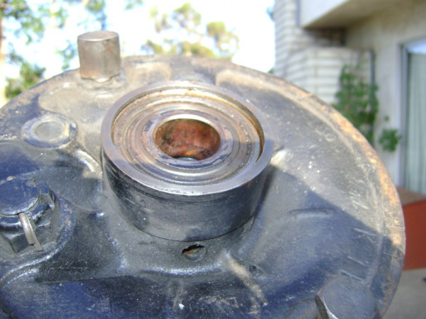

I am installing new axle shafts in a Ruckstell Axle. I have encountered a strange outer bearing. It has a lock ring just inside the hub at the outer end of the axle housing. There is an allen screw with a locking nut at the inner end of the bearing. I have removed both. I was also able to remove the axle housings from the axle shafts by using a puller and pushing the axle shafts inward. The bearings seem to be moving smoothly so I do not think they need to be replaced, however, I haven't found a way to remove them from the housing. I don't know whether there is an inner seal. The only reason I have disassembled this axle is because the keyway on the end of the axle is worn out and the wheel wobbles. Is there a way to remove the bearings from the housing? Would there be an inner seal to be replaced?

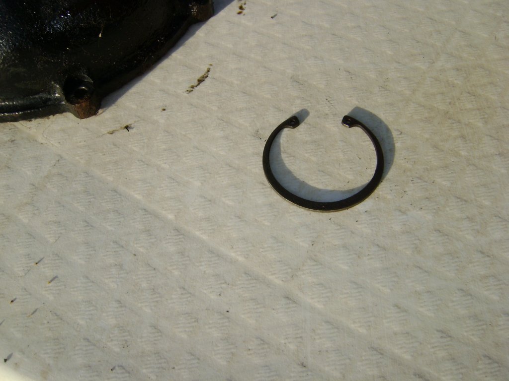

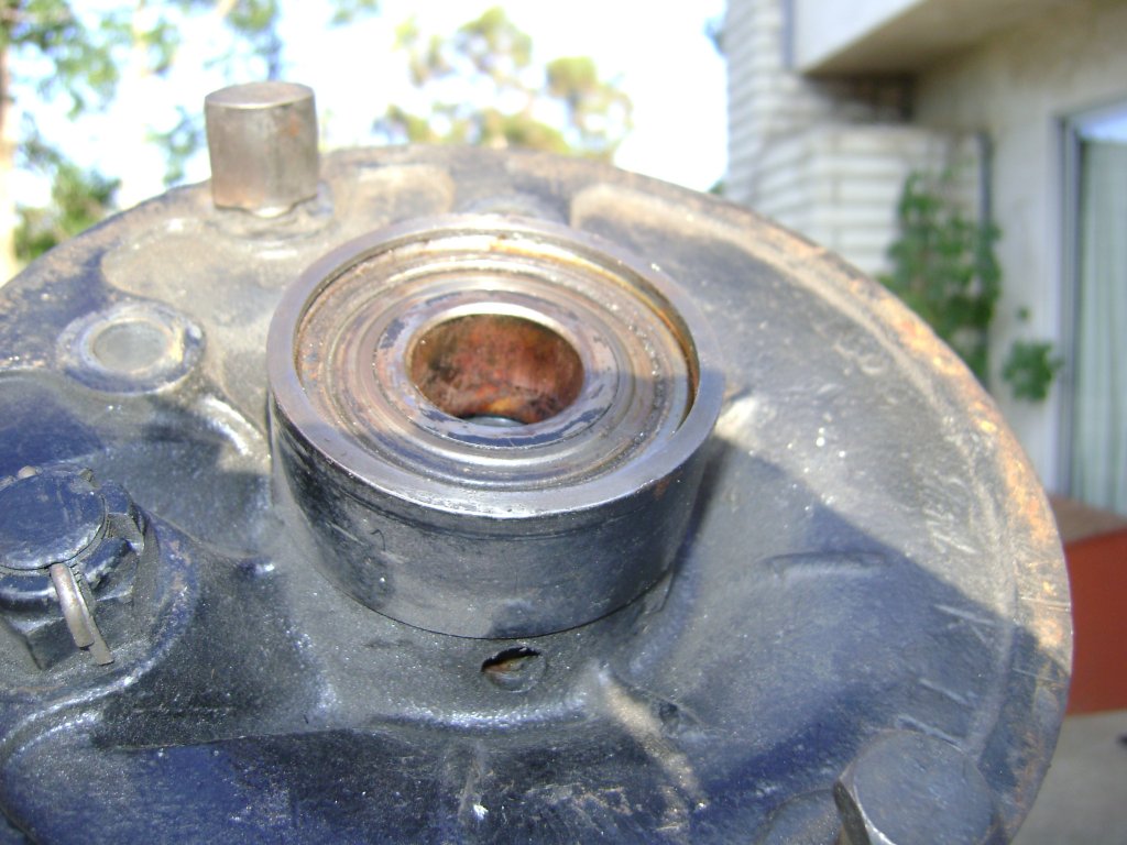

Topic author - Posts: 4694
Re: Outer axle bearing
Pictures of locations of Lock ring and set screw.
Are those the "free floating" hubs?
- Posts: 5138
Thats a ball bearing conversion/replacement. The snap ring keeps the bearing in the adapter sleeve. Unfortunately. the conversion butchers the housing. No turning back. That adapter sleeve should pull out once the set screw is removed. Pry up @ the edges.There are typically O-rings around that sleeve inside the housing.
Somebody's misplaced notion of an improvement over Hyatt bearings. I have seen a nasty axle break & fender damage from using these things. The outer bearing edge creates a shear point as opposed to Hyatt's spreading the load over the full length of the bearing.
Were it mine, I would be looking for a new pair of uncut axle housings
If you want to save the housings, you could install a set of safety hubs- a much better solution than what you have now.

The bearings turn smoothly without slop. We got them out and are going to install new o rings. I have several right hand standard housings, however the left side would need to be cut and riveted to fit with the Ruckstell housing. We have it almost back together again now. If the owner wants to replace the housings it up to him. At this time we just replaced the axle shafts with the brand new longer ones. Since his problem was with the wheel scraping the bolts and the brake shoes because he has rocky mountain hubs which hold the parking brake drums closer to the housing. At this time that is all we are planning to do and a couple hours tomorrow we should be finished. Thank all of you for your comments. We actually tried to push the axles in from the inside which pushed out the bearings so problem is solved.
