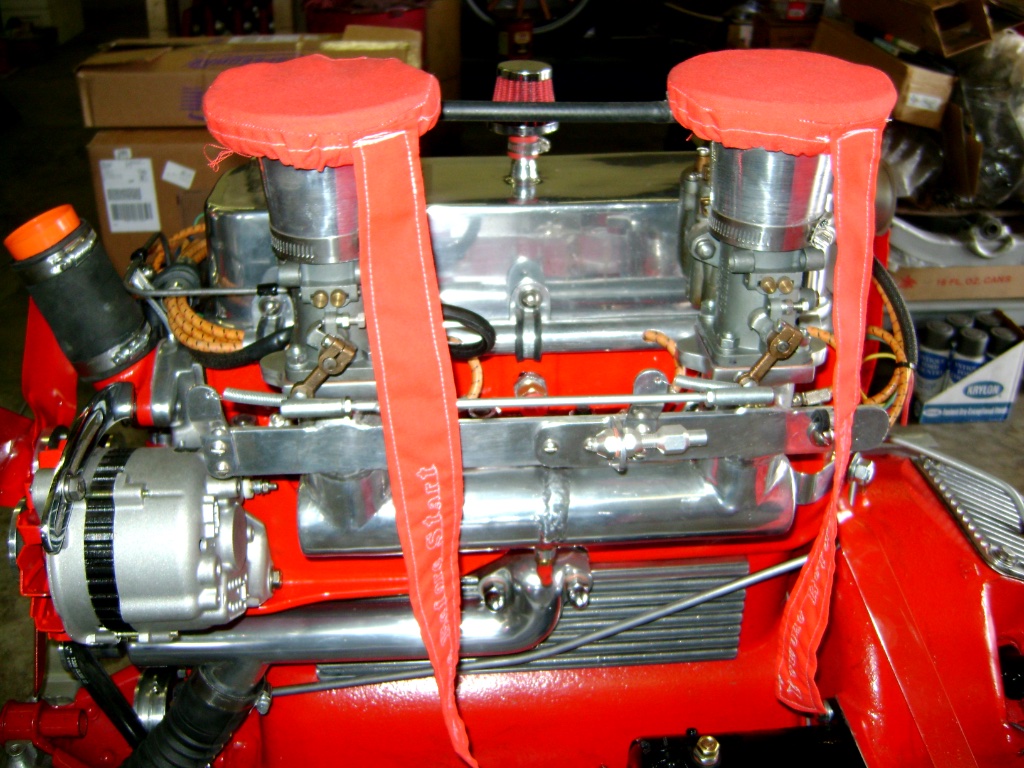

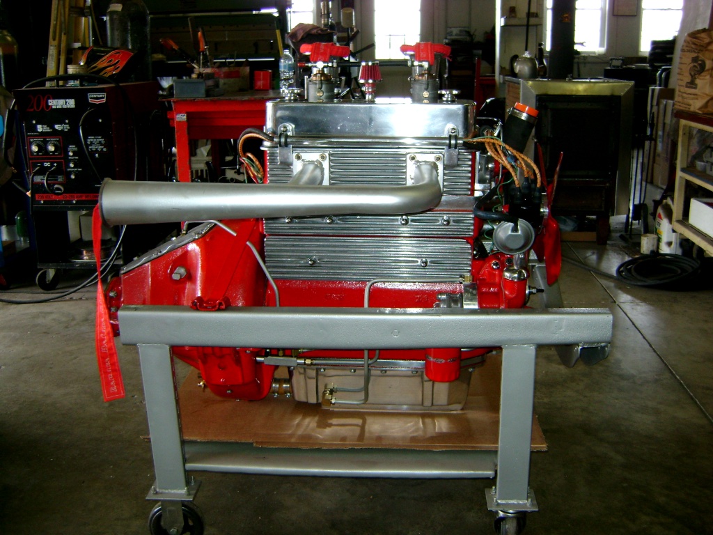

You might be surprised on how much power you can get out of one! Just Sayin'
Hank

Re: 4 CYL CHWVY ENGINE,
For those wanting pictures of a three port Olds head. They do produce just a little more but not what you would think. To get extra you must do a fly off of the rocker bosses and install a new plate with different ratio rocker arms. Now you have wheel barking power!
Hank

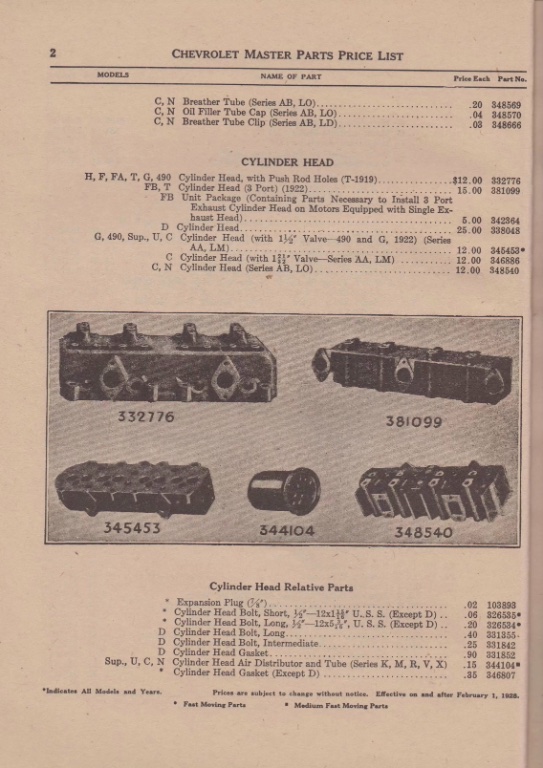

Not sure of rarity of the Olds head or cracks but I have a 3 port Chevy head and was told it was the same as an Olds head but with a bowtie casting mark, I’ve never had it sitting next to an Olds head so I can’t verify if they’re the same. The 1922 Chevy Master Parts Price List show the 3 port head in it. Not sure if the 3 port was offered in other years besides “22”.
Years ago I did see a Chevy engine in a Model T. It had the T trans with hogs head, so I know at least one person has done it. Don’t remember how it was mounted in the T oil pan.

I am very sure that the Chevrolet "T" was the truck, so wonder if in 1922 they tried that head to get a little more out of the engine, and the FB was a larger car, the follow-up to the to V8; https://en.wikipedia.org/wiki/Chevrolet_Series_FB So not as common as the 490.
