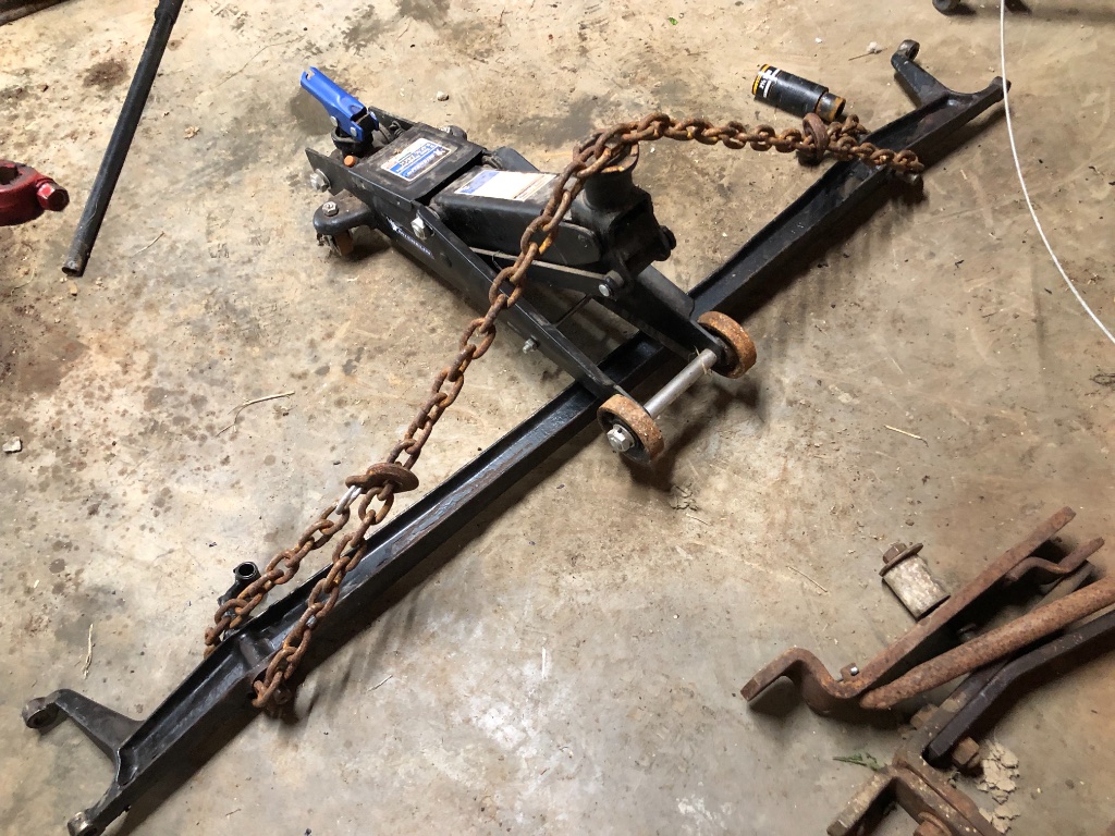

As Frank said, there’s only a front/back if the perches are installed. If they are, you’re usually better off leaving them be. They can be a real bear to get out and often get damaged in the process. If you don’t have access to a press, you can use a floor jack and chains. It’s not the safest method, but it works.

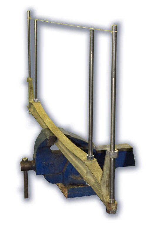

Some pics to align

Thanks for posting the photo above. Do you or anyone know if there are alignment pins available for purchase from a commercial source? I'd like to check several axles.
Have a great day,
Dom
Posts: 5474
Re: model t front axle
Post by RajoRacer » Sat Aug 14, 2021 11:23 am
I made mine from round stock, turned the ends to a point in the lathe & purchased lock collars from McMaster-Carr.

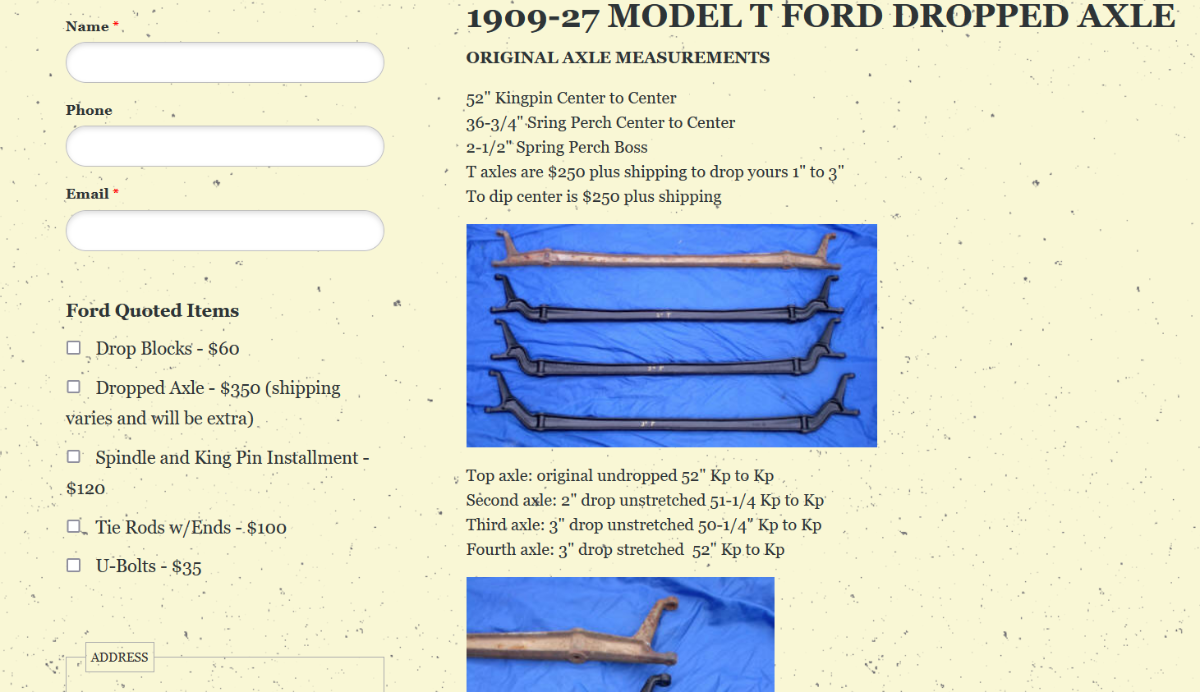

I don't know of any available. What condition is the rest of the axle in. Do the lower holes for the spindle bolts (kingpins) have good threads? If not look for a good used axle, no sense trying to fix it with too many issues. Since you have the perches out (the hardest part) consider the effort to get everything back to normal. Getting some rusty perches out of an axle can be a real challenge. You can get a reasonable idea of the axles straightness by using a string from the edge of one hole to the corresponding on on the other. The rods or dowels will show a twist in the axle that the pins don't reflect. There are plenty of good used axles around so consider the efforts - If your doing a speedster check into purchasing a dropped axle to lower the front end https://www.droppedaxles.com/ford-dropped-axles-0 You need to be carful in t he amount to allow for clearance around the tie rod and wishbone
