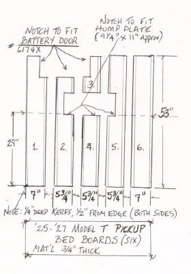

I couldn't find this by searching the old forum. Can someone please share the dimensions of the wood for the pickup bed on a 26 roadster pickup?
Thanks,
Gary
Thanks,
Gary
- Posts: 4042
Re: 26 Pickup bed wood
Sketch did some years ago from original bed wood.
gcomo

Thanks Dan.

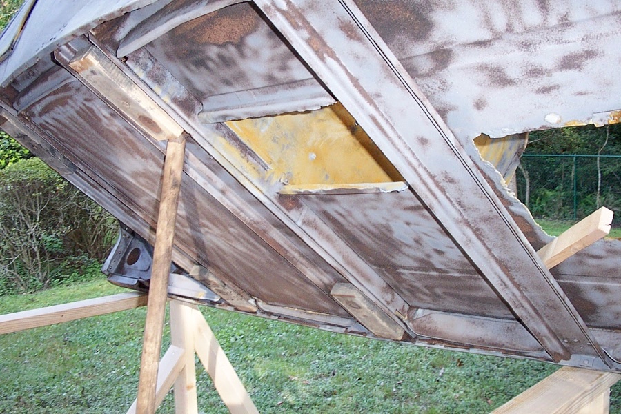

Does anyone have pictures to show how the battery cover fits? I have a replacement cover that a bit too wide to fit the indent in the headboard. I intend to trim about 1/4" off of each side of the cover where it is too wide. My question is, what holds that cover in place? Does anyone have any pictures?

The battery door (lid) lowers into the sheetmetal framing for that door that is part of the runabout rear deck. Same as the runabout with a turtle deck. The pickup bed replaces the turtle deck.
This photo shows underside of the rear deck, you can make out the frame edges bent into the sheetmetal for receiving the battery lid. Cutaway is the metal plate due to rust out, that plate covers the rear crossmember.
The pickup bed uses another plate held to the wood bed by rivets into a pair of the metal bed strips that fasten the wood boards. That plate covers up the hump plate of the rear deck sheetmetal.

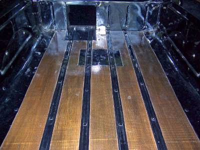

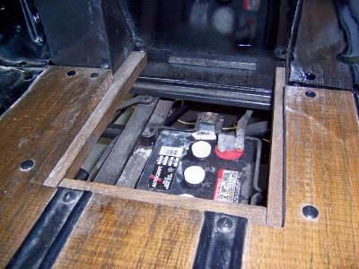

If the runabout rear deck metal is gone, then easy to add channel iron for holding the battery door, or wood pieces mounted under the bed board opening, fit the wood flush with the underside of the 3/4" thick boards, and the battery door lid will fit flush with the topside.
Finished look with battery door lid and hump plate installed.

Thanks for the pictures Dan. That's exactly what I'm planning to do.
