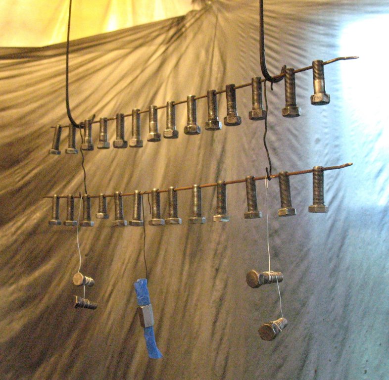

How is everyone painting their hardware (nuts and bolts)? I'm painting the car with all the fenders, running boards, hood and trunk off but what do I do with the hardware? just press them in a piece of cardboard and spray them when doing the car?

Close observation will reveal that some of these are original Ford bolts and some are modern bolts adapted for Model T use. Obviously adapting includes drilling for cotter pins, but there's more. I grind the modern markings off the heads and buff them smooth. Cad plating on modern hardware sheds paint, so I strip it off with a bath of muriatic acid. I'm very careful not to breathe any of the fumes. After a cold water rinse I prep with 50/50 phosphoric acid, which prevents rust and etches the metal to help paint stick. After wiping dry and thorough air drying I spray the hardware and other chassis parts with black satin Rustoleum. I dislike glossy chassis parts. Glossy is for body parts. I put the painted hardware in the oven and bake it overnight at about 180º. It's often a good idea to chase the threads on old hardware with taps and dies before use.
