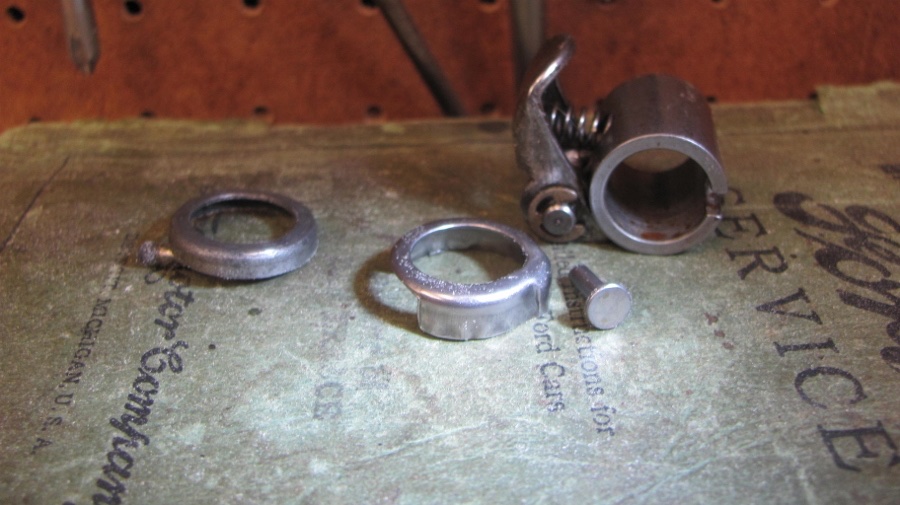

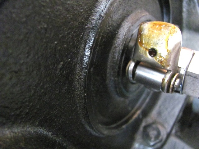

The Anderson flapper must use the Anderson washer, it has a cut-away to allow the flapper to move its full travel. And has a bump out for the retaining rivet. When installing, be sure to check the placement of that washer, if any interference in operation, find the cause and fix it. The nut should be able to be fully secured like any cam nuts.
Things to check may be the flapper is hitting the front cover or oil seal or cam end (shims are provided) , perhaps too the retaining washer needs some trimming or anything you can find in a good inspection. The flapper should be free to float up and down, crank over by hand and check around the perimeter too if needed, to be sure of rotational freedom of movement.
