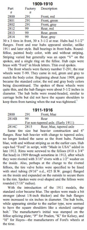

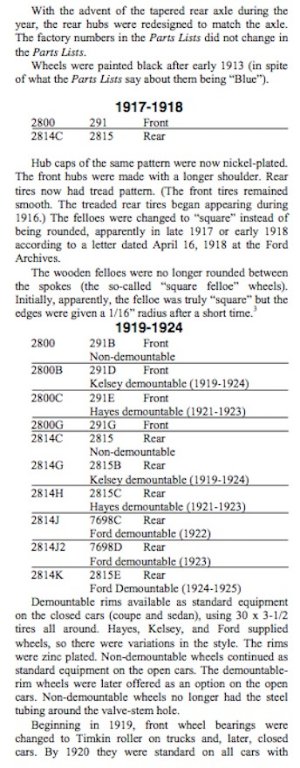

The advice you've received is a mixed bag. In 1920, steel fello non-demountables were introduced into parts lists: P/N 2800D for 30x3 and P/N 2814 for rear in 30x3 1/2 (metal fello) on Dec 1920. That said, I don't doubt for a moment that the earlier wheels would have been fit to a non-electric.
So, I suppose for the nit-pickers, you "must" locate a set of steel non-demountables to be deemed authentic, but I'd suspect that you'd be discarding the ORIGINAL wheels for "correct" wheels (which might take a bit of poking around to find!)
That said, putting 30x3 1/2 steel non-demountables all the way 'round would be absolutely incorrect.

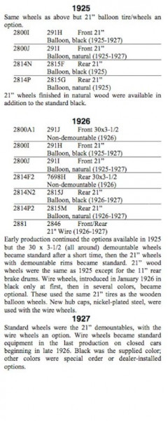

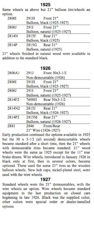

After having a bunch of wood fellow problems on my 14, I came across a few steel fellow non-demountable. I decided to go that way. In my limited research, I found where they were offered as REPLACEMENT wheels without hubs. October 1921 service bulletin. I was able to acquire a pair NOS back east. Never had hubs, really tight, original paint.
I have come across a very original 26-7 roadster locally. It was non electric, with kerosene side lights, dimmer transformer & 30 x 3 & 3.5 square wood fellow wheels. This & the fact you dont see hardly any of them confirms my conclusions to me.
I believe these non demountable wheels were only sold as replacement wheels, presumably for early T's & NEVER came from the factory on a new T.
I would be interested in evidence that shows otherwise. Any factory photo's out there showing non demountable steel fellow wheels?
T-2800-D Front. T-2814-D Rear
I believe your non electric T came with those wood fellow wheels.

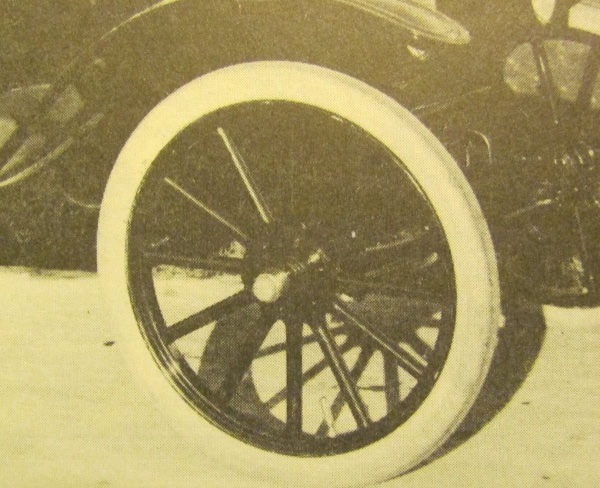

The square fellow 30 x 3" fronts likely persisted for the entire time, for those wanting the lowest-priced car, non-electric, non-demountable.
Here is a later T with the all metal clincher rims, the fronts are 30 x 3". Don't think Ford ever offered these all metal clincher for the front in 30 x 3 1/2".
Am having a set of these in 30 x 3" being re-spoked by Calimers, and the spokes for the 30 x 3" are a some what semi-oval, lighter looking than the rear spokes of the same all metal rim in 30 x 3 1/2". Those rear are just like any of the spokes used on 30 x 3 1/2" wheels, but the tenon shape is different as they are retained within the hollow section of the rim, so not exposed in the tire casing part of the clincher.

- Posts: 5138
Re: What wheels on a non electric 23
This photo makes me ask 2 questions +. 1) what year was it taken? 2) Why no kerosene side lights? Didnt all non electric T's have them?
Could this T have replacement wheels? Could the owner have bought the cheaper replacement wheels over demountable wheels?
Very interesting picture.

- Posts: 4045
Probably a electric start '20 or '21 before the green visor lens. Demountable were extra cost, even with the electric system equipped Ford, so this one got standard non-demountable. These all metal felloe were likely popular when they came out.speedytinc wrote: ↑Mon Sep 06, 2021 7:19 pmThis photo makes me ask 2 questions +. 1) what year was it taken? 2) Why no kerosene side lights? Didnt all non electric T's have them?

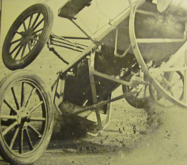

Here is another with metal felloe and no side lamps. Think this racer is also fitted with these, as the guys then figured the all metal felloe was better to take a chance with
- Posts: 4383
Just to clarify. The electrics option and the multiple wheel options were two separate options. They were not bundled together. Open cars could be purchased new with neither, either, or both options. Most buyers originally probably did buy both the electrics option and one of the demountable wheels options. However, so many photographs clearly show Ts new enough to have had the options available but not having them, that we must accept that they were more than a rarity. Cars without the electrics package but with the demountable wheels are unusual. I have noticed more than a few era photos that way over the years, but not a lot of them. Cars with the electrics package but having non-demountable wheels on the other hand were quite common!
As I have commented many times before, it would seem that the inconvenience of hand cranking the car every day was more of a concern than the inconvenience of the occasional roadside repair of a flat tire.
Dan T, Interesting photo of the auto-polo T! Not only does it appear to be a live action shot (notice the amount of dirt flying around!), the steel felloe non-demountable wheel is a bit of a surprise considering how many of the auto-polo cars were old brass era Ts. Don't know if that photo was cropped? Or taken that way, but it doesn't show enough of the car to tell the vintage of it. The upside-down car does appear to be a brass era, at least the radiator.
I have looked through a few hundred photos on my computer, found lots of pictures of square wood felloe wheels on earlier Ts (1918 to 1921). Then today, while looking for something else, I found a good photo in the "Old Photos" section of the Forum's gallery.
