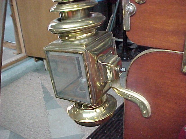

I am preparing to replace the firewall on my 19100. The car has an older restoration and the side lamp brackets used were not the correct ones. I now have the correct ones but the holes in the firewall do not match the correct brackets. Does anyone have the correct measurement of the placement of the side lamp brackets for a 1910? I have attached a photo of the incorrect bracket on the firewall. Thank you!

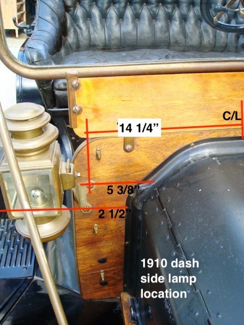

OK John; here ya go, from the Ford drawing: Both holes are 5/16" diameter. The center of the upper hole is located 14-1/4" from the centerline of the dash, and 5-3/8" down from the top edge (no molding). The center of the lower hole is 2-1/2" below the center of the upper hole, and 17/32" outboard of it. Hope this helps.

Post by DanTreace » Mon Sep 06, 2021 6:49 pm
That's great R.V.!
So added those key dimensions to photo of an original 1910 to show relationship of the bracket on the dash.
Revised with 14 1/4" from center line.

Nice photo Dan, but I think your 14-1/2" should be 14-1/4".
