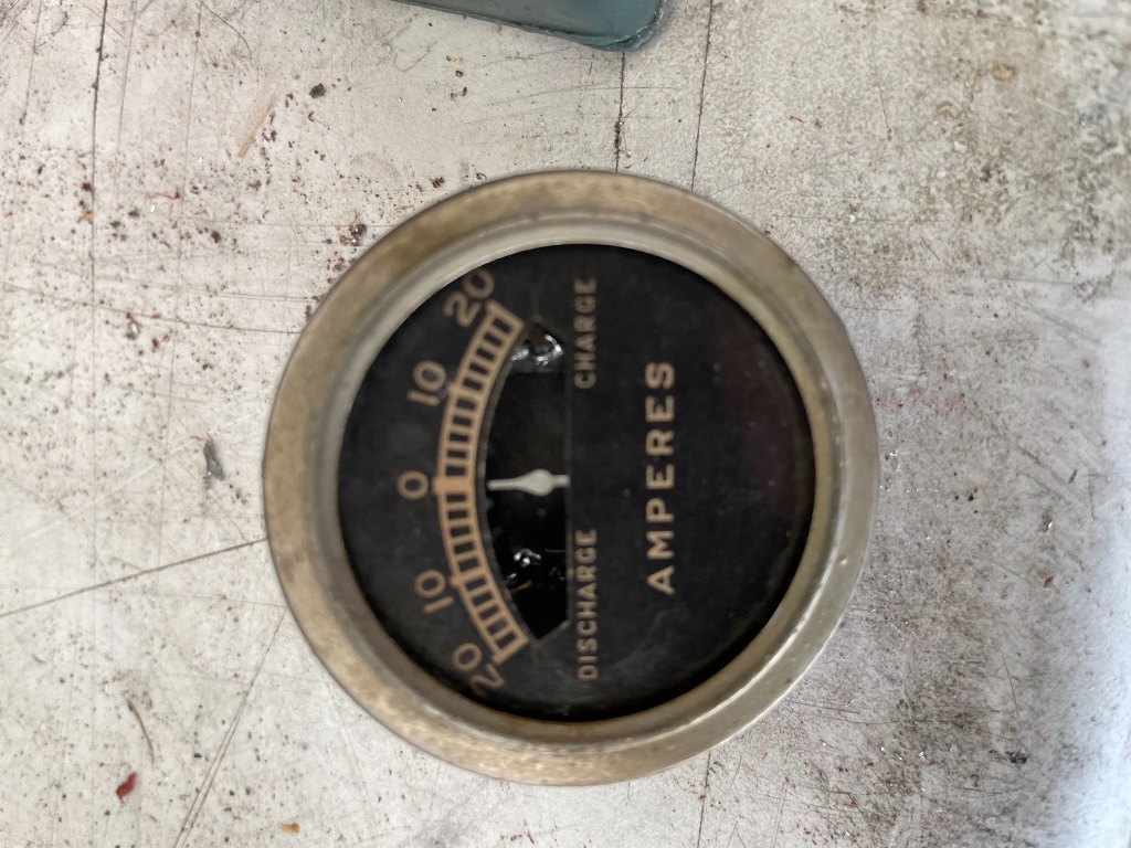

So are all the Amperes Meters at -1 Amp when the ending is off and Bat disconnected? Or just at the swap meet. Seems like they all look like this:
My concern is when I set the third brush. Are you supposed to compensate for that one amp? Or do you just go off what it reads as you make your adjustment?
The car is all stock except I will be using a Voltage regulator from the old Fun Projects company that I was able to buy.

I have never seen one which looked like that one. The pivot point looks like it is not lined up with the dial, however, it still points near zero! Anyway, whatever it reads with everything disconnected is zero amps. If you are concerned about the accuracy, connect an analog ammeter in series with the wire from the generator and adjust it according to that meter. Then with the engine off, remove the meter and re connect the wiring. I have never used a voltage regulator, but I would think it would automatically adjust the current as needed.

Original late ammeters are always off/inaccurate. Repros just amplify that.
Followfollowfollow the FunProjects instructions!!! It was bad enough years ago to smoke one by being careless or knowing more than the designer, but now it would be a crying shame to smoke one as replacements are so scarce.
Start with a standard cut-out on the generator, and use "wherever the needle sits" when everything is "off" for your "zero". Don't ignore the offset of the needle. Set your output to 3-4A. That's plenty. If you can't achieve that, then reset the null in the generator, as well as output as detailed here: https://modeltfordfix.com/adjusting-the ... patterson/

Maybe that the issue. The pivot point might be off.

I don’t believe those were ever made to be that accurate as drivers don’t pay much attention to them. You start the car and the needle moves until the battery is charged. You turn on the lights and the needle moves etc. They are just basic indicators of charging or discharging. I would never use one to set the generator brushes.

Thanks for all the input. I'll use where it sits as the zero.

They aren't very accurate, and many have been dropped or subjected to a heavy discharge by a short circuit. That can bend the movement and cause more inaccuracy, which often shows up as a failure of the needle to find center when everything is off. Back in the day, Ford mechanics were advised to use an accurate "master ammeter" to set charging rates and do electrical system diagnosis.

In just taking a look at the first pic and not making any comment about the accuracy or use of an amp meter the amp meter in question does look like the needle is not lined up at the pivot point.
In other words the face is either off center or the pivot point is off center.
Maybe it’s because the picture of the meter was taken at a slight angle and not directly straight at it.

It's a chrome plated repop, of dubious quality. If you look closely the 20 on the discharge side is well under the rim of the meter while the 20 charge side sits nicely within the bezel. This shows the face is well off centre, to the discharge side, and still the needle points further to the left. Use it as an indicator rather than an accurate meter.

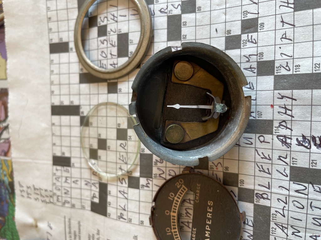

Mopar_man, it looks like the meter face (thin cardboard on my 1925) is improperly indexed on the meter housing, and someone reindexed the meter in the mount to compensate. If you’re careful you can open up the meter and properly index the face. The cardboard face is indexed to a steel ring which in turn is indexed to the housing. The glass lays against the face, and the plated trim ting holds it all together. (Sorry for the sideways photos, but the forum won’t accept portraits.)
(As far as testing the meter, any DC source incapable of delivering more than 20 amps can’t hurt the meter; that’s what it’s designed to carry. I just repaired an internal open circuit in mine, then tested it with an AA battery and got results close to what GridLeak said in the previous post.)

Thanks again everyone. For now I used the place of the needle as my zero and adjusted it from there. I may try to play with the meter face in the future.

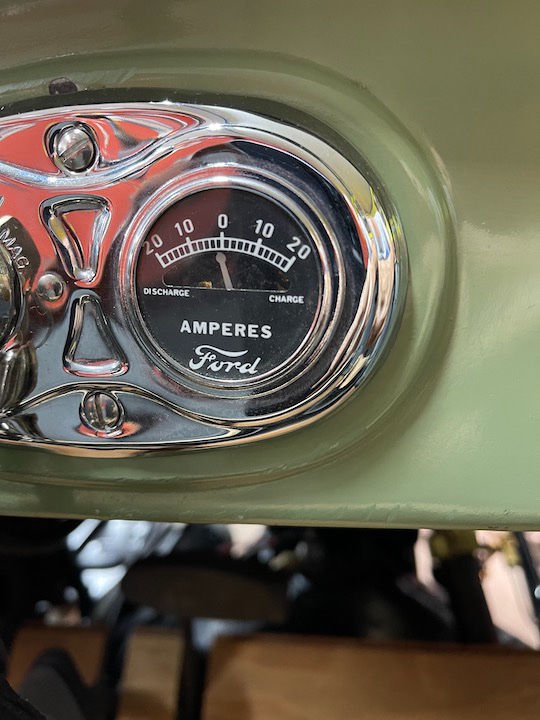

Properly assembled & working ammeters point to zero when the engine is off and the battery is disconnected. Some older ones may have the pointer off center from bending or face plate misalignment. Your ammeter is a repro, suspect the switch is too, in any case it may be that the ammeter was not assembled properly. The bezel can be removed, some tabs bent in, then rotate the face plate so the pointer is at 0. If that doesn't work, discard it and get another one. Repro's about $13 + shipping. Also the same with out FORD script at local Auto or Farm Parts supplier 20-20 range is correct 30-30 works too

As usually the case you guys are right my meter is canted. It's way too shiny to be an original. Same with the switch.

Mine wasn't at 0. I took it apart and bent the needle until it was at 0 and it is working fine.

Adjusting the movement to show 0 when appropriate is probably good enough. The stock meters were not very accurate, the electrical system is not the most stable, and the dial face, pointer, and movement of the meters is not designed for accuracy. I doubt if a typical dashboard ammeter would hold accuracy very well in service, even if you could get it to read accurately. Ford recommended use of a master ammeter to make generator adjustments in Ford service shops, citing the unreliability of the dashboard units.

I dont mess with a stock ammeter for fear of damaging & needing the far inferior repops. If a stock meter shows 1 amp @0, thats my zero reference. @ 5 amps charge(actual) it shows 6. Dont matter. I generally check the system with a modern analog meter to see if the readings are close enough. I set the gen output to 0 or slightly negative with the lights on. I would not expect a crappy repop to read accurately or on old original to be accurate either.
In this case, I agree with turning the off face to show 0. Nothing to loose. Untill you test it independently, dont count on the readings to be accurate.

The pictured ammeter is a very cheap reproduction that is sold for cheap. It is not exactly the type used during 1926 and 1927 and is generally referred to as the "SMALL METER" but the Ford original meter of the same typical size was a better meter. The off center tilt to the needle is common for that cheap repo item. The original larger meters made by Ford were more accurate although some of them "bounce" a bit while you are driving and some makers of the Ford "Large" meter (arrives in 1919 model T's) were better than others that Ford got their meters from. Hoyte meters were better and lasted longer. The ones I got involved with were more accurate than Ford's original versions but that is simply because the technology improved in later years and the movements can be very stable and very accurate (typical 5% of full scale). The small meter just doesn't work very well and Ford never chrome plated any of their meter bezels. Original small maters had a rim that was flat and nickel plated. They were better quality by a mile than current reproduction small meters. You get what you pay for I guess.
