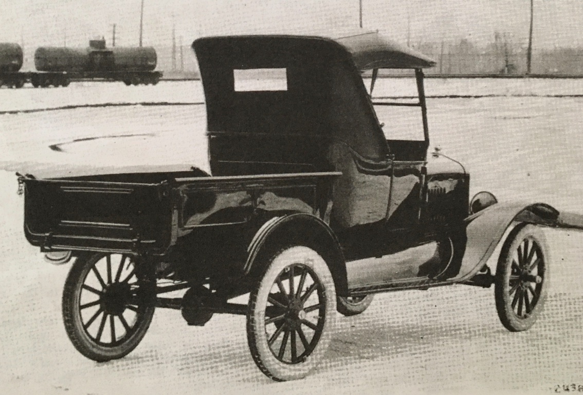

Where on the factory ‘25 Pickup beds would I find the Ford stamping in the metal?
I would think somewhere on the mounting brackets?
I have an early bed(without Ford script embossed on the tailgate)it’s very nice with about 65% original paint and the rest light to medium surface rust.
I would like to gently clean the area of stamping so I don’t obliterate it!
My goal is to replicate the very first Ford pickup so I’m looking for a ‘24-early ‘25 runabout that the front fenders are embossed running outside of the splash apron, straight rear fenders, and Kelsey demountable rims.

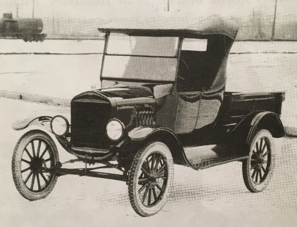

The above are the factory photos dated Dec 12,1924 and there is another set dated Feb 28,1925 showing the same box lacking the Ford embossment on the tailgate. (Ref: Bruce McCalley’s book “Model T Ford”).
The 1925 boxes were only made for 4 months before the change over to ‘26-‘27, if I understand correctly by Bruce’s book, the very early boxes didn’t have the Ford script on the tailgate.
But by then Ford was stamping parts-so it should be on there somewhere.

On the very first photo posted, the rear mudguards are standard, curved in rear fenders. There is no need for straight Hack style fenders with the factory pick-up bed.
Or have I mis-interpreted your "straight fenders'" ?
