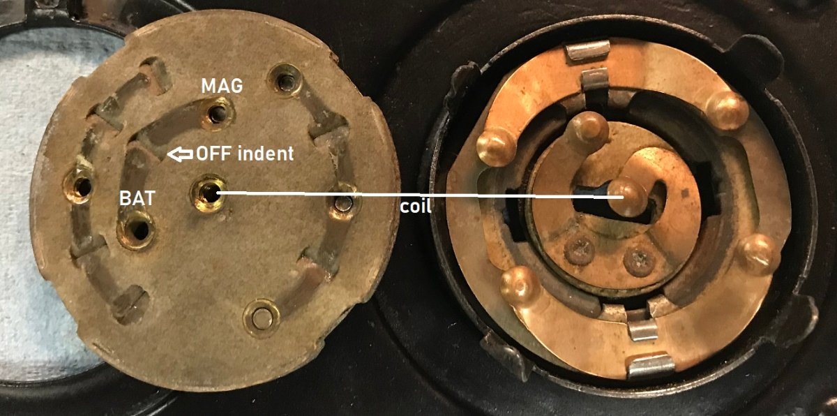

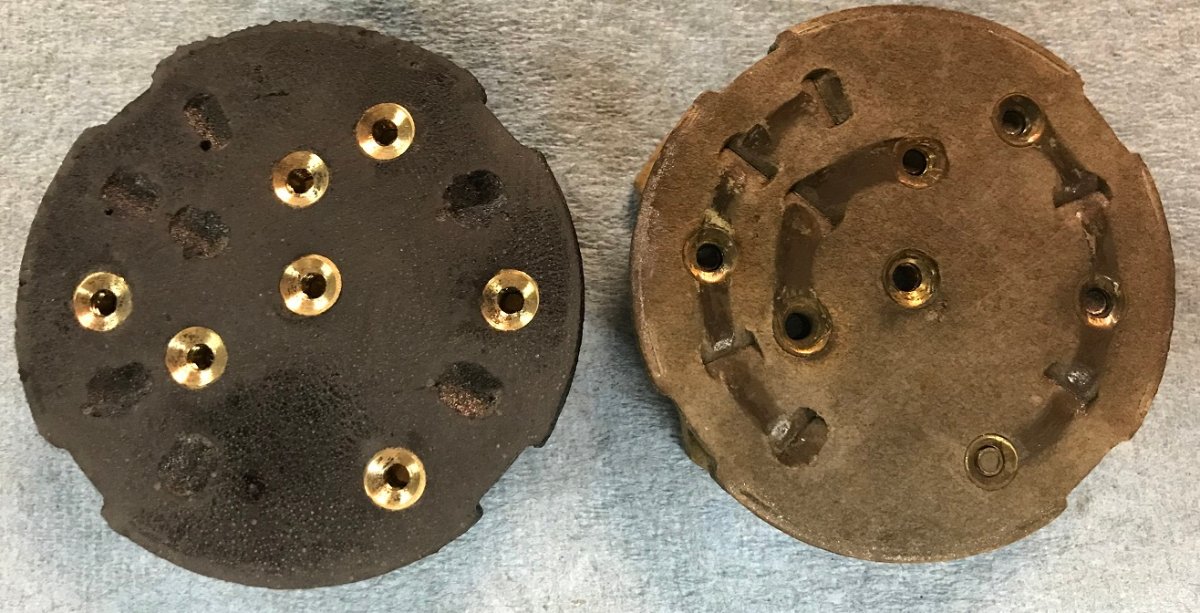

Your switch looks like this one with the clips...even though the one below it is a 26-27 switch, all plate switches work exactly the same and are wired the same too (with the exception of that green ground wire, that's not really on any of them).
Sometimes your magneto doesn't work because you over shoot when switching to it, this is usually because the detentes in the switch wire plate are not deep enough to hold your switch lever from going past the magneto contacts (the detentes are the holes without the contacts in them). This happens because over time they get worn almost smooth, so drilling them a might deeper may fix this problem, at least that's what I did to mine to fix that problem.
