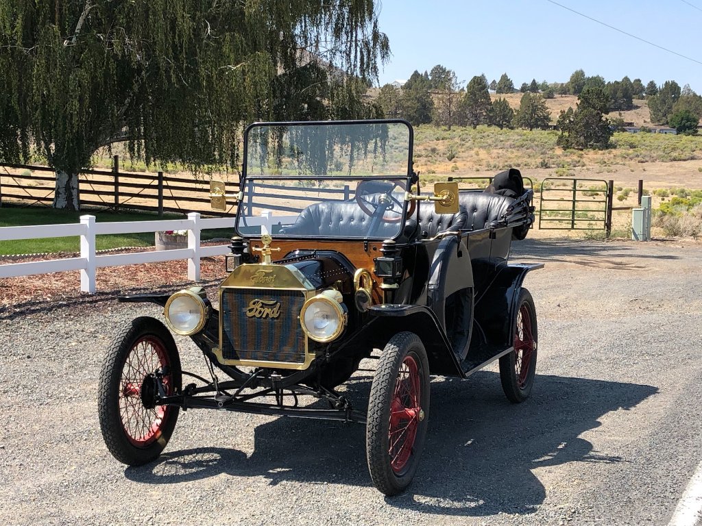

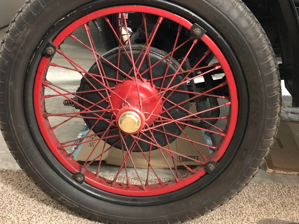

Some years ago a Model T pal recommended using the balance beads on the '23 Runabout. That car has had a long history of mechanical mayhem and it ended up getting new everything from the radiator to & including the back axle over a 15 year period. With the constant mechanical work needed I forgot about the balance beads.
I have another project now, the '14 Touring. It runs & drives but needs things as it is an older restoration that has been sitting for some time. The last owner did fit a set on new Riverside tires with new rubber stem tubes to the demountable rims on the Hayes wire wheels. For the most part, this is a great driving car, it runs smoothly and it very comfortable to drive. Its going to be a great tour car once some of the issues are sorted.
There are times however, that when there is a vibration that comes & goes. The steering wheel & column shake. We have pretty smooth roads in this area and the shaking does not seem to be dependant on the road surface. I'm wondering if possibly the 30 x 3 1/2 tires might be way out of balance and get into phases where they combine to make a real shaking.
I'm thinking of using the balance beads bought for the '23 to see if the '14 might be better for them. Has anyone used these beads? Any comments on installation and use?
Paul
Paul

I don't know that everything is perfectly tight but the car steers very well, much better than the Runabout. There is no shimmy. This is a shaking that is felt strongly on the steering wheel. The column shakes and the whole car shakes too. When its in one of its phases, the mirrors are useless. I have run the car several hundred miles since December in drives lasting up to two hours.
At first I was concerned about radial runout being a problem but there are times when it drives pretty smoothly so that doesn't seem likely.
Paul
Paul

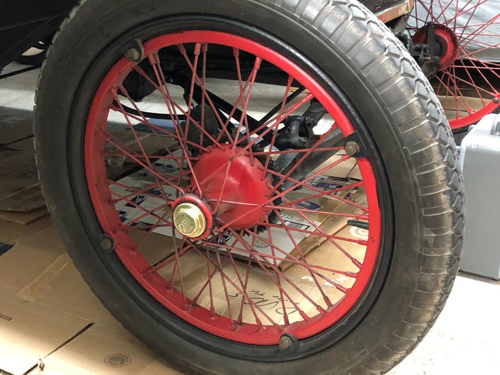

I had a poke around the '14 this Saturday to see if I could find some items in the steering system that might need attention. I started with the steering bracket. While it has no movement with respect to the frame, there is quite a bit of slop in the lower bushing. Moving on to the kingpins, the left top is also pretty loose. I could not feel any slop in the bearing. On the right side I found some minor movement but could not see where it was. I laughed when I saw the slop in the drag link on both ends! I did not inspect the tie rod ends, I'll get to them when doing the rest of the steering.
I jacked up the front wheels and spun them to check for wobble & radial runout. There was not too much wobble by Model T standards but the left wheel seemed to have a lot of runout not connected with the flat spot from sitting a week. This will need more careful inspection after the next run.
The work list on this car just got longer. The real question in my mind is why the car steers as well as it does. Will any of this make the car shake? I dunno, but it sure can't help.
The steering bracket needs to be rebushed and I read someplace that it needed machine work. What is involved in getting this done?
Are kingpins something the home mechanic can do with basic tools or is this specialist work?
