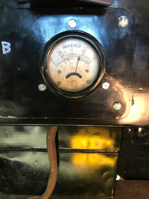

Have you calibrated or compared your dash ammeter to a more accurate one?

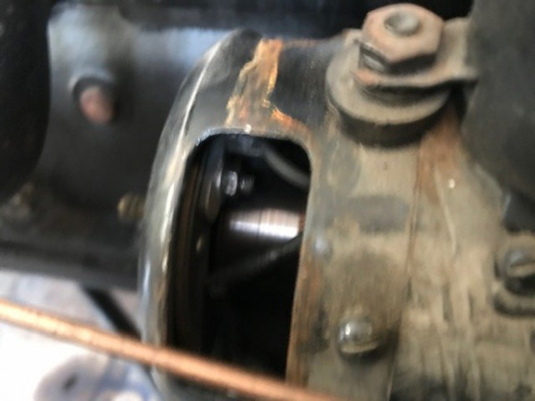

well I had a chance to work on the T today and attempted to adjust the generator with the Ron Patterson method as he suggested. With car switched off the battery was at about 6.5V. I backed off the 3rd brush (opposite direction of rotation) and loosened the four screws holding the brush plate. With the engine running above idle I moved it back and forth while watching the Ammeter with a mirror. I never got it to go below 10A. Then I did the same thing with a volt meter (both digital and analog) and never went below 9V. Checked at the battery - 9V. I'm stumped. Moving the brush holder has no discernable effect that I can see. What am I doing wrong?

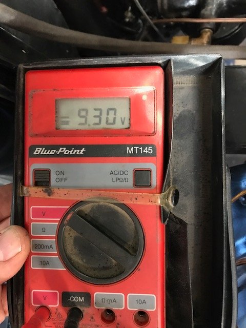

Are you getting that reading @ the battery posts directly. The battery regulates the voltage it will take. Are you testing @ a possibly bad battery connection?JamesD wrote: ↑Sun Sep 19, 2021 8:54 pmwell I had a chance to work on the T today and attempted to adjust the generator with the Ron Patterson method as he suggested. With car switched off the battery was at about 6.5V. I backed off the 3rd brush (opposite direction of rotation) and loosened the four screws holding the brush plate. With the engine running above idle I moved it back and forth while watching the Ammeter with a mirror. I never got it to go below 10A. Then I did the same thing with a volt meter (both digital and analog) and never went below 9V. Checked at the battery - 9V. I'm stumped. Moving the brush holder has no discernable effect that I can see. What am I doing wrong?
I dont know of a digital meter that reads correctly on a T. Even a Fluke meter. A 9V reading aint right. Get that figured out & retry the brush holder adjustment. If you cant get the output amps right, try removing generator & adjusting per the bench test lifted 3rd brush & gear rotation setting.

I tested the voltage at the generator post (both sides of the cutout) with an analog meter. I just tested at the battery to make sure I was getting similar voltage there in case there was some connection issue. It reads 9V with analog or digital meter.

Kerry, I did miss the part about "solid state". If you are not testing in the lathe with a voltage regulator, then I can see where the generator matches the battery. The reality of it is, is that a 6V mechanical cut out (of which I was speaking) only closes at 7.2 (or so) volts, so the battery most certainly is seeing greater than 6VDC. If on the other hand you are using a diode, then the generator will not measurably exceed the battery voltage to the extent that it is easily discernible with a voltmeter. I suspect you use a diode for testing.
Thinking more about the 9+ volts, makes me realize that reading is taken with a DVM with the engine running. You absolutely cannot trust a DVM to work accurately in the presence of a standard "T" ignition system...the 13A on the ammeter on the other hand, I do believe.

Today I started the car, no chrging at all. First I checked the wiring at my switch. All OK. Checked the wiring between the generator and the terminal block to the ammeter - OK. Checked the wire from the battery to the ammeter - OK. I pulled the generator and set the Null point. It ran like a motor with the third brush pulled up and not contacting so I set it so it wouldn't run either way. reinstalled it with the third brush at the most retarded point. Started the car. no voltage. moved the third brush and I could hear it loading up. checked the voltage: 9.5V. moved the brush back to the most retarded position: 9V. Then my Ammeter stopped working. Doesn't move either way when I start the car, or when I turn on the headlights. $%$&%$#@!!!!! Now I can't even see what kind of Amps it's putting out. Guess I'll go to bed and try again another day.

The voltage measured at the generator will always be higher than at the battery because of the wiring resistance, plus a small voltage drop across the cutout. What ultimately counts is the voltage at the battery terminals, which should be about 7V on charge.
If the voltage at the actual battery posts is much higher than 7V with a few amps of charge, the battery is likely to have a defective cell.
Assuming you do have 7V at the battery, 2V drop between the generator and battery is a bit high and I'd be suspicious of the wiring and connections; particularly the connections at the ammeter, especially if it's a repro one with the plastic nuts.

Your symptom of no charge, moving the 3rd brush, finding a point that charges is a classic sign of a bad insulator behind the 3rd brush carriage bolt. It will need to come apart to replace the insulators. This the most common problem with a T generator.JamesD wrote: ↑Tue Sep 21, 2021 11:05 pmToday I started the car, no chrging at all. First I checked the wiring at my switch. All OK. Checked the wiring between the generator and the terminal block to the ammeter - OK. Checked the wire from the battery to the ammeter - OK. I pulled the generator and set the Null point. It ran like a motor with the third brush pulled up and not contacting so I set it so it wouldn't run either way. reinstalled it with the third brush at the most retarded point. Started the car. no voltage. moved the third brush and I could hear it loading up. checked the voltage: 9.5V. moved the brush back to the most retarded position: 9V. Then my Ammeter stopped working. Doesn't move either way when I start the car, or when I turn on the headlights. $%$&%$#@!!!!! Now I can't even see what kind of Amps it's putting out. Guess I'll go to bed and try again another day.![]()
You could use a separate, modern ammeter to more accurately read actual output. The in car unit was good for reference of activity. The high voltage reading is still telling me there is no battery connection(open) or possibly an internal battery problem. Keep picking @ it.
