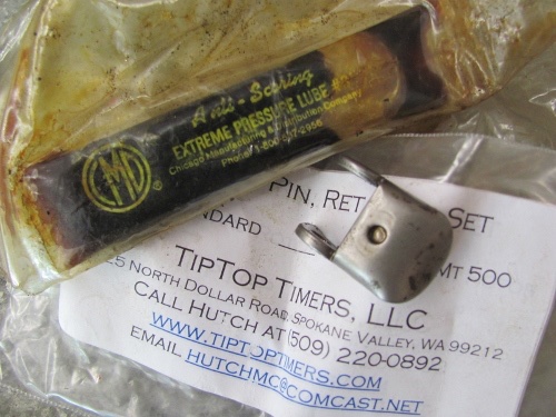

Tip top timers sells some that is actually supposed to extend the life of a New Day.

I don't think Hutch recommends that Extreme Pressure Lube for the New Day. The New Day runs better without any oil, vasoline or heavy grease. The flapper face of an Anderson can benefit from that lube.
The wear of the brush against the harder bronze contacts will be normal, the brush can't last forever :)
Just remove the timer cup and clean it out from time to time to remove dust from the brush wear. Any lube will mix with the wear 'dust' and make a compound that could cause contact issues and result in a miss.

Regarding the "lube" from Tip Top Timers I probably shouldn't have spoken as my information was second hand. A friend recently bought a New Day from Tip Top and told me about it. Supposedly a one time application that makes the "plastic" part of the housing wear better. What it is I have no idea so unless someone has more info please consider my comments deleted. FWIW - I have never lubed my New Day. It has 4500 + miles on it and I have cleaned it maybe four times. When cleaning I run a 2.5 inch disc with some fine sandpaper attached over the surface using an electric drill and then blow the dust out. A quick wipe with a rag dipped in Lacquer thinner and I'm done.

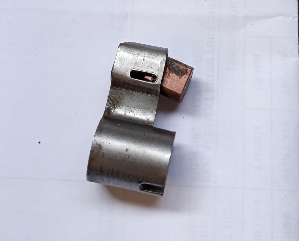

Here's my "beef" about the "new New Day"...this flimsy brush...had to open it up every 200 miles due to poor performance on my Fordor and clean and sand the inside of the timer. Got fed up and found a TW timer and no problems since. Luckily I have enough spare brushes for my TW's for a while. RIP Tony, you had a great product!

Post by Original Smith » Wed Sep 15, 2021 12:08 pm
I don't believe the brush pictured above is a genuine New Day brush. The brush for an original is not that wide.
Convert this brush to carbon. Timer wear problem gone.

Post by John kuehn » Wed Sep 15, 2021 3:47 pm
The brush shown in the picture doesn’t look like an original brush. The originals I have have a slightly smaller brush end. The worn out ones I have the brushes aren’t cocked but very little. I don’t know if that would make a difference but to much brush movement would seem to wear more and be erratic.

Post by Original Smith » Thu Sep 16, 2021 11:53 pm
I have several NORS New Day timers in the original boxes. The one pictured above is not original.

Post by Tom_Carnegie » Fri Sep 17, 2021 12:17 am
For the record, the brush pictured in Tim Wrenn's post is NOT a brush supplied with the Tip Top Timer New Day that is now in production.

Post by Original Smith » Sat Sep 18, 2021 10:16 am
I have a tube pictured above that Tom sells. It is intended for the Anderson style timers.
I think the flapper and roller timers require lubrication.
